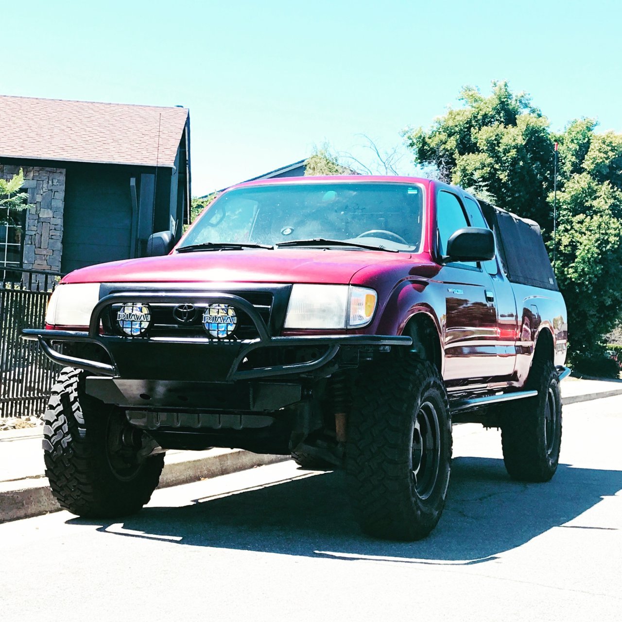

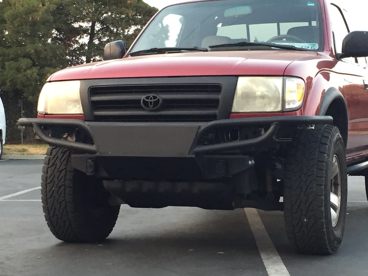

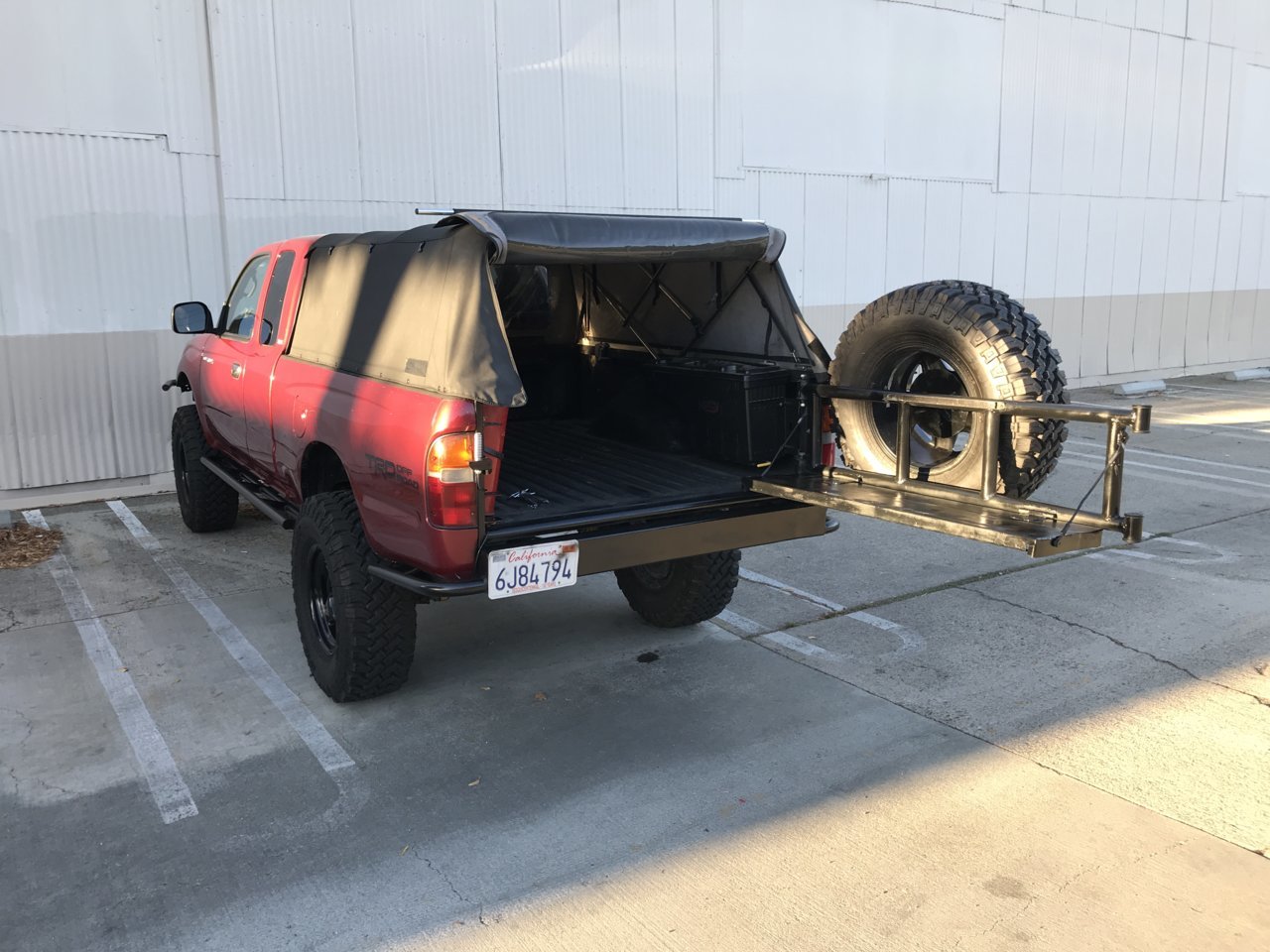

    Cleaned up the front bumper a bit, cut a few inches out of the frame horns and closed up the holes in the mounting bracket.
    ^before you can see the frame horns coming through the mount
    Now after nice flat surface ready for some recovery points
    Reinforce the rear bumper, I used the stock exhaust hanger location for the mounts so everything is still bolt on.

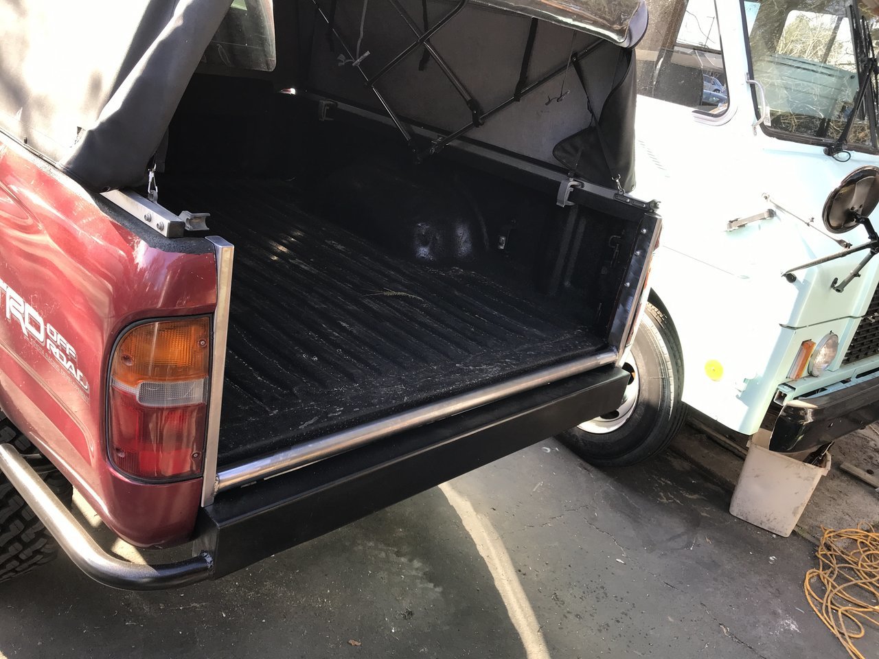

    Framing the tailgate, just waiting on some bushings0F0678BD-94B5-44FE-8F8D-11887F865CC7.jpg

    Is that hinged on both sides or something? Can't figure it out
  5. Mar 10, 2018 at 8:51 PM
    #105
    Speedytech7
    Feb 20, 2014
    #123587
    58,386
    FCQM+VG Cheney, Washington
    It's less Tacoma and more mod
    Sure looks like you could just undo whatever side is most convenient. I like it
    Fuergrissa[OP] likes this.
  6. Mar 10, 2018 at 9:11 PM
    #106
    lukester78
    lukester78 Well-Known Member
    Nov 3, 2016
    #201425
    885
    Luke
    97 Tacoma Single Cab 4x4
    Yeah that's about what I was thinking. It's pretty cool
  7. Mar 10, 2018 at 9:16 PM
    #107
    Fuergrissa
    Fuergrissa [OP] If you build it, trails will come.
    Jan 9, 2013
    #94858
    2,125
    Devin
    San Jose
    2000 T4R Limited
    @lukester78 @Speedytech7 you can undo either side, but I plan on using the passenger side as the pivot side. plan on adding jerry cans in the near future.
  8. Mar 10, 2018 at 9:24 PM
    #108
    lukester78
    Nov 3, 2016
    #201425
    885
    Luke
    Plans for a quick release on drivers side then?
  9. Mar 10, 2018 at 9:34 PM
    #109
    Fuergrissa
    Jan 9, 2013
    #94858
    2,125
    Devin
    San Jose
    2000 T4R Limited
    For now pins will do, end game is to have it enclose the bed like a normal tail gate. Maybe I’ll make the solid panel fold down to a shelf
  10. Mar 10, 2018 at 9:36 PM
    #110
    Speedytech7
    Feb 20, 2014
    #123587
    58,386
    That's a perfect way to have it close of and be functional. I like it, seems a lot stronger than a typical swingout, how is it attached to the end of the bed though?
  11. Mar 10, 2018 at 9:43 PM
    #111
    Fuergrissa
    Jan 9, 2013
    #94858
    2,125
    Devin
    San Jose
    2000 T4R Limited
    3 fasterns on each side I reused the factory locations, I can still used the fourth on the bottom ( pivot point for the stock tail gate) or I can go another route and weld the base to the bumper.
    So lot of options
  12. Mar 10, 2018 at 9:45 PM
    #112
    Speedytech7
    Feb 20, 2014
    #123587
    58,386
    I don't think you'd gain a whole bunch of strength by welding to the sheet metal but running a bolt to that strong point where the tailgate hinges would be good
  13. Mar 10, 2018 at 11:51 PM
    #113
    Fuergrissa
    Jan 9, 2013
    #94858
    2,125
    Devin
    San Jose
    2000 T4R Limited
    Welding to sheet metal? I meant welding the base of the posts to the top of the bumper.

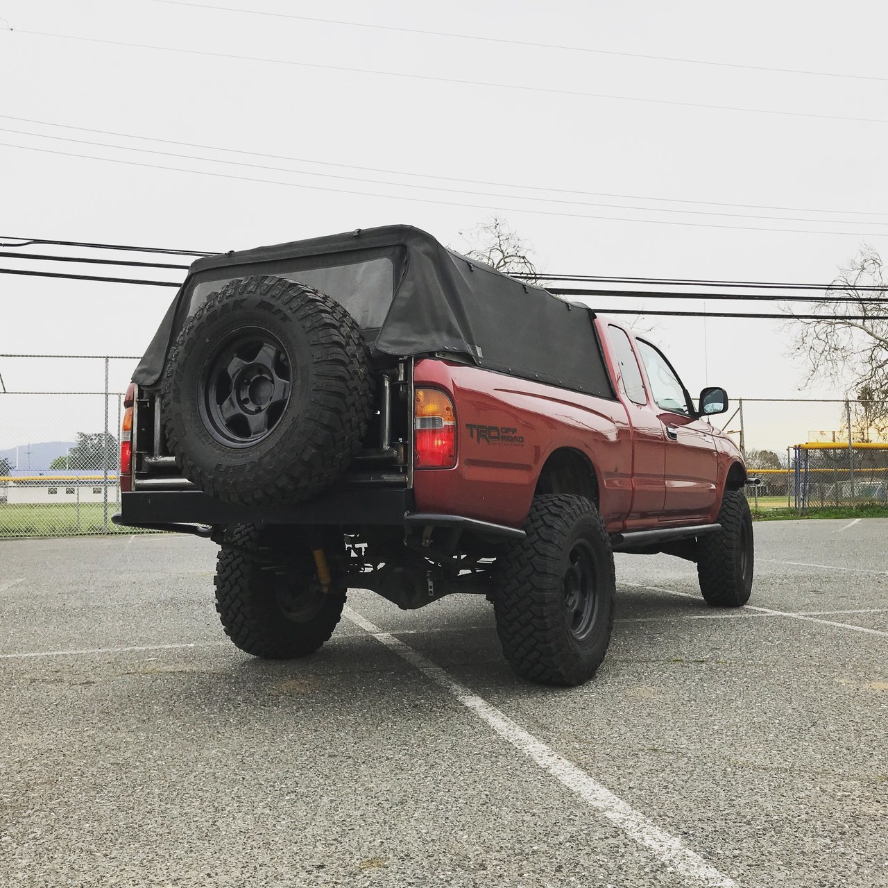

    Done for now, added some gussets, and added the tailgate mounting point on each side. 0CABA2E8-F62E-4F70-9985-4D20B606AC28.jpg32CB25BB-1EBA-4972-8714-70EBDD6BF1BB.jpg

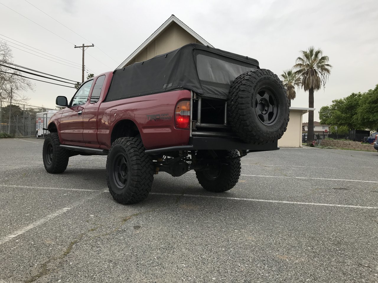

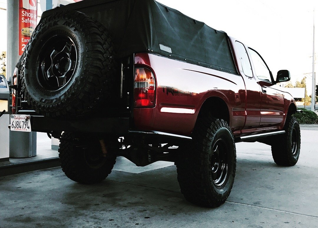

    D98F6913-3128-42AB-BC41-9F8D21B8D6F3.jpg Updates:
    Repositioned the tire higher gave it a slight tilt forward for clearance
    I enclosed the swingout with a table
    Added a hoop and lights
    Pretty much all that’s left is recover points for front and rear shackle mounts
