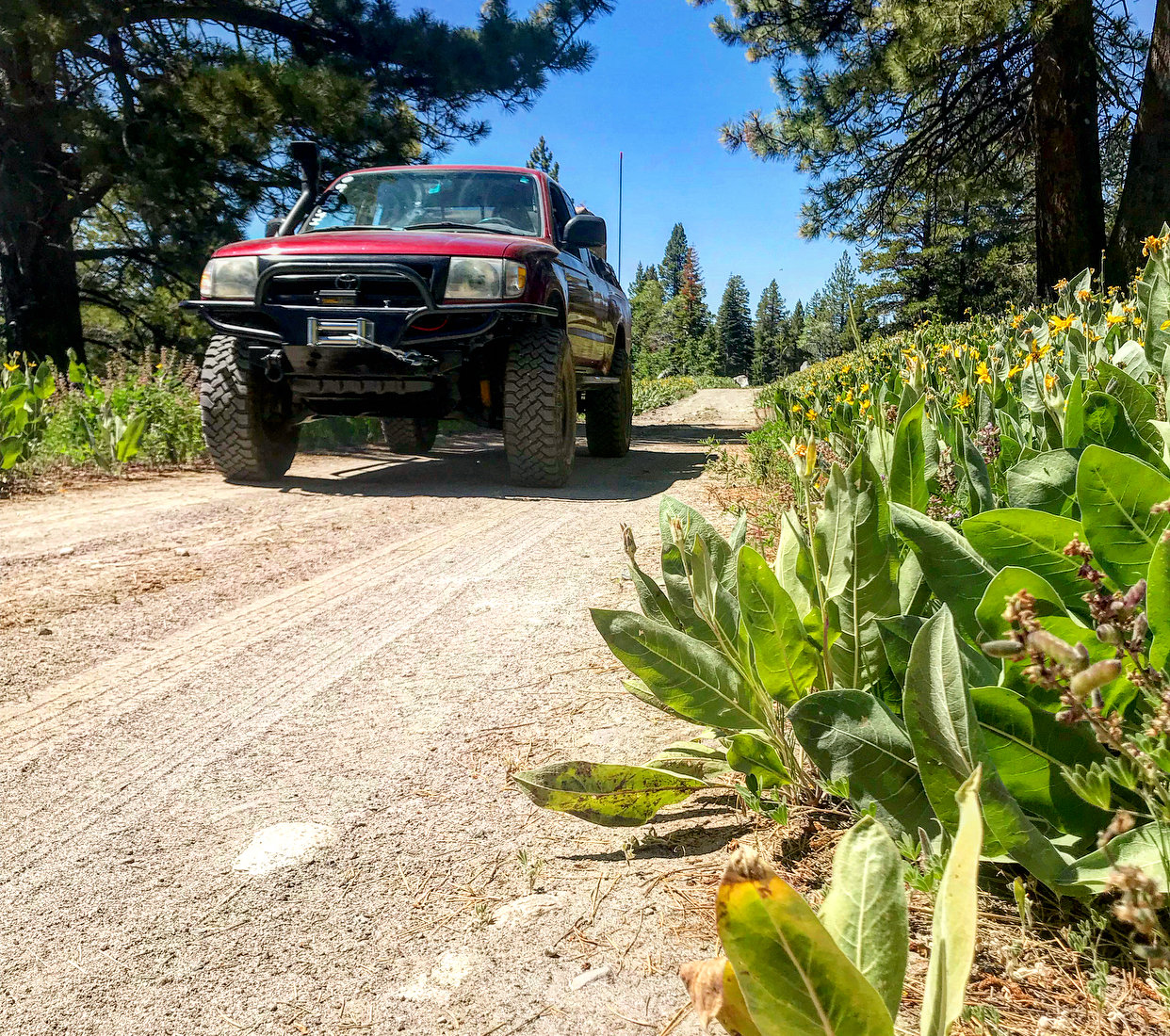

    Thanks! 3.5 BS -25 offset.
    Added some rock rash the other week :)

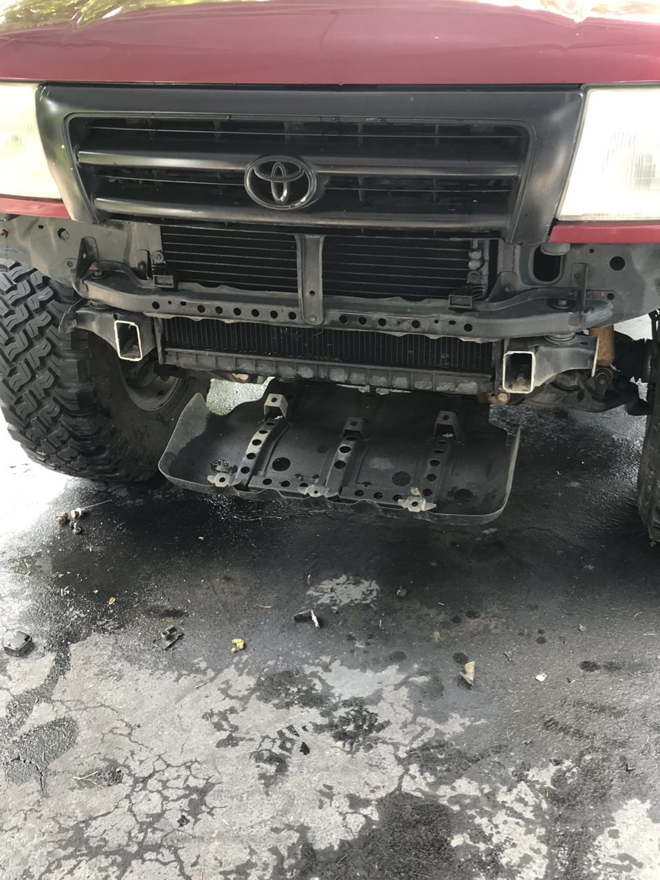

    It’s been while, been adding/collecting a lot of stuff for the truck. Also taken it out on a few trips to get a feel for some needed changes. Now that I have free time it’s back to building.
    I did change the thread title to DIY Armor and Accessories because I ended up building everything rather than just a bumper and I have a few small things left to finish up.
    Front bumper has been needing some recovery points, so I picked up some trail gear bolt on D Ring mounts.
    Had a clearence issue with the hardware and the frame horns so I had to chop the frame back a bit.

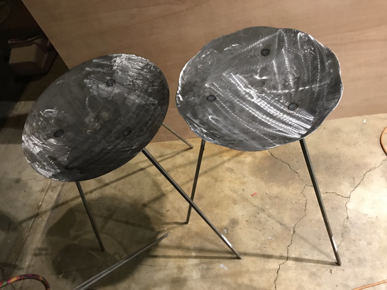

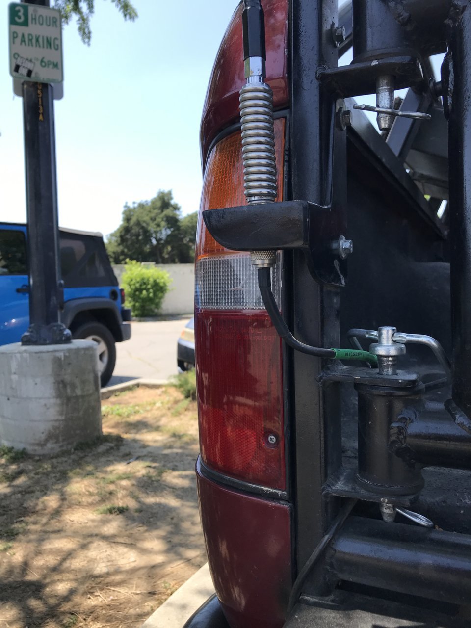

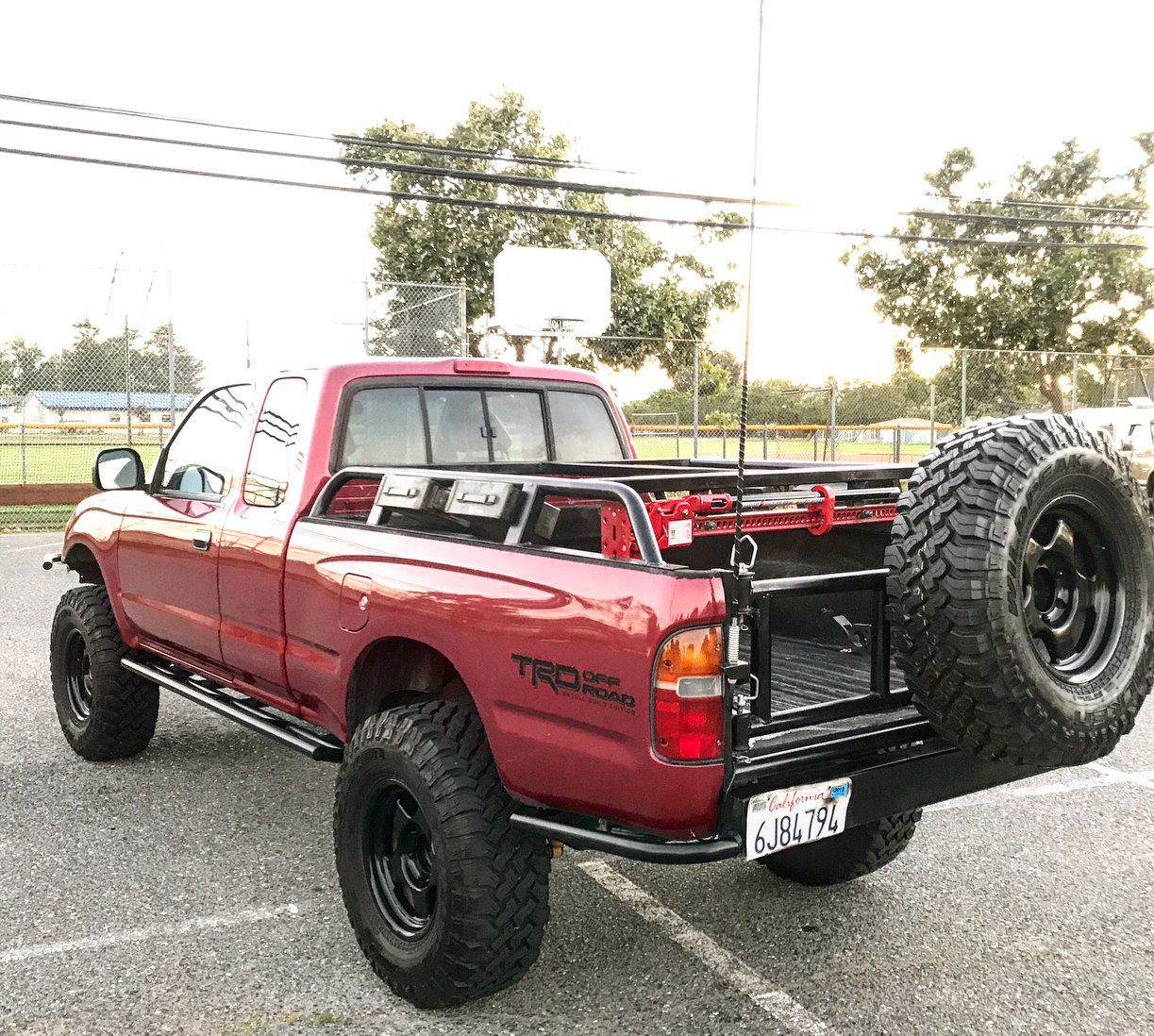

    Few other things I’ve made along the way
    CB Antenna mount and (nottles) short for not a skottle
    E88D6E75-712C-4A6E-8A0C-7986B738A663.jpg 446CACB0-7CDD-4784-A632-2BEC6FBA9A1D.jpg 1BE86872-19B4-41CB-B235-6C8C7A27C6AA.jpg
    Skottles suck in the wind an cold environments. I need to add a wind shield

    You have pictures of a bag hanging off the spare tire, what kinda goodies you keep in there?

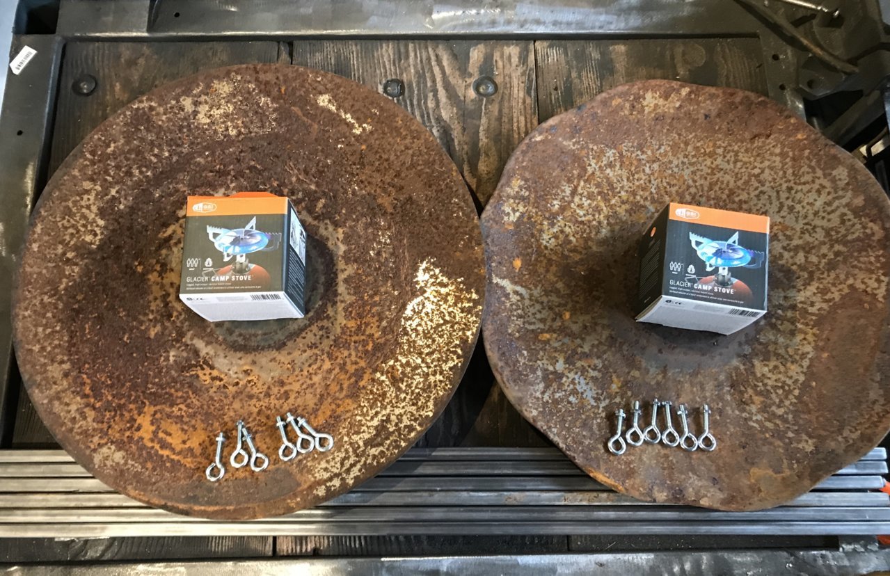

    Also what are these for?

  8. Jun 24, 2019 at 3:25 PM

    betterbuckleup

  9. Jun 24, 2019 at 9:28 PM

    Flap disc and cutting disc where the rust had decent pitting. Clean it with a sanding disc, and seasoned it with coconut oil for while then cooked bacon.
    There’s a few methods out there on how to season/what to use.

  10. Jun 24, 2019 at 11:15 PM
    #150
    TambaDoode
    TambaDoode Well-Known Member
    Feb 28, 2017
    #211953
    76
    JT
    2000 Tacoma Sr5

    Oh the trasharoo, just trash and trash bags

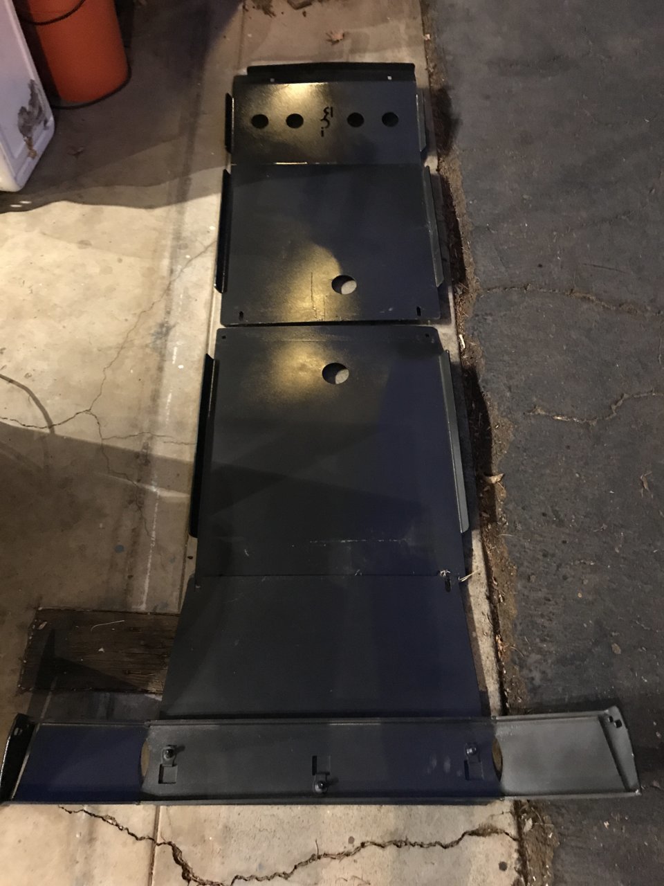

    Project make it work:
    2nd gen skids
  16. Aug 26, 2019 at 8:59 PM
    #156
    betterbuckleup
    betterbuckleup Well-Known Member
    Jun 26, 2017
    #222483
    4,821
    Ian
    Concord, CA
    2000 Tacoma SC 2.7 4x4 5spd
    i'll be curious to see how much you have to hack these up to make them work
  17. Aug 26, 2019 at 9:28 PM
    #157
    Fuergrissa
    Fuergrissa [OP] If you build it, trails will come.
    Jan 9, 2013
    #94858
    2,125
    Devin
    San Jose
    2000 T4R Limited
    Same here, the price was the cost of material so it’s already saved me a bunch of time. I’m just guna work front to back and fit one plate at a time.

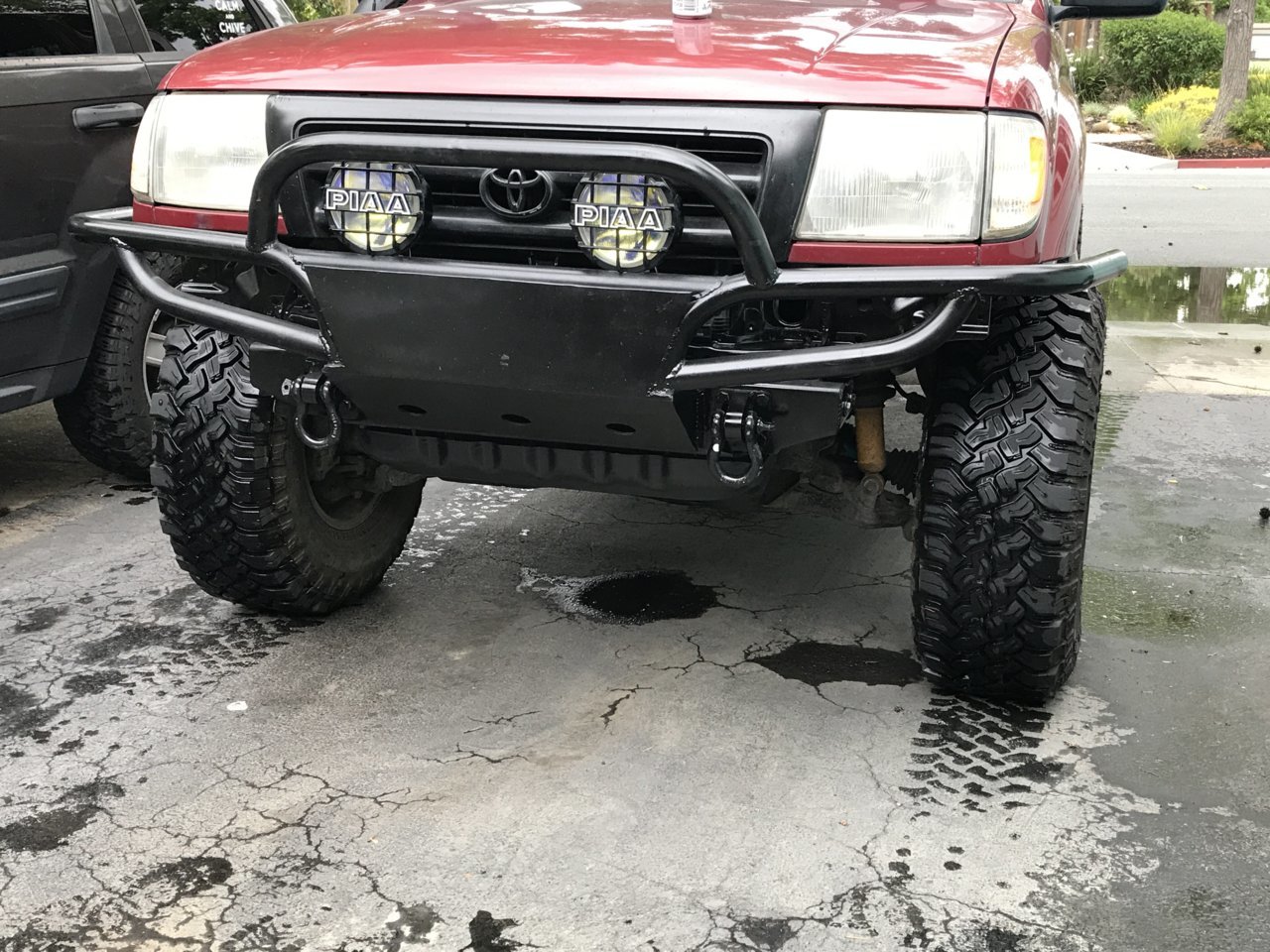

  18. Oct 13, 2019 at 4:09 PM
    #158
    Fuergrissa
    Jan 9, 2013
    #94858
    2,125
    Devin
    San Jose
    2000 T4R Limited
    So few updates:
    Sold the skids I did not like how things were fitting/how the 2nd gen skids would need to be modified so moving forward with custom skids.
    But first I’m guna have to build another bumper....1st one did it’s job well and protected the truck. Had a Tesla come to a dead stop on an over pass, blocked the lane and I couldn’t stop in Time. 33712685-08F4-4EF2-B9A9-18B1520F2262.jpg
    Doesn’t look to bad but bumper is bent and needs a new winch mount as it’s pushed back a bit.
    Any designs I should take on??!????
    Edit: thinking something a little more hybrid

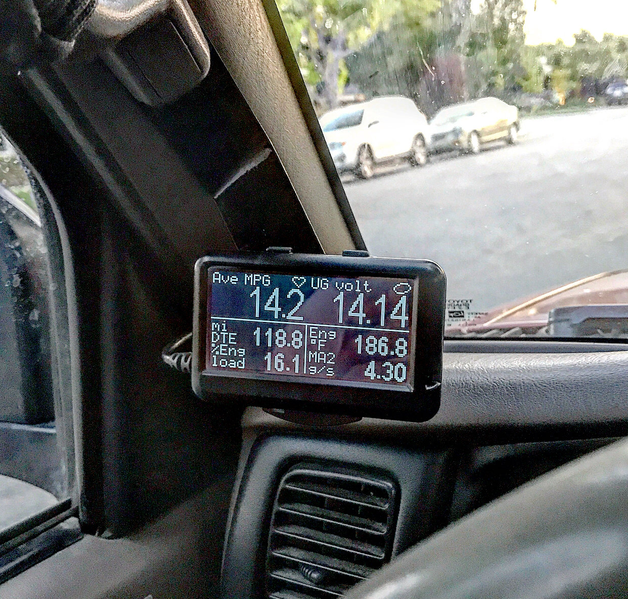

  20. Oct 13, 2019 at 5:33 PM
    #160
    Fuergrissa
    Jan 9, 2013
    #94858
    2,125
    Devin
    San Jose
    2000 T4R Limited
    Had some extra thin gauge and built an A pillar Ultraguage mount
