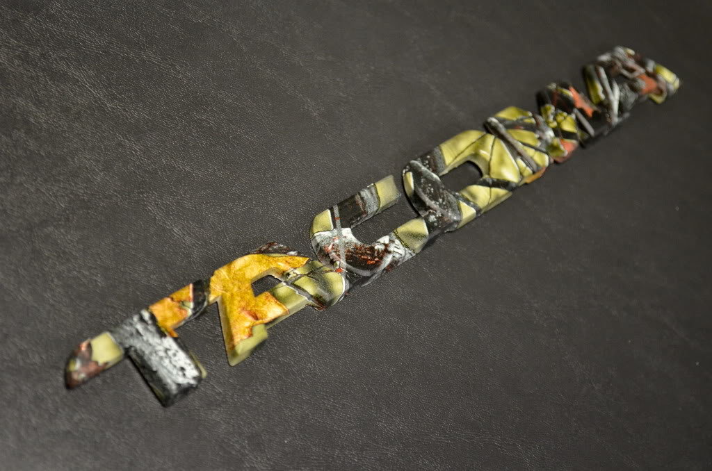

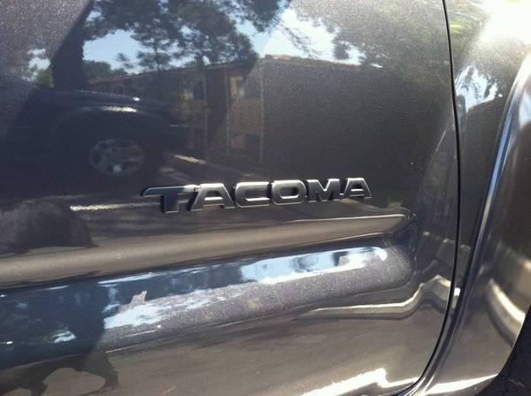

    Good write up and thanks for the help. Heres my finished result.
    [​IMG][/url][/IMG]
