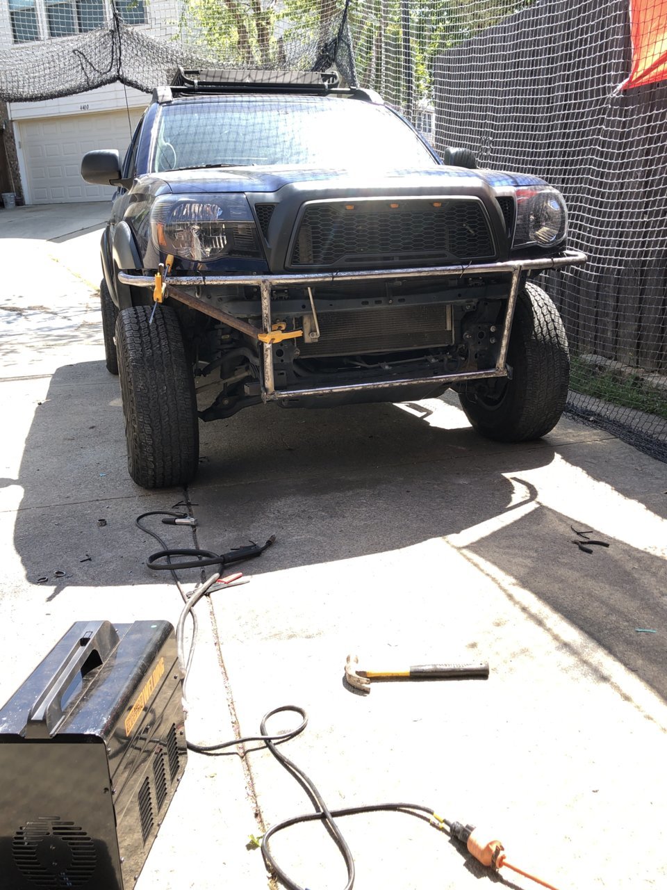

    Hey guys I’m back at it again with another project for my Taco. Was very bored as most of us all are right now and was thinking what i could use all my leftover pipe from my bed rack for. So I’m going to be making a Baja style bumper with skid plates and places for light attachments. ill post photos as i go. Today was just taking everything off and getting the first pipe bent as a draft. Let me know what you guys think as I progress and if you have any tips or ideas.

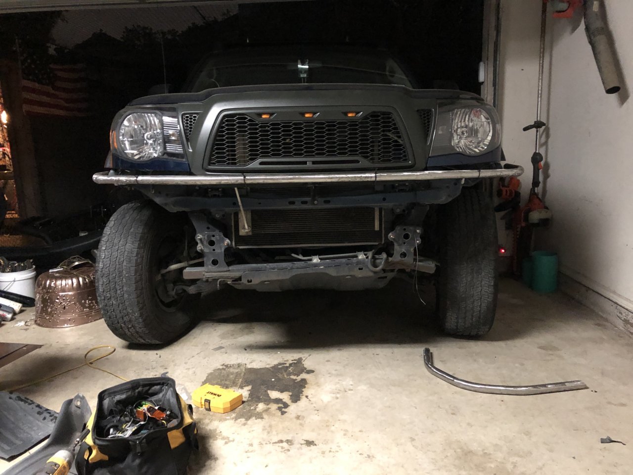

    About to clean up the pipe and weld it on there for the main basic frame. Then i can add more pipe outwards covering the top of the wheel wells. Once that’s done I’ll start adding steel plate and holes for my light bar

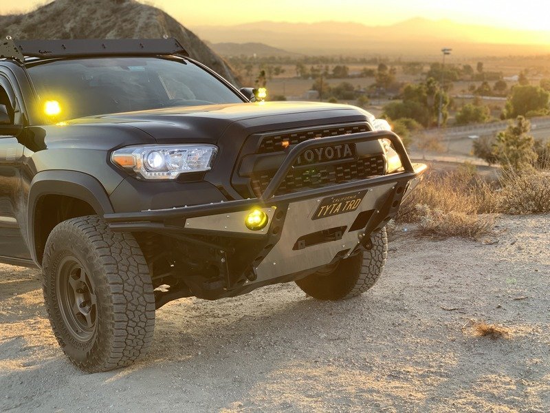

    IMO I'd bring the lower end in some, so it's more triangular and less blocky. Like this.

    I would do that but my front end is a little bent from the previous owner and i can’t straighten it so I’m trying to cover it a bit

    I see what you are saying is bent. You can cut out that whole cross member if building a Baja bumper like in the pic @EatSleepTacos posted.
    What you mocked up will result in crappy ground clearance

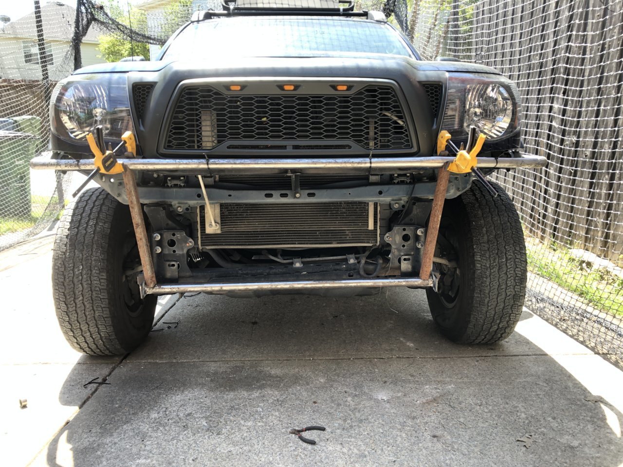

    The bar on the left I’m just using as a reference. Think I’m going to take it further out towards the bend and weld it half was down the main plate.

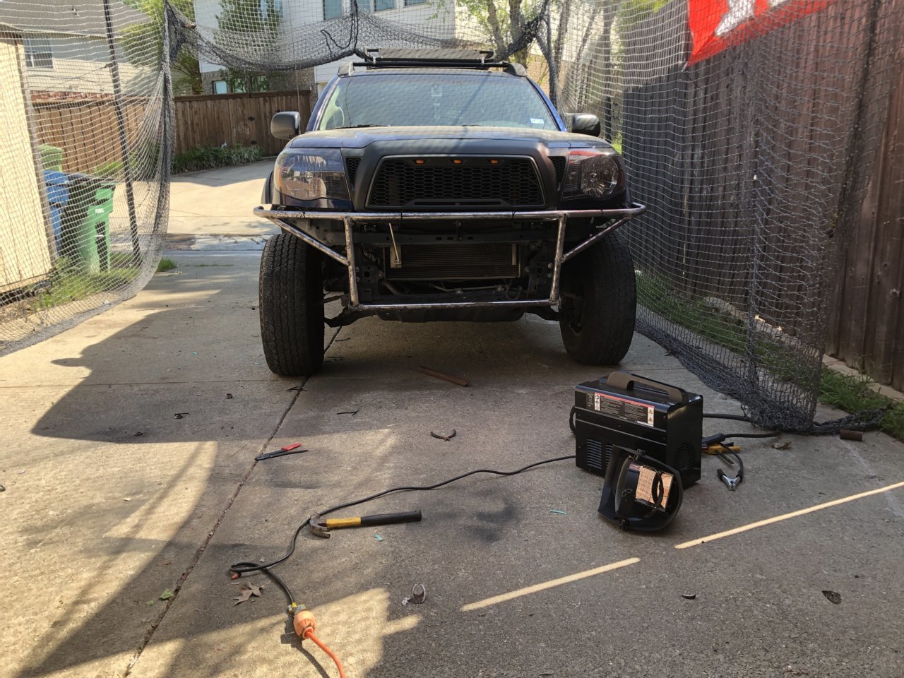

    Maine frame is done. Still debating if i should run another pipe across the middle and split it or leave it for one big plate.
