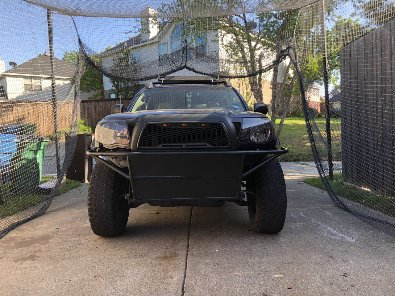

    Well it has come time for my last bumper I made to be replaced. I am already almost done with the build and has come along great. Just basically making a new bumper with everything I wish I had done with my first. Ya know things like thicker pipe, narrower and silver skid plate, more ground clearance, and better welds and mounted better. I actually cut a good amount of the front end of the frame without losing durability to give the bumper more of an angle and to gain ground clearance. I only have two more pieces already cut and bent that just need to be welded on and then shell be ready for paint.IMG_5355.HEIC.jpgThis was the old bumper just as I finished it

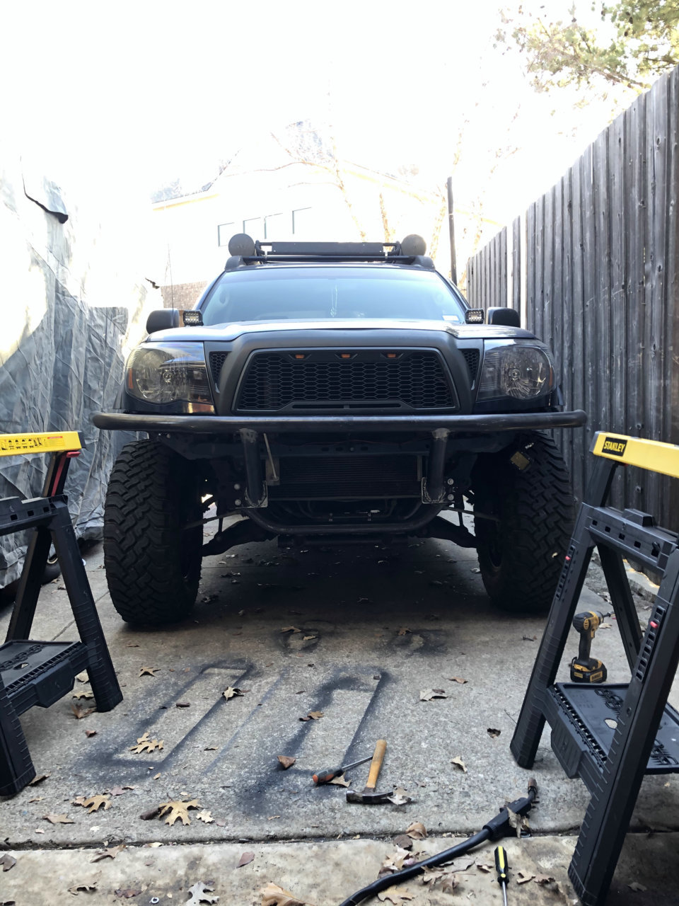

    Main pipe welded on. Also to be clear this pipe is welded onto a homemade bracket and bolted in with the pre existing holes in the front end of the frame.

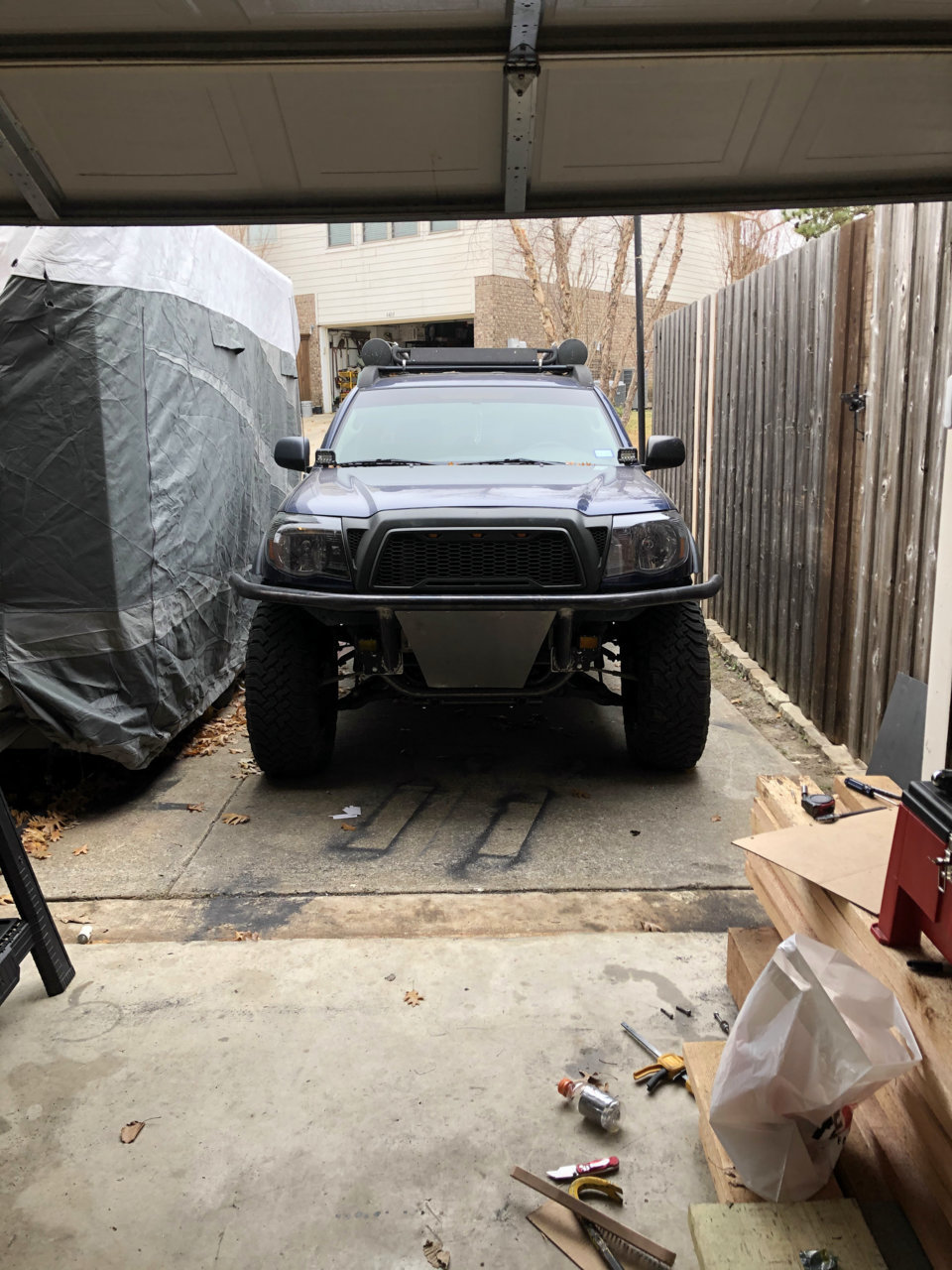

    Theres the frontend with the skid plate attached.

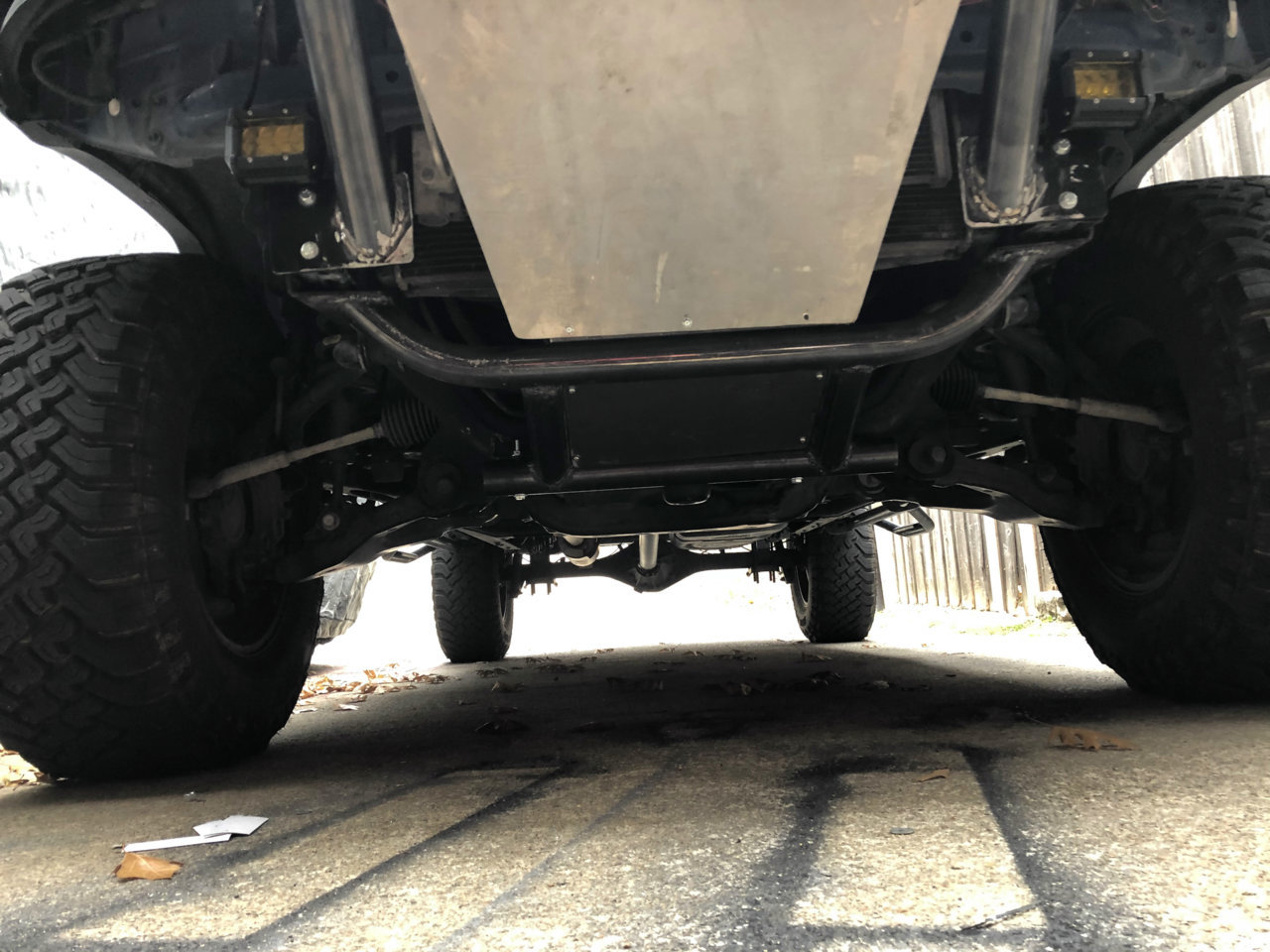

    Heres the bottom section of the bumper with a second skid plate below. The bumper is set up as two main pieces, a bottom and a top. It is easier to bolt on the bottom first and then the top with help holding it. Then the main skid plate bolts in to 2 pieces of angle iron at the top and the bottom connecting the top and bottom pieces.

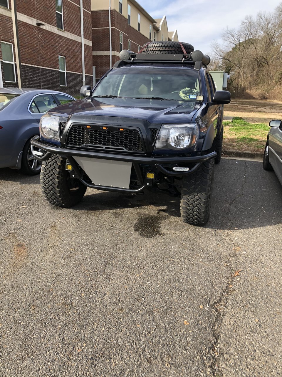

    2070B9C7-260F-43EE-AB8D-B6B26484565D.jpg Didn’t get around to posting the finished product but i got moved into college and here she is.
