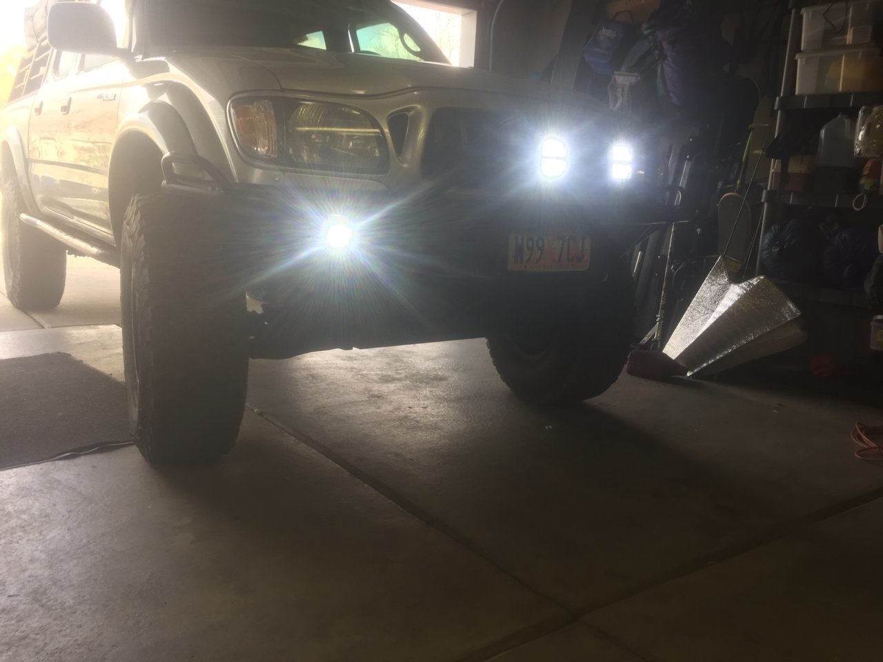

    After a year or so of parts sitting around Bussmann is in and done!
    C2D88B84-5420-433B-8131-BFD91EB3F0ED.jpg 84934CEA-4EA7-43CB-B497-768BEBD74135.jpg C45C7A2B-5456-42C7-BB0A-0C5F68B076B9.jpg 5AE69233-1688-42C1-9C0D-C2870438C0F8.jpg 7F67FE37-FA4E-497B-BCAB-CD83022ADF84.jpg

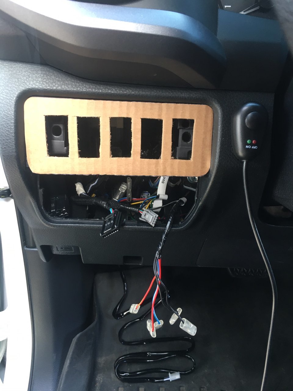

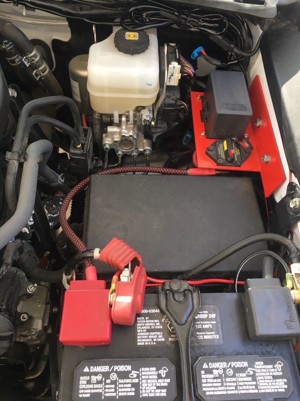

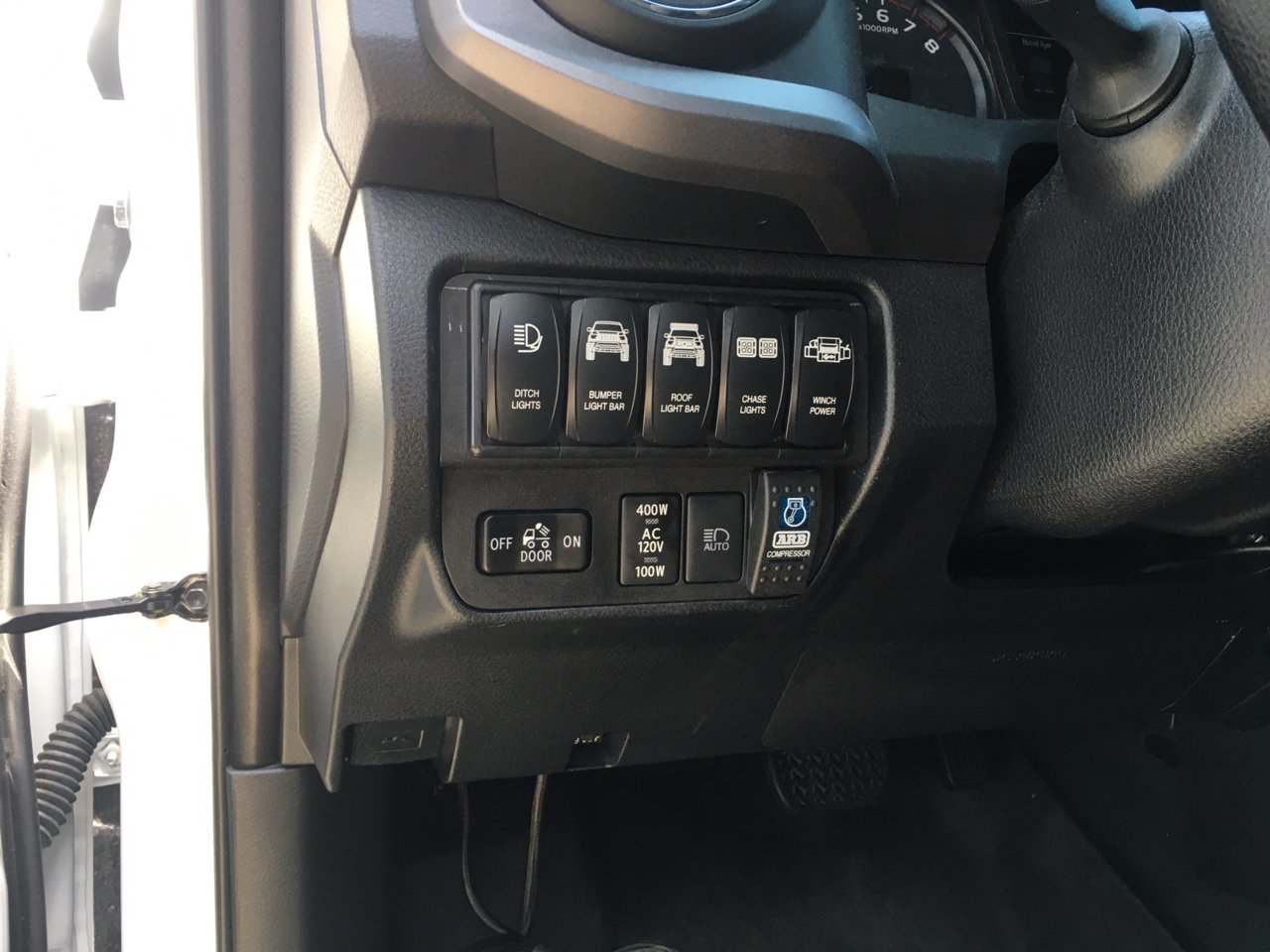

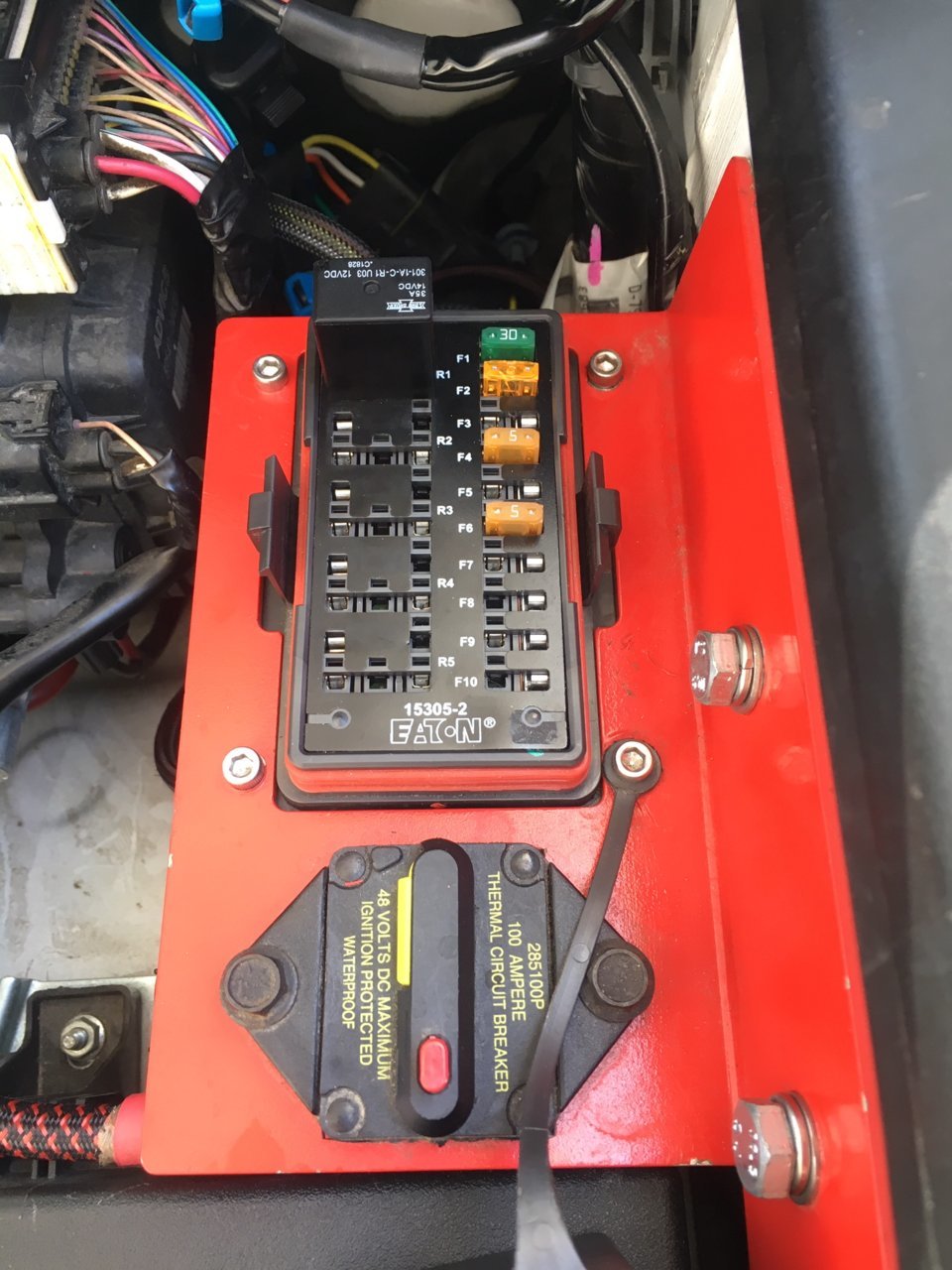

    Well here's my weekend project done, just have some cable management to do but its in.
    PzTank, tacozord[OP], SR-71A and 2 others like this.

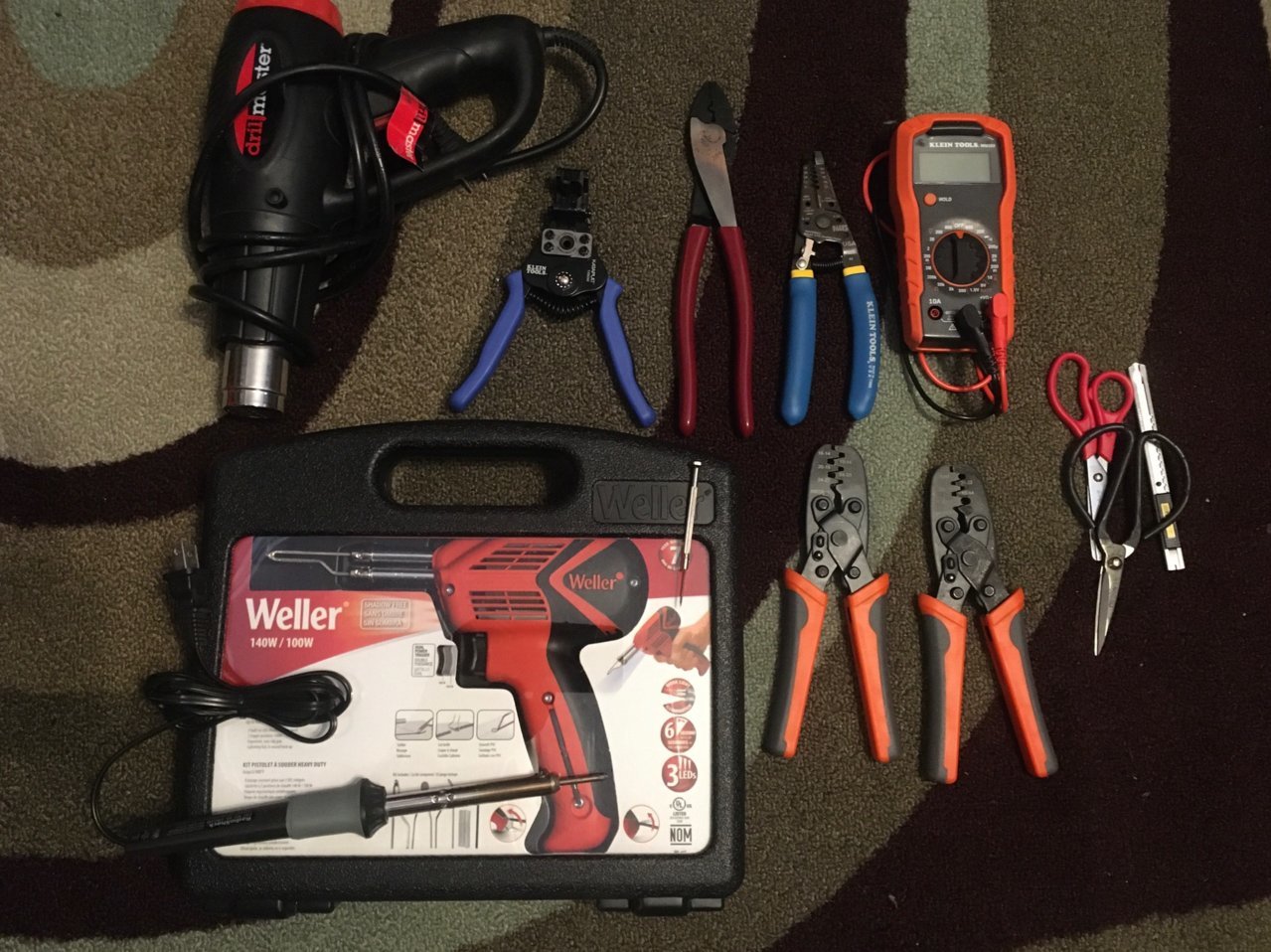

    I bought a few because I had some of the common ones already. Heres the ones I bought and then some of them I bought better versions of because of the number of times you do the same process over and over (wire stripping SMH). Im pretty sure I listed everything but definitely ask about anything else I may have left out.
    Top Row
    1. Heat gun
    2. Wire Strippers *Klein Katapult
    3. Crimping Tool
    4. Wire Stripper
    5. Multimeter
    Bottom Row
    1. Solder Gun & Solder Iron *the soldering iron I had from before but is a cheap 25 watt from Radioshack (RIP) the iron was providing enough heat for the gauge wires I was dealing with so I bought the gun and it was a WORLD of difference go with the gun and watch some videos on how to solder.
    2. Small Precision Flathead Screwdriver *had from a kit before
    3. Metri Weather Pack Crimps I bought the cheaper ones of these worked out just fine
    4. Miscellaneous cutting tools *scissors and utility blade

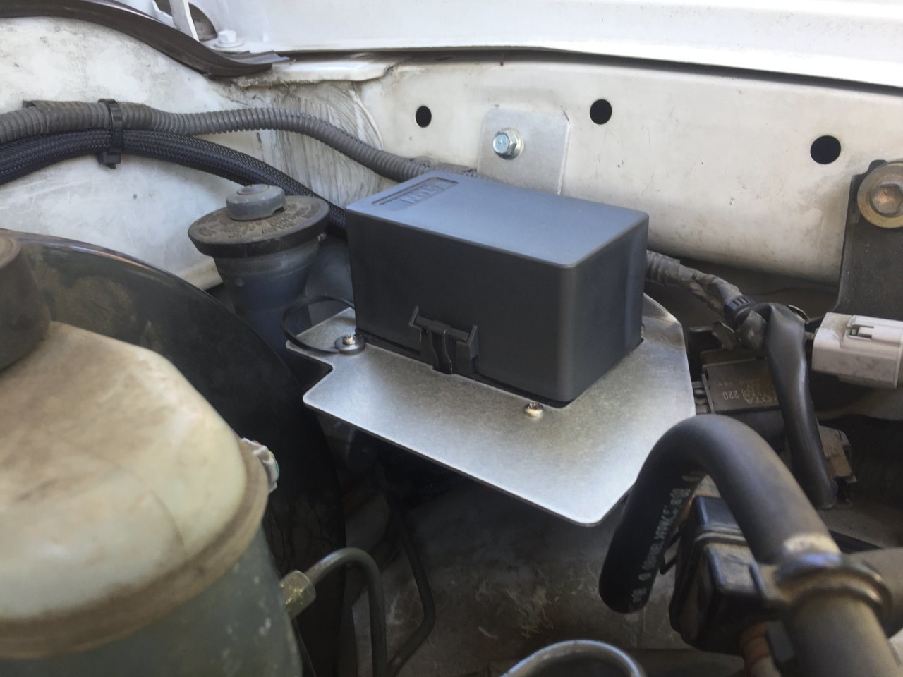

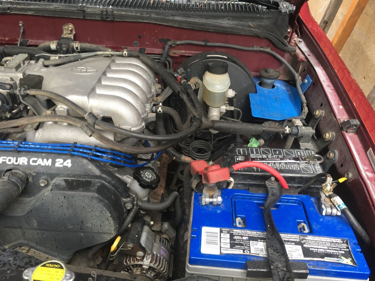

    From https://www.paranoidfabrications.com/collections/toyota-tacoma I used the contact page and he cut me one not advertised on the site for a 1gen with a clutch, worked perfectly.
    92450D81-B94B-4834-85C3-D9A5A1E9FFDB.jpg D6BC6609-3F3A-4A3B-AA43-9E2EE31C2D3C.jpg

    That’s awesome. I didn’t even think to do that. I bought one from him for the automatic and have been planning to just cut a hole for the master cylinder.
    tacoma_ca[QUOTED] likes this.

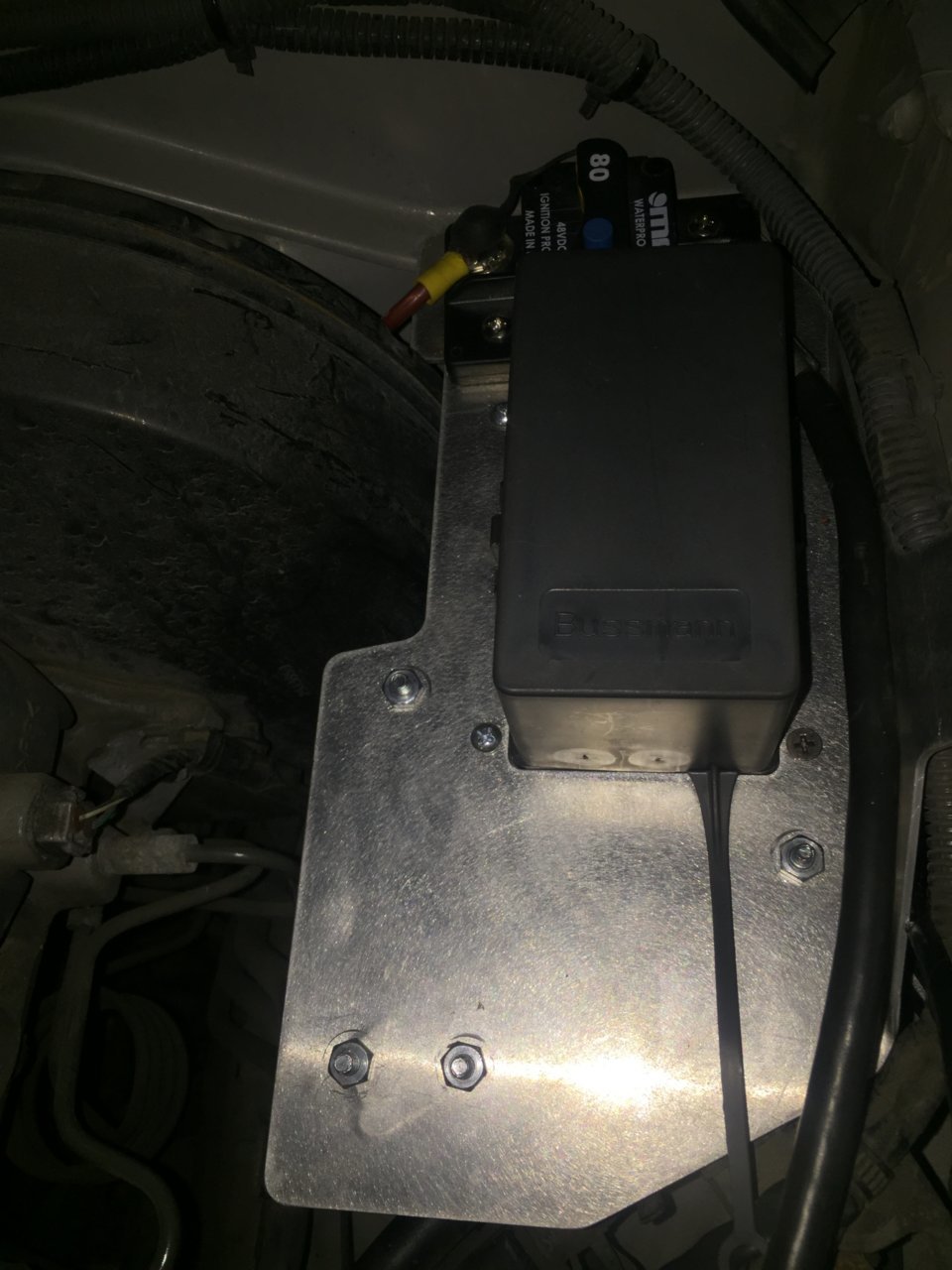

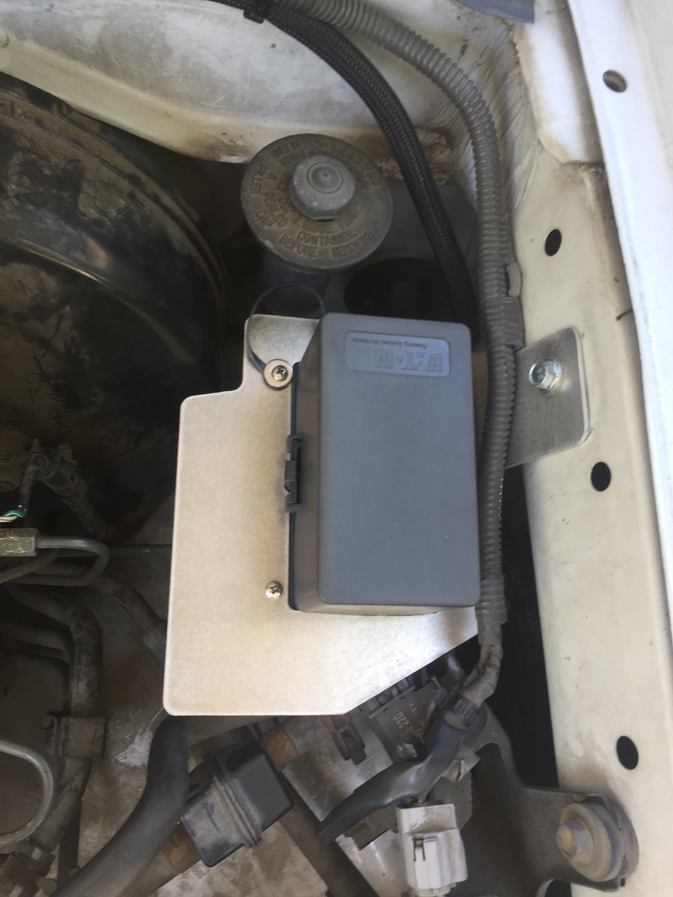

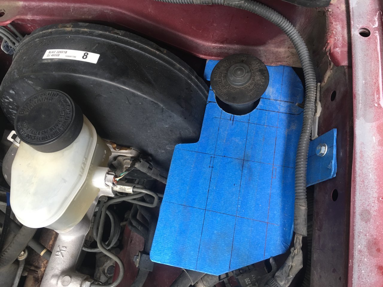

    I cut my hole today for the automatic one. Used a 2” hole saw and had to take the mc loose to get it on, but I think it’s going to turn out pretty well 7B23793C-D039-46B0-8E29-EB8CD92CA824.jpg61917D55-1592-4C31-950A-A4EDA67532FF.jpg
