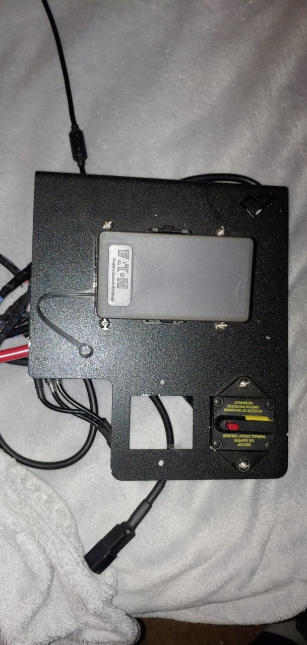

    What are you using the other breaker for?

    You can’t split the positive buss anyway to have the relay fuses and fuse only circuits on separate breakers. You can keep it for a remote panel elsewhere or for some other high drain accessory like a compressor. Most compressors draw too much to be fused through the Bussman anyway so a separate breaker or fuse is a necessity for those. Basically any single device that exceeds 30A draw should be powered separately. You can daisy chain the main breaker inputs if the total amp draw doesn’t exceed either the cable rating or the first breaker’s rating or if you’re never going to use them in such a way that you do. It’s already been stated that you shouldn’t power up every accessory simultaneously if the total exceeds 80A.

    That's the mount I used. It's a PITA to install because the bolts are below the mounting surface. Hard to get a wrench under there. It takes a while, so if I ever have to remove it, I'll replace it with another mounting solution. Not sure what though because I need the double breakers.

    My plan is to mount the busses on the Bussman mounting holes to give me another inch or so to install.
    What are you using the second breaker for? I want to buy this mount, but not sure I want to use the second slot for. I thought about for the winch, but they don't make a breaker high enough and I'd have to go with a quick disconnect which doesn't mount up.

    You could also double up the ground wires on a single ground buss on the other side or put both ground busses on the other side. The ground busses are rated at 100A each. I’ve seen some pics of fuses or breakers mounted to the top of the oem fuse box but that would seem to interfere with access to that box. Even routing cables over the top of it seems questionable to me.

    I have an 80A breaker for the RTMR and a 40A breaker to charge my trailer. I tow a Patriot X1GT and charge it via an anderson plug I wired into my bumper. The stock 7 way doesn't supply enough power to charge the 2 120AH AGM batteries in a timely fashion.
