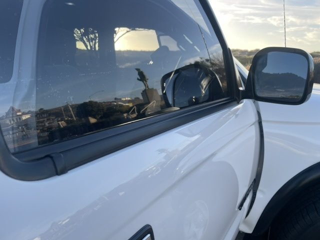

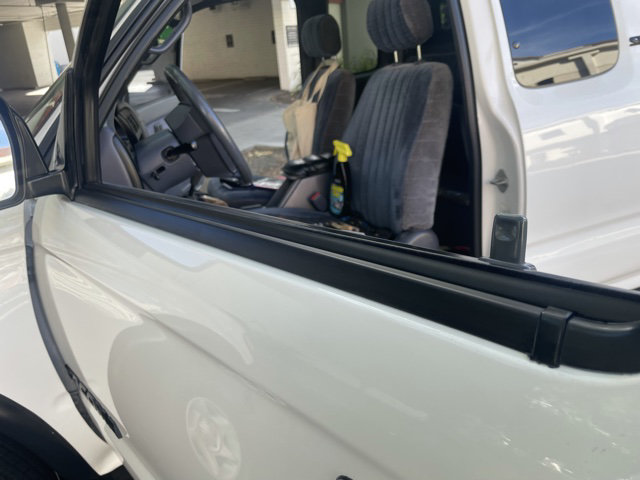

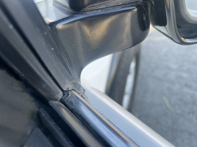

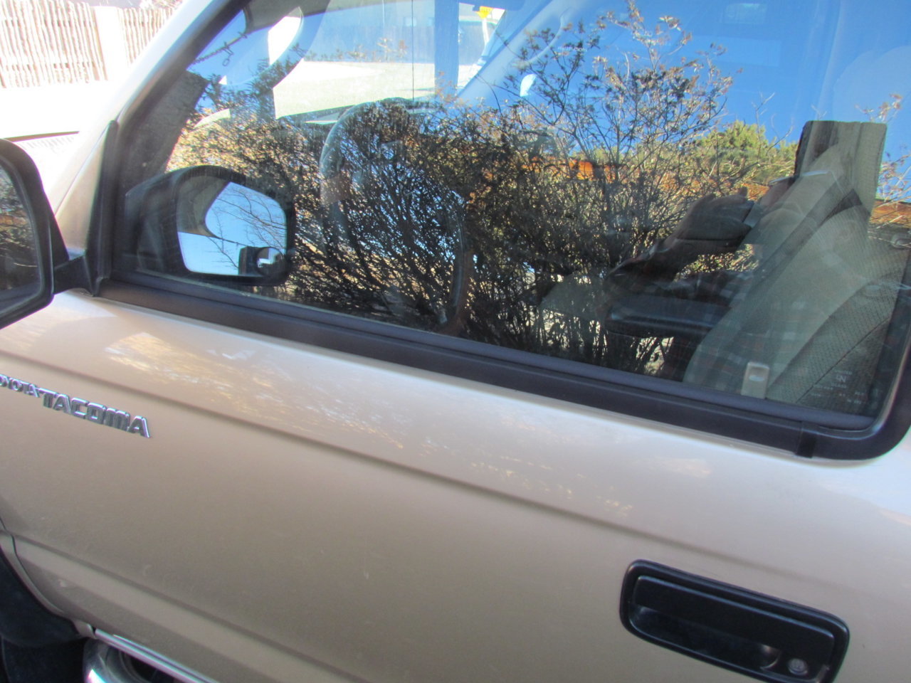

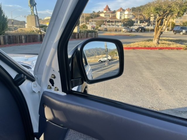

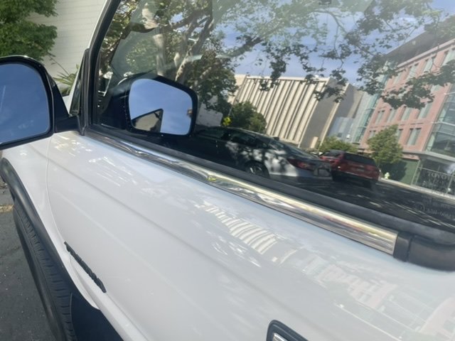

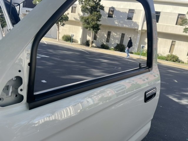

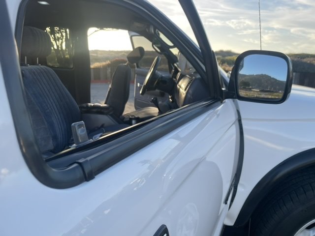

    Finally got a chance to put these on—bought them months ago and gosh is it satisfying and so much cleaner. While removing the side mirror isn’t strictly necessary, I think it makes the job easier and it also makes it a lot easier to clean the mirror and the seal that goes between the mirror and the door.
    I also put a light coat of silicon plastic restorer on the new trim so that hopefully the black film doesn’t burn off too fast—this was a Vegas truck for most of its life so I had no idea the trim wasn’t chrome originally (all chrome when I bought it a few years ago).

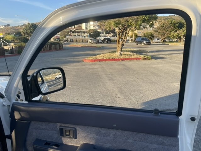

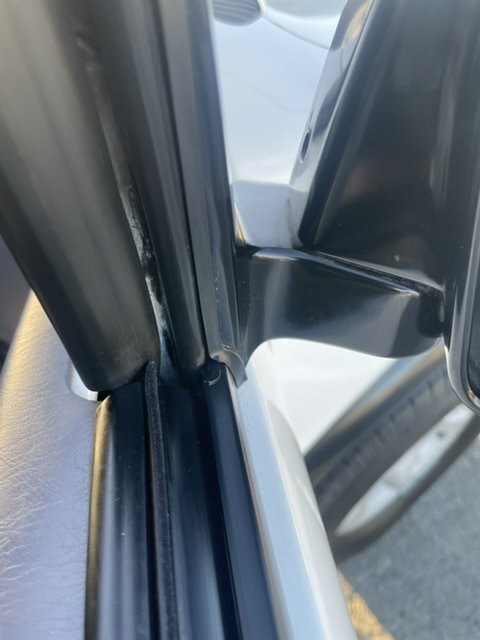

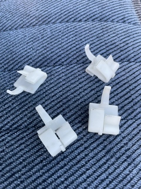

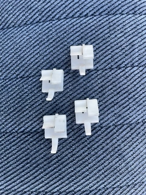

    I did the other side this evening and it looks so much better. I also stripped off the clips from the old ones—anyone need them? Would be helpful if you’re repainting the trim instead of replacing.

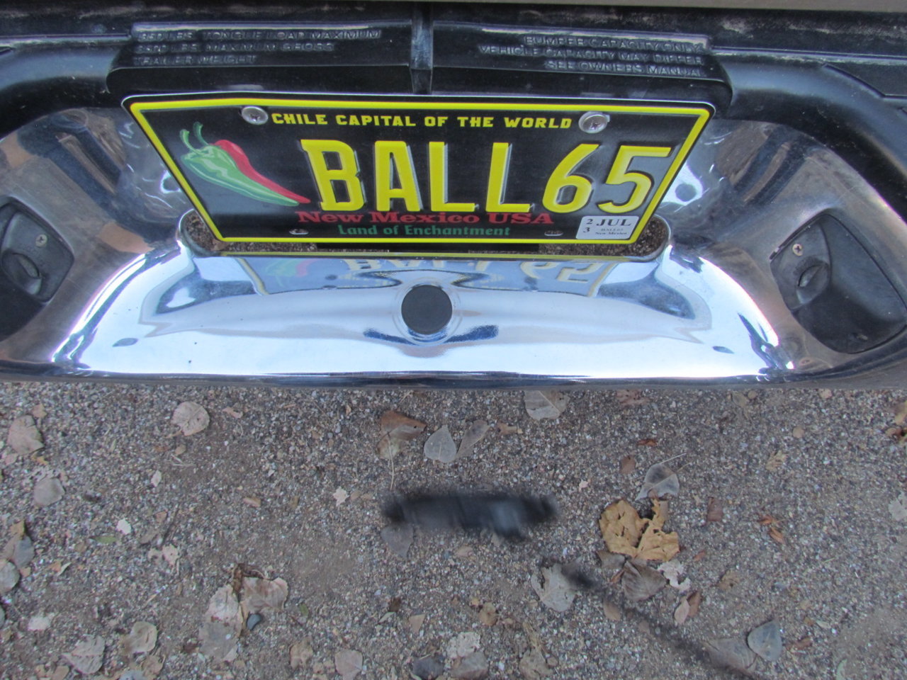

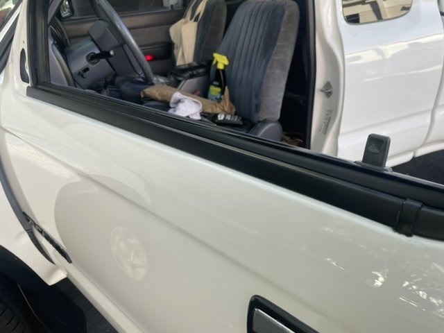

    Weatherstrip on both doors replaced today with the oem parts. Hardest thing was removing the old strips, but nothing a little extra effort wouldn't overcome. I'm glad these were still available.
    I also got the rubber plug for the hole in the rear chrome bumper.

    Skipping over the (tempting) innuendo, do you happen to have the part number for the bumper plug?

    Did you end up using PT22835985SM or a non-OEM/Home Depot plug approach? As discussed on the other thread, PT22835985SM comes up with a square picture but some folks say it comes round apparently--curious what you used.
