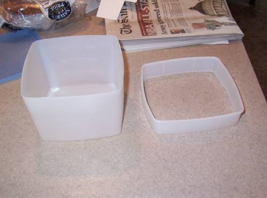

    Great Mod! I wasn't so industrious on my solution to console jumble.
    I bought a plastic food storage box from Kmart. 2 for 2.99.
    Cut the top off.
    Stuck it in the console.

    That's something different

    Nice, It's beauty is in its simplicity. Anything is better than the stock storage box.

    I did this after a friend was nosing around in my truck, looked the console and said "Where'd you put the stick that you stirred that up with"
