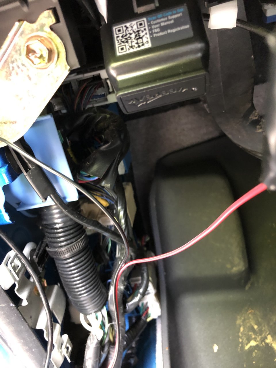

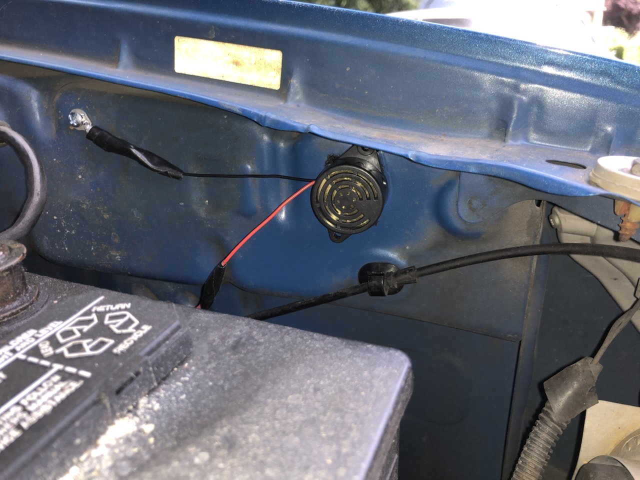

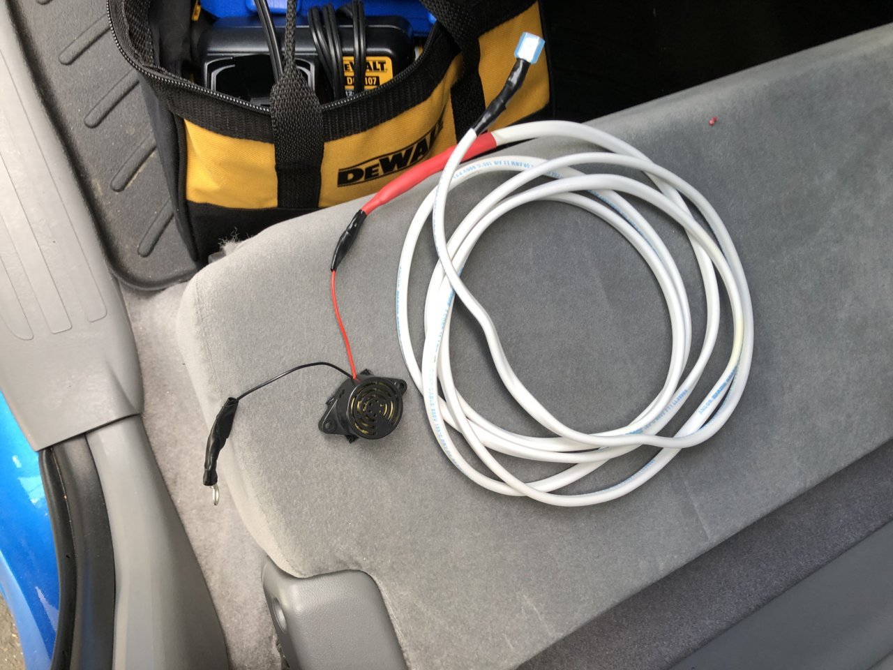

    Well the photos are gone in the original post, so Hopefully I can help people who would like to do this?
    So here’s where I started. Had some wire sitting around, so I picked up a cheap Pleizo Buzzer.
    Couldn’t find the wire near the fuse block that OP had said, so I went into the kick panel. Pretty easy to find, just takes a minute.
    A3E867CD-BA50-45BD-A9A6-4824AB11725C.jpg 9E467D2E-C738-4669-8E75-B9E81C545852.jpg 242C59FE-8F06-4463-9884-2490A52632FF.jpg
    Ran the wire through the rubber grommet in the firewall. I cut a small hole and just pushed it through.
    Finished product! The alarm works on lock, and I now have peace of mind locking it while walking away!
    Edit: I also went with a quick disconnect Incase I end up hating it.
