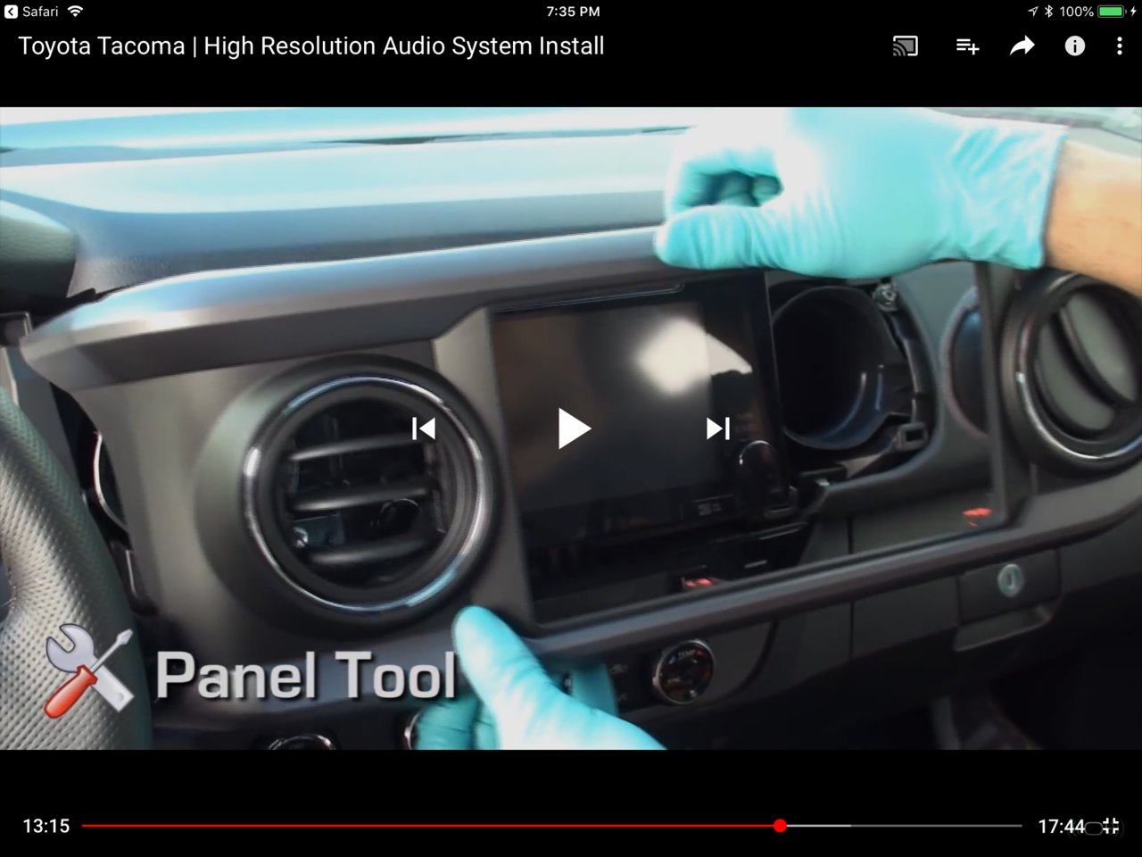

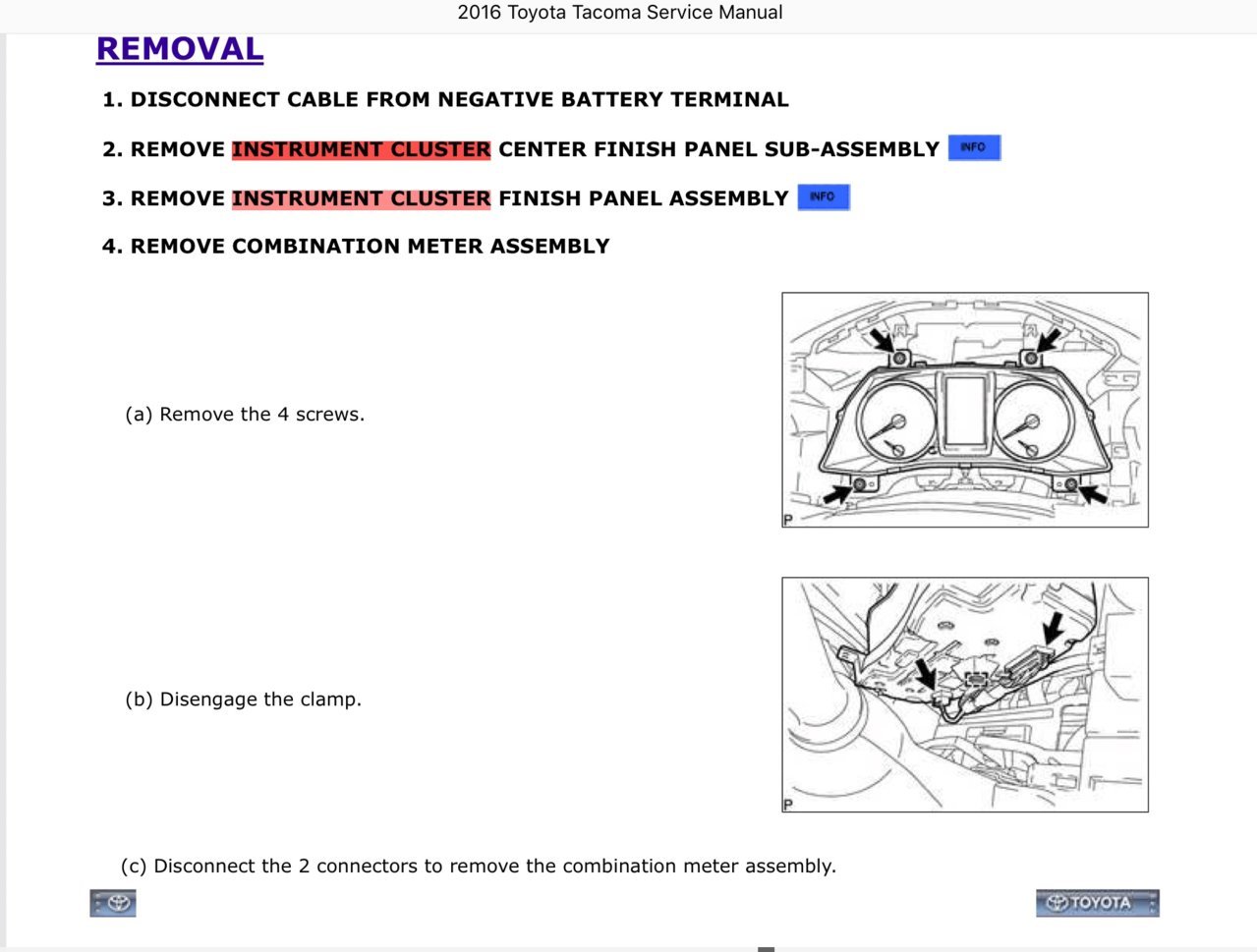

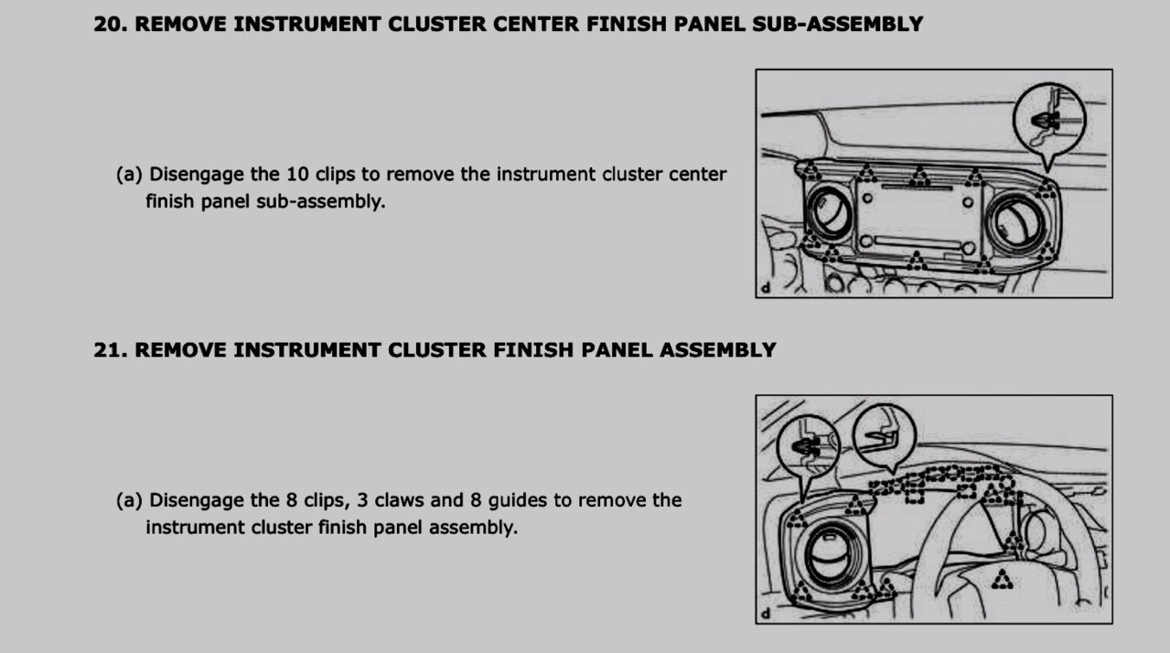

    Thanks for the great idea. I tried to just tape over the speaker but that had little effect. Ended up just cutting the speaker pretty much like your result.
    In the service manual found the directions and diagrams and a snapshot of YouTube video removing the first panel to be removed.
