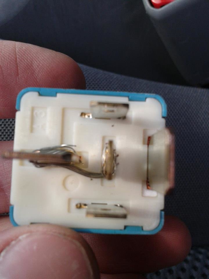

    Hey guys.... here's another option for the same mod... only instead of using Solder... you can use a few strands of wire and wrap it around the 2 posts:

    Good option for those who don't or can't solder. Soldering makes a permanent joint and is ideal but for this application this method will work as well. Just make sure your stranded wires are twisted tightly so you don't have any straws that could potentially contact something you don't want them to. Also, leaving the insulation in the center part might make things a little bit easier. Good option and further proof that mods have many different methods of completion.

    I was thinking exactly this for those who want to take the mod for a test spin before soldering up their relay! That way they can play with the lights/fogs/brights and understand what they're making first.

    That's a good option. I for one am not much of a solderer but still find it simple to solder and then de-solder should I want to undue a mod. To me the thought of loose strand of wires that could short across connections you don't want them to doesn't seem like a good way to go about things. Maybe instead one could use a solid wire instead of stranded wire. This would be thick enough that you could wrap it around and be sure that it's going to stay somewhat in place a little bit better. Using stranded wire draws a mental picture of a single little strand poking out and then making contact with one of the prongs right next door and doing bad things. You just want to make sure your mods are solid so you aren't chasing electrical gremlins later.
