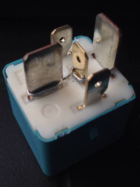

    Just did this myself and it all works great! Wrapped some extra wiring around each pin so I could get to them when it was plugged in. Hit each with the multimeter and everything is showing normal and functioning pretty much normally.
    I used a perfectly cut piece of solid copper wire and soldered ot to both pins the OP showed
    Another good way to do it is just like what I have quoted below from Burgh, but to also add some solder ro prevent any possibility of slipping off, thought it would amaze me if it did.

    State Inspections are actually a good thing to consider. Texas has one and I'll have to see if I get noticed having both High and Low on at the same time. It will be a while before I need an inspection, so I'll probably forget unless I alter the mod now.
    To make it easy to return to stock for an inspection, there are two ways. Have a spare relay, or instead of this little jumper between terminals, sub it with wire out to a toggle switch, that can sit in the compartment with the fuses and relays. Then when you go for inspection, just flip the switch or swap relays and it will be stock for the inspection.

    So does the jumper wire have to be heavy enough to handle a certain amount of load or is all that is being done is a short circuit? If that is the case, "not that I would use it, but would something as simple as a piece of tin foil work?" Just trying to get a clear description of what size wire to use, cause I tried this with 16 gauge and could not get it. Also I found out that I can not solder worth a crap. I think we would have a better chance of pigs flying than me getting a successful solder.

    It's a weird thing to solder. I had to wrap the wire around the relay pin and solder it to itself tight around the pin

    It really shouldn't need to be super thick but I've seen a few people now just wrap the posts a few times with the wire and it will stay. You can even just 'tack solder' the wires once wrapped as they should hold the solder better than the tabs.

    Thanks.....I'm just glad I decided to buy an extra relay before I tried it. Screwed the other one up pretty good, melted the plastic some and had it looking pretty ugly!

    When the relay is in the socket, it's all the way down, so wrapping a wire like Ostrichsak said will cause the wire to stay in nice and tight.
