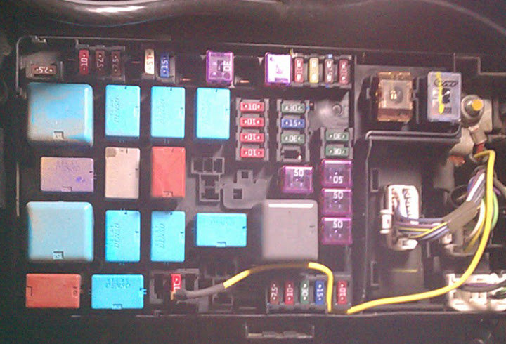

    I have question. What if I just want fogs to be on my shut off the headlights.can I still have them on with low beam I'm new to this wanna do this but I wanna see how to works first

    If you want to have your fogs on and NO headlights at all you'll need to search for the other method which uses a wire to jump so that you can simply use your fog switch to turn them on/off independent of the headlight condition. This is more for those who don't want their fogs to turn off when their brights are engaged.

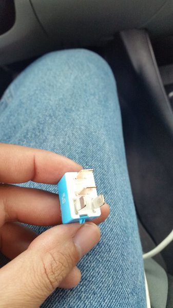

    The relay on my 2015 looks different, what did the 2015 OR guys do?
  11. Dec 26, 2015 at 10:00 AM
    #131
    ramonortiz55
    ramonortiz55 Not A Well-Known Member
    Nov 28, 2012
    #92013
    35,247
    Ramon
    Texas
    2015 DCSB Offroad 4x4
    stock
    Did your relay look like the one i posted above?

    no mine looked just like the picture of the first post are you sure you pulled the right relay
  13. Dec 26, 2015 at 8:20 PM
    #133
    ramonortiz55
    Nov 28, 2012
    #92013
    35,247
    Ramon
    Texas
    stock
    I think so, can you show me were you got yours from? My relay was located in the small fuse box behind the large main fuse box under the hood.
  14. Dec 26, 2015 at 8:26 PM
    #134
    belrose
    belrose Active Member
    Jun 8, 2015
    #157041
    42
    North end of Toledo Bend Lake
    2019 TRD Off Road
    3'' pro comp lift with pro comp wheels and 285/70/17 Toyo A/T II open country
    it looks like you pulled the one beside the red one pull the one on top of red one2012-04-11%252010.44.07_97a7466783c296bb057bb743ad6418fe7f664a3d.jpg

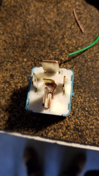

    So after a bunch of research and reading through the "Fog Light Any Time Mod", I was about to pull the trigger on that method. Even though it was not going to accomplish what I wanted. In my GTI, you could have it programmed to keep the fogs on with the high beams and the low beams stay on with the high beams. I never understood why Toyota turns the low beams off with the high beams? I understand that they must turn off the fog lights due to some states laws, but they should have kept the low beams on with the high beams for extra light.
    Anyways, I found this thread an hour ago right before I was about to do the other mod. I am glad I found this one because it was exactly what I was looking to accomplish and it seemed way easier. I dont ever see a situation where I need the fog lights on and not the headlights. A trip to Lowes for some wire and I was done in less than 30 mins.
    Here's my relay with the jumper wire. No solder used, just wrapped tight and pinched the wire tight to each leg.
