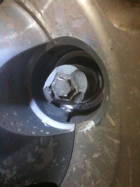

    yep, totally killed the lock nut on the tire.
    anyone know how i can remove this thing?

    find a cheap 12pt socket, that almost fits..TIGHT! hammer it on, unbolt it..and toss the entire thing. i have done it twice..getting the wedge lug out is not easy for me. better to use a friend's sockets.
