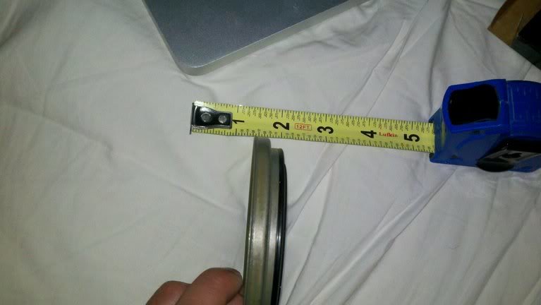

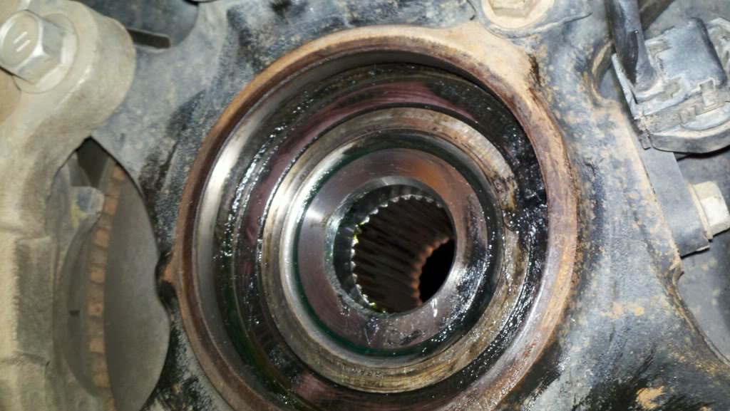

    Okay so you got the inner race off correct? Cut and chisel?
    You put the new seal on the bearing then pressed the hub into the bearing with the seal sitting against the back side of the hub correct?
    Then you put on the backing plate and o-ring and bolted the hub/bearing assy into the knuckle (spindle)?
    Then on the back side of the knuckle you replaced the oil seal?
    Inserted the CV through it and tighten down the nut to 173 ft lbs.
    This is the back side of the knuckle where you'll tap in the back oil seal.
    This is the seal.
