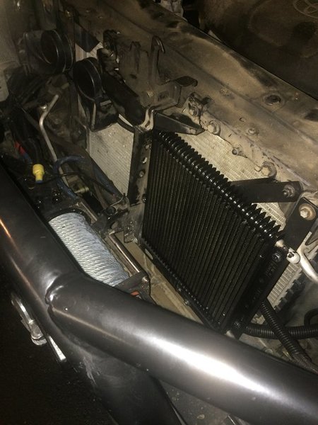

  10. Aug 25, 2015 at 6:02 PM
    #390
    tacoma16
    tacoma16 Well-Known Member
    Mar 15, 2011
    #53109
    11,165
    Peter
    Ontario
    Double cab SR5 4x4
    image.jpg image.jpg S
    Finished installing the Hayden 679 teams cooler. Will be hooked up tomorrow. This thing is freaking huge but I didn't have to drill any holes except for relocating the horns. If I didn't have the winch I could have relocated using the satoshi methods, but no room. This cooler is not zip tied but bolted. Should be a lot stronger and have no chance of wearing out.
    Crom, DoorDing and 07 sport 4x4 like this.

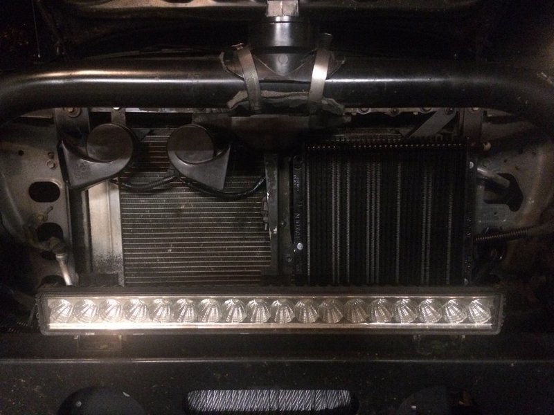

  13. Aug 29, 2015 at 7:25 PM
    #393
    tacoma16
    Mar 15, 2011
    #53109
    11,165
    Peter
    Ontario
    Double cab SR5 4x4
    This is quoted from my build. It's not detailed but it shows a little bit how to mount a Hayden 679 cooler on a second gen without using zip ties
    DoorDing and Crom like this.
