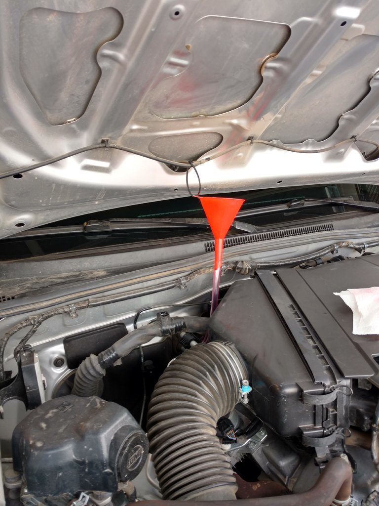

    Did the flush this weekend on my 13 which has approx. 78k, I did it slightly different than others in this thread have.
    I know it's been explained but I will reiterate - the cooler circuit goes: transmission -> radiator -> transmission cooler -> transmission.
    I drained and dropped the pan to clean the magnets. I got 4.5 qts out of mine, I wonder if people who are getting less don't have a transmission cooler?
    Where I differ from others is how I filled the transmission, I did it sort of like the sprayer method but I disconnected the line on the engine side so I didn't have to remove the grill. There is a section of hardline that goes through the radiator support. There are two lines - the bottom line goes from the radiator to the transmission cooler, the top line is the return from the transmission cooler back to the transmission. I disconnected the top line, to the hardline I attached 3/8 hose which goes to the drain jug, into the rubber hose I inserted a narrow funnel. I used this funnel to re-fill the transmission using gravity.
    You can see the drain line in this photo, its the rubber line without a clamp to the left of the funnel.
    I refilled with 5 qts then started the engine and let 4 pump out, refilled 4 pumped 4+ (jug overflowed slightly), refilled 5. The fluid doesn't gravity feed very fast, it is probably a little bit slower than pumping it in but a hell of a lot less painful. I got around a qt that drained when I pulled the overflow.
    My thoughts on doing it this way are that you are draining after the radiator and cooler so both of these items get rinsed out as well, and feeding the fluid back through the return line should flush the bearings and planetarys - I dont know if that is how the A750 works but most auto transmissions use the return fluid to supply the bearings and gears since that fluid is the coolest.

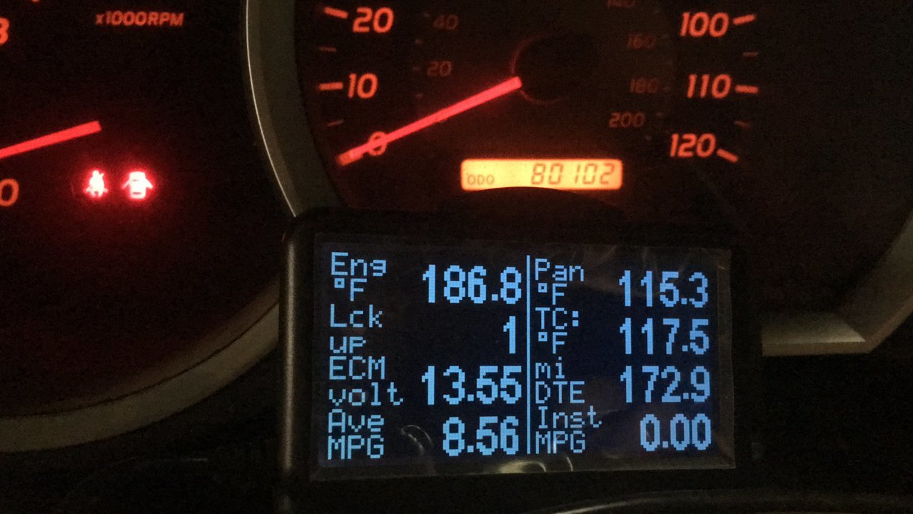

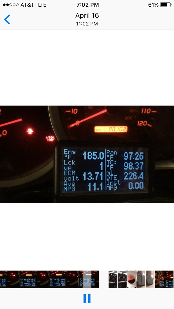

    I have the Ultra Gauge also but it shows one "Toyota Gauge" for the tranny. It reads on the Ultra Gauge list as Truck/SUV12 Trans Temp. So how do I know whether it's reading the pan or torque converter?

    Do you have the ultragauge blue? I'd guess it's reading the TC temp, my mx was only reading the TC temp when I got it. The two temps are really close. If I were you I'd get it to about 100°F and pull the check plug if you're wanting to use it for checking the fluid level. Can you put up a pic of the codes/parameters?

    I just finished my flush in a little more than 2 hours taking my time. I used the "Walmart sprayer" to transfer the fluid and an IR Temp gun to check the temperature. I waited until the transmission pan reached 115 degrees and then opened the overflow plug. At that point the fluid was 122 degrees. All and all it was a painless project.

    Your temps pretty much matched what I saw as well, oil about 7-8 degrees hotter than the pan. Need to have someone with a scan guage or with trans temp light on shoot the pan with an IR gun and compare.
