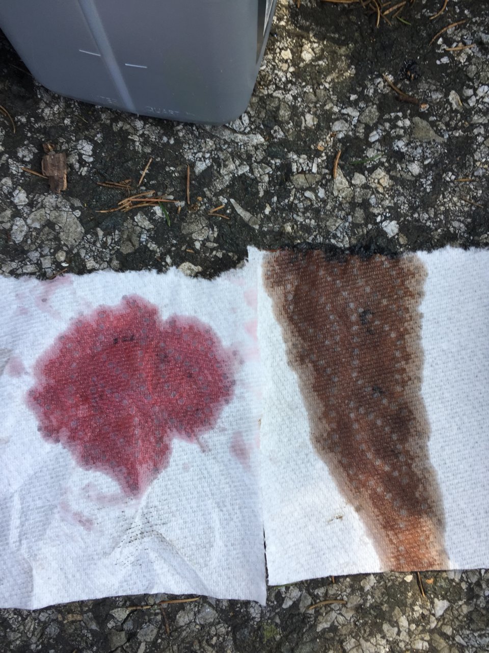

    This is what it looks like vs new fluid after 127,000 miles with no tranny service:
