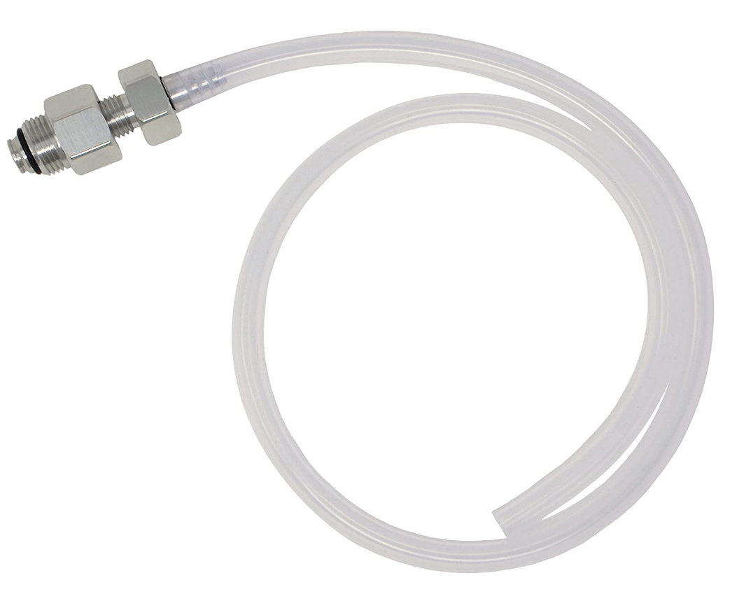

    I don’t believe many do this. It’s not a big deal to drain that reservoir. Use the plastic adapter that comes with the filter or purchase something like a Motivx.

    Interesting Idea although I will say that i'm not sure (for me) that it is worth the effort. I have a fumoto on the pan and have for years on all of my vehicles. I love them! For the filter "pre-drain" i bought something similar to what is posted above and it works great. Drains the majority of the oil from the filter housing and is really easy to use.

    be sure to grab the thread-on funnel as well!
    you'll wonder what kind of neanderthal you were before when trying to hold the funnel over the hose while also holding the oil and then later trying to balance the mostly-empty jug on top of a balanced funnel...

    This is the first I've heard of this...installing Fumoto on the oil filter housing.
    I've got the Fumoto on the oil pan as well...I will be staying with that set-up.
    I've got the drain valve/tube that screws into the bottom of the housing.

    The Motivx tools are great. The Funnel, drain tool and filter tool really are game changers.
