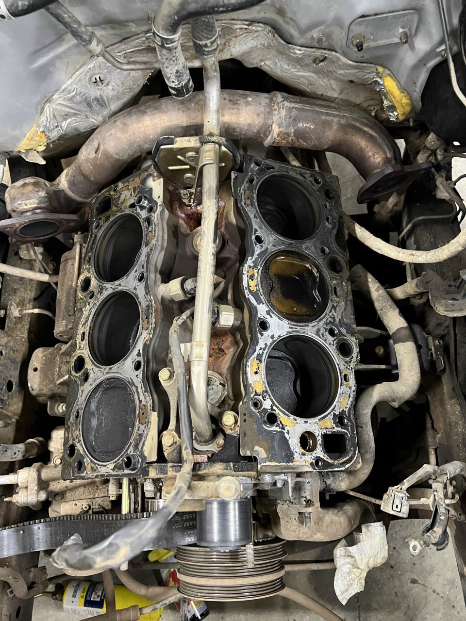

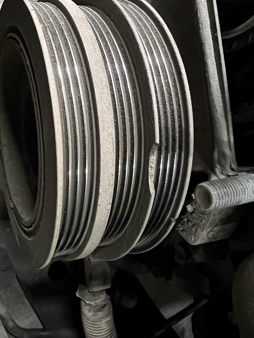

    Well, I've made it to the cylinders! Thanks again for all the advice and tips. It's been a bit time consuming, but not an onerous job so far. We'll see how the reassembly goes. So far the mistakes have been pretty cheap. A broken exhaust stud and a wire for the Coolant Sensor. I still need to finish pulling the timing belt, so there's time for things to go wrong yet. Waiting for the SST/Socket to arrive for that one. I see that one of the pulleys has a chip out of it but I may let that ride since it doesn't seem to have been an issue for the last couple years. I'll toss in a pic, so let me know if I'm off base on that one too.
    Thanks for the tips. Leaving the manifolds on was super helpful!
    Not what I was hoping to hear, but seems like solid advice. I'm not looking for an excuse to repeat this job anytime soon. The heads looked good to me but I dropped them off at the shop for a double check. I decided it's worth the peace of mind to get them tested. And with the price of these gaskets it's not worth missing a crack somewhere.

    Looks good. I would reuse that chipped pulley, my truck has the same. I cleaned the sharp edges up with a file so it wouldn’t shred a belt. That is an expensive part so worth reusing.

    The livin just started. I heard from the machine shop and both heads are cracked. Better than putting broken heads back on I suppose.
