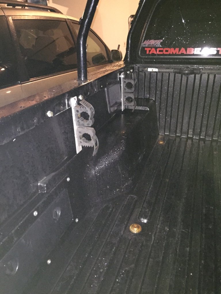

    Subbed to upgrade my benson inspired original mounts

    What size bolt for those nobs? 3/8" with 16count thread?

    Yuuup, those are the right ones :D
    I would be willing to make some for you. Are you interested in the Tool or Hi-Lift mount (or both)?
    Like I told Simon (slcsez2000), I would need to know what you want, i.e. - Single/Double Quik-Fists (one or two tools), paint preference or bare metal, Plasti-Dipped base etc. I can total up the cost for parts and let you know what they would run.
    Feel free to PM me! :cheers:

    Has anyone been able to use quick fists to mount a hilift? I ordered some but they don't seem to fit

    I have not seen it personally, but the Original Quick-Fists should fit around the Hi-Lift's shaft (not incl. the handle or base).
    The Quick-Fist are rated up to 25lbs/ea. (50lbs total) and the 60" all-cast Hi-Lift that I have weighs in @ 32lbs, so it is within tolerance.
    All that being said, I would not advise it. Due to the weight, I would want my Hi-Lift to be static and secured. The rubber on the quick-fists would allow it to move around slightly and may cause more wear/tear on the rubber straps, or increased noise/vibration from the hi-lift.

    subd gotta do this..quick question what did you use to bend the steel?
  10. Dec 17, 2014 at 5:44 PM

    Vise, pliers, hammer. Heat from a propane torch if you need help bending the steel :)

    I got lazy and didn't bother to bend them. I also used a 1/8" thick x 1.5" wide aluminum. In my opinion, it came out way better. Plus I don't have to worry about any rust/corrosion issues which is a big issue of my build living by the Great Lakes. Just to give you more options. I measured only about 7.5-8" or so, so no bending was necessary as long as you sand down the edges. 38cab39d9ccab257030c130f22345328_24d132190cf67a1f480eac96e8f0ad5519250d95.jpg
