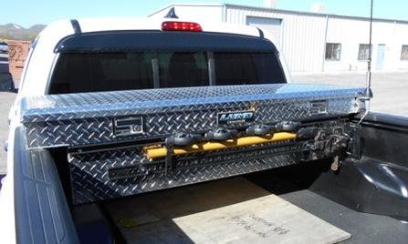

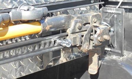

    My jack has been sliding around (rattling) in various outfits for 30+ years - won't know how to act with a place to stow it. Figured I'd fab brackets and hang it on the toolbox - 2x2 tubing on the passenger end - and a stud on the other. Backed with flat-bars. When dreaming this up - saw an outfit on a roof rack that clamped down tight with chrome lug nuts (therefore not finger tight). I got some Dorman 12x1.50mm wheel studs at O-Reillys and a cheapo set of Gorilla lock nuts (for mag wheels) - used them to build the hangers. The wheel locks have tubing (free to spin) over the nut to sort-of defeat the use vise grips or pliers. So far the jack has stayed put.:tumbleweed:
