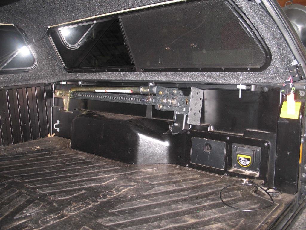

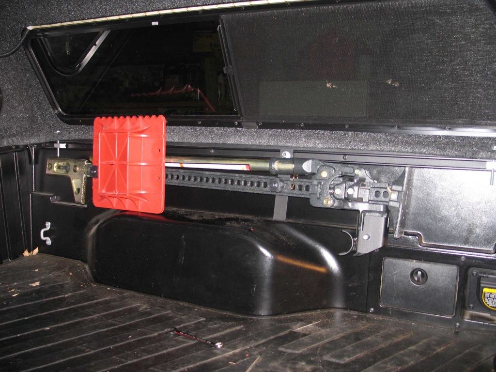

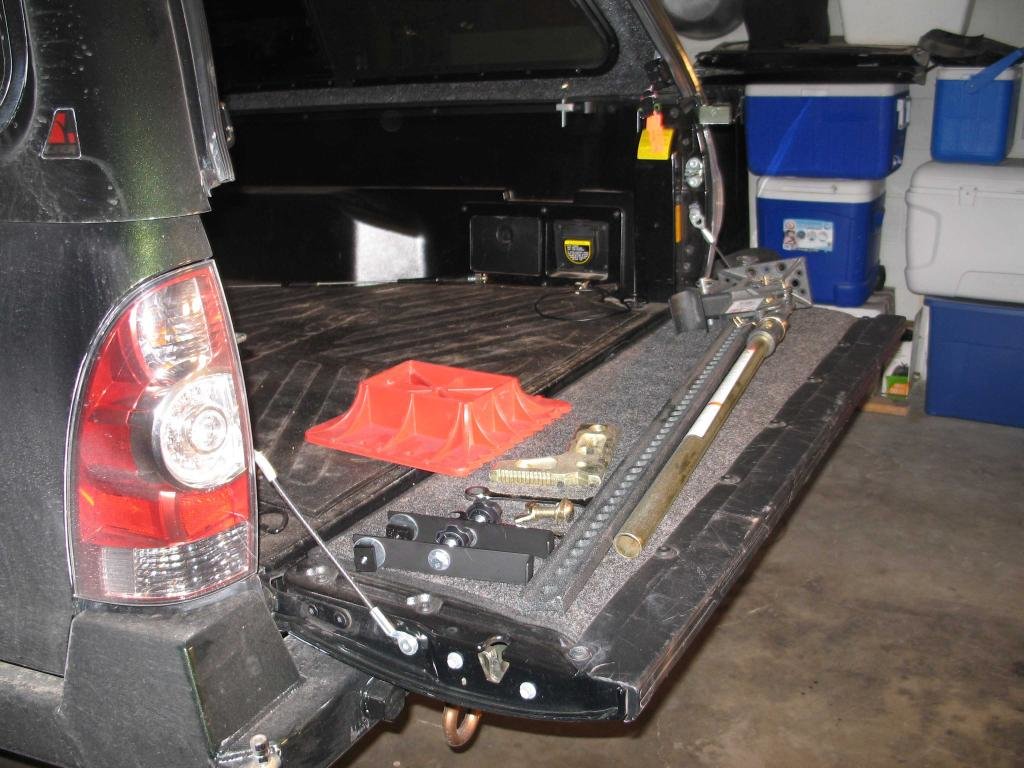

    Had the parts and finally got around to installing the HiLift Jack mount. Everything worked out as Benson X described.
    Parts
    First Install
    Looked at my mount and I have the extra large base plate and after drilling a hole in the plate and getting a slightly longer bolt I was able to put the plate in also.

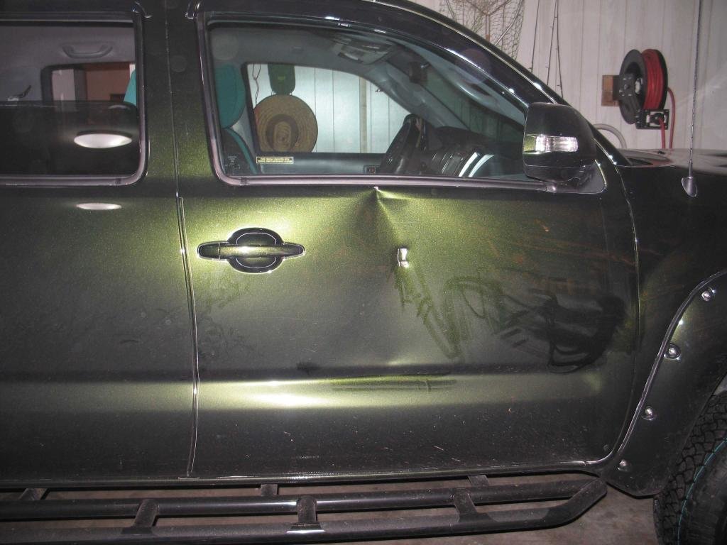

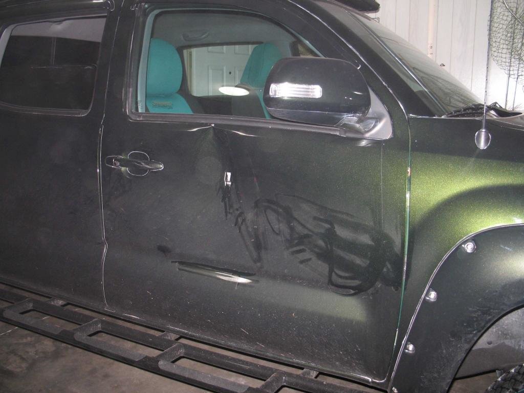

    Now for something that I have hesitated to put up. Here is how to not use a HiLift jack.:eek::eek::eek: I wanted to change a tire n January as well as try out the HiLift jack for the first time. I had the plastic base plate on and it was in the garage. Put it on the skids and began to jack it up (I am old school and know how these older types of jacks work). Noticed my angle was not quite correct and let it back down and then readjusted inward. Got it almost all the way up and the plastic base slid out and pushed the jack into the door. Quickly got out the bottle jack (it was still suspended in the air) and jacked it up enough to get the HiLift out. Finished concrete is absolutely not a surface you want to use one of these on. Fortunately insurance company had no issue with fixing it and it only required the door skin (lucky it didn't break the window or damage the internals). Even more fortunately the game warden was out of town for another week and never found out about it.:p:p:p So a word to the wise, these jacks really require a lot of care when in use, they most certainly can damage things in a hurry.

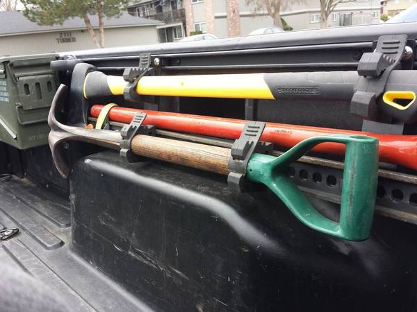

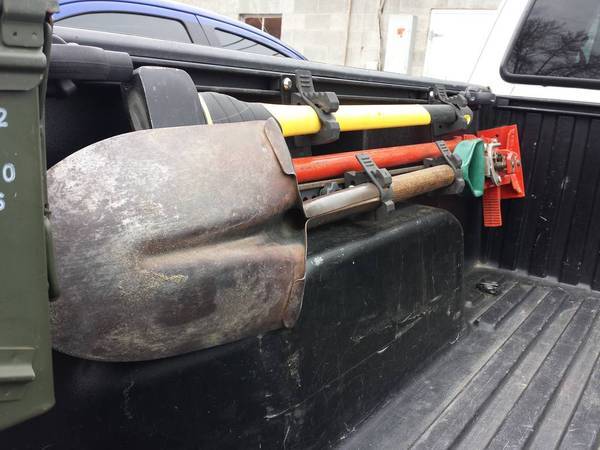

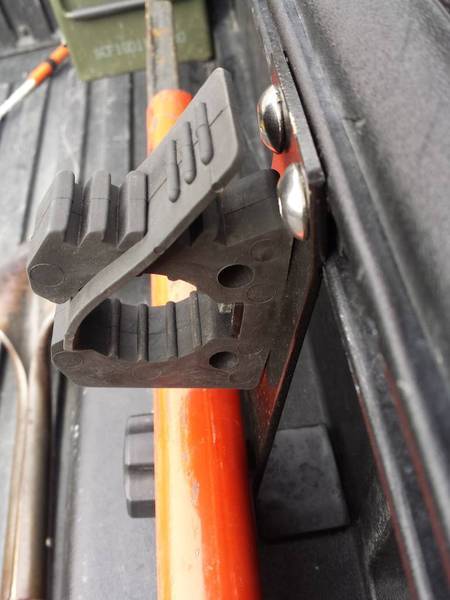

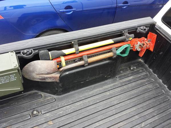

    I love these DIY threads. Not everybody's needs are the same, and I love seeing how everyone customizes their setup. I just finished my mount, so here it is:
    I'm super happy with how everything fit together. I think this configuration maximizes the space on that side of the bed. I have 2 40mm ammo cans mounted above the bed compartments on either side, and the Hi-Lift fits perfectly in the space between that and the front of the bed. I also only wanted tools on one side of the bed, as I want to mount Jerry cans to the other side of the bed. So my solution was to do a Hi Lift mount and Quick Fists on the bracket. I then used the same type of plastic knob used to mount the Hi-Lift, but instead in a 1/4-20 thread, and screwed 2 Quick Fists to the Hi-Lift itself, and mounted the Shovel to that.
    I used 2" wide steel bar instead of 1-1/2" because I wanted to use 2 bolts per bracket for extra sturdiness. Instead of the 9" total length originally specificied by Benson X for the Hi-Lift, or 9.5" for the tools, I went with a 10" total length, bent at 8". It turned out that the resulting 2" spacing allowed the base of the Hi-Lift to perfectly clear the "shelf" of the bed. It also was the perfect distance for the shovel to fit flush with the wheel well. Instead of a stack of washers, I just bent out the top of the brackets, which angled the whole setup.
    The shovel covers up the head of the axe, which is a nice safety feature, and the entire setup fits below the bed sides, so you could probably use a tonneau cover with it, and you can also still use the bed cleats! I'm thoroughly pleased with myself on this one.

  15. Mar 21, 2015 at 9:14 AM
    #275
    rubenc87
    rubenc87 Cobra
    Feb 2, 2009
    #13214
    1,862
    Texas
    2025 Tacoma TRD PRO
    Really nice work.
  16. Mar 21, 2015 at 6:59 PM
    #276
    AR15xAR10
    Apr 13, 2013
    #102024
    57,183
    2013 TRD Sport 4x4 V6 ACLBFTMFW
    Your knob is so slick Ben! :laugh:
    Seriously, all jokes aside, thats flippin badass!!!

    Seriously awesome job, man! Glad this inspired you to make it your own - that is such an effective use of space!
    Well done! :cheers:
    :rofl:
    It is pretty slick....it's also bigger now, so I can get a better grip on it. ;)
