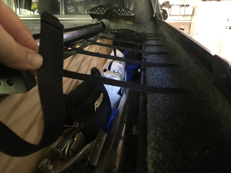

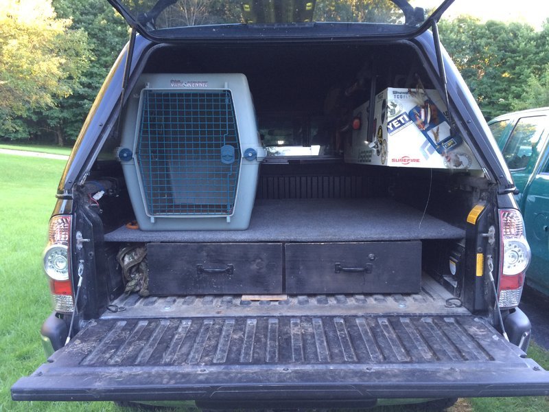

    Exterior: OME lift, Cooper Discoverer S/T MAXX 255/85R16, ARE MX cap with tool box, Thule bars with kayak racks and maxtrax mounts, DYI drawer system, cut and shaped mud flaps. Interior: WeatherTech floor mats, misc patches.
    This is my setup. Still figuring out how to carry the hi-lift.

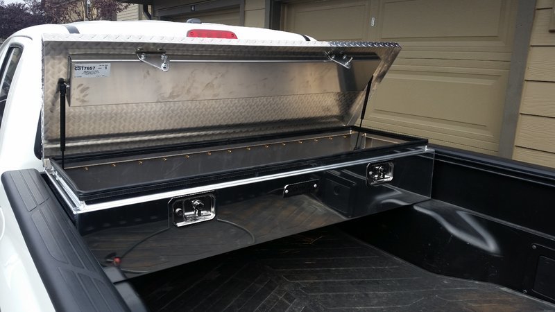

    There is not one solution for everybody but this is what I will be using. It is a custom ProTec RV box. Stock length was 60" had them make it 56" for me. Exact dimensions are 56" long (from one side to the other)x 10.75" tall x 20" front to back. I did not want an over the bed rail or one to go below wheel wells. This is on a 2nd gen short bed.

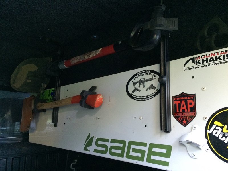

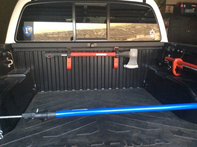

    A old temporary set up I had when my front runner rack had cracked. I did make a box out of it. Was able to fit one more ammo can and enough room for all my straps.

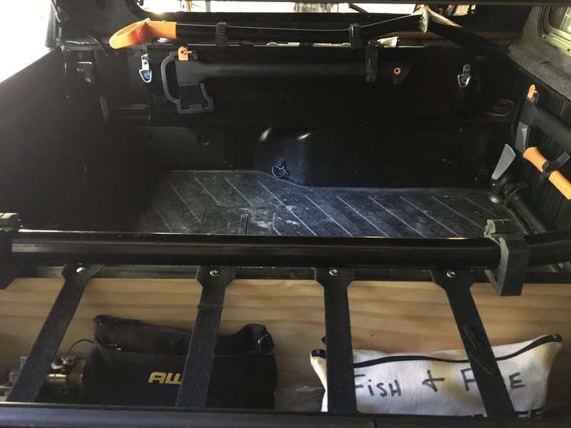

    RokBlokz Rally Flaps Toyota running boards

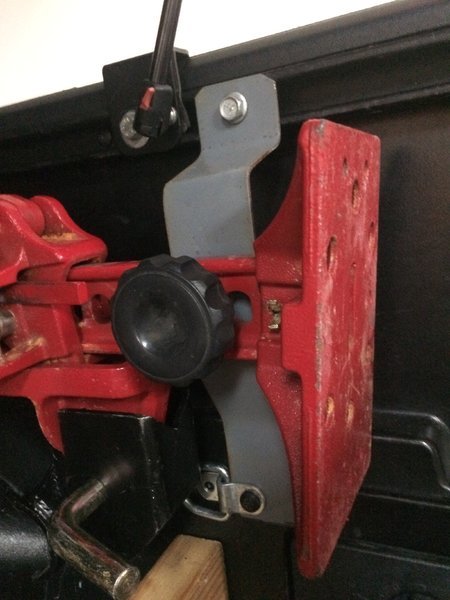

    Made my tool mount today following the directions posted with a couple slight modifications. First, I started out with the bars 1/2 inch longer than specified. I made an extra bend with this extra 1/2 inch to give some additional area for the bottom part of the mount that rests against the side of the bed. I just thought the extra area would prevent the bracket from wearing as much on the bed.
    I was going to use two sets of the standard Quickfists, but when I tried it out with the ice scraper on top, these would not hold the scraper tightly. I swapped out the standard Quickfists for the Minifists that were included in the kit I purchased. These worked perfectly for the scraper.
    Thanks for a great idea for these mounts. Your plans were spot on and making these was much easier than I expected.

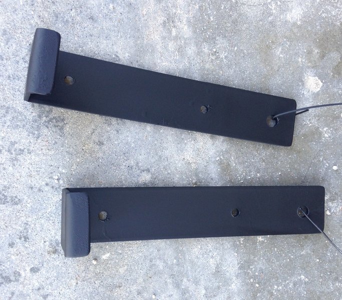

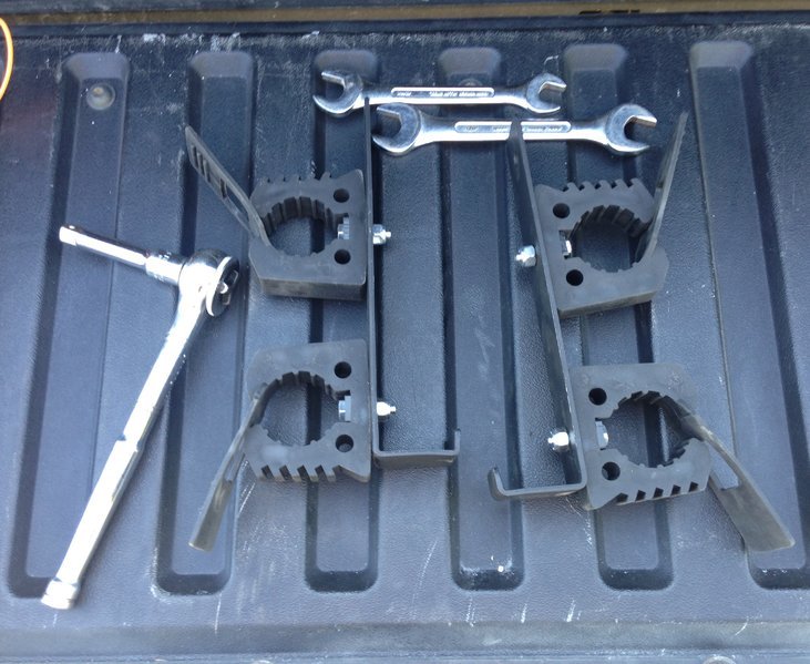

    Thanks for the write up! Here's what I put together with your idea and some junk I had laying around. I modified the design a little by adding a third anchoring point for a little extra stability. Free ftw!

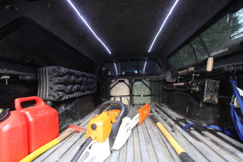

    Holy orange handled awesomeness! That's a lot of fiskars. But not to much stuff, at the moment I have 2 shovels, 4 axes, 2 machetes, 1 maul, and 1 hi-liftill post some pics after I finish cleaning the truck out this weekend.

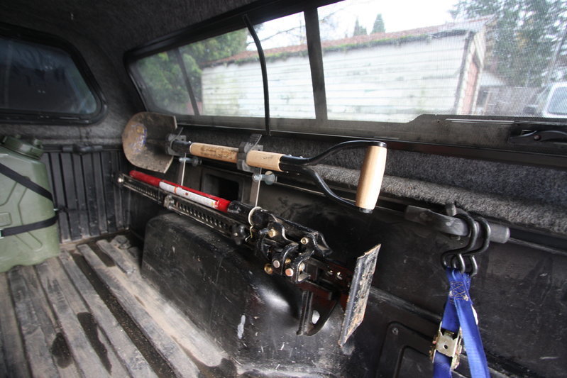

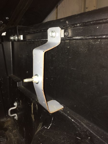

    I finally did this recently, with a few modifications. I haven't painted them yet though! I may remake the brackets so I can add my splitting maul in there somewhere as well.
    I did the same as @Realoldfatguy and made that extra bend at the bottom. I also set mine away from the side of the bed by about 3 inches to accommodate the shovel, hilift and my canopy. I also only used 1" flat bar (all I could find) but it worked out great as i made a few short pieces with holes drilled in them that slide down the tracks perfectly! So if you can't find those T slot thingers, it's a cheap and easy option. I'm super pleased with the results! much better than my previous set up! Thanks for the inspiration @Benson X !!!!
