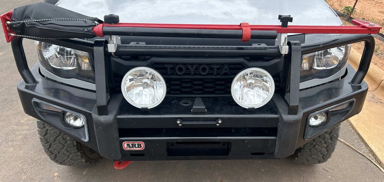

    is front bumper the best place to put hi lift 60?
    mine is there. Easy.
    however, some thoughts
    1. Hi lifts are not tight. Unless I rig something up, it has resonant frequency vibration on takeoff. The crank has no FluidAmpr to stop that. Annoying.
    I am debating utilizing my bed rack somehow. Maybe I can find a way to keep it chest height so it’s accessible and low. Hopefully that doesn’t hit a tree.
    because high up means
    -weight up high, higher center of gravity
    -hard to access and use it
    I put bungies on the foot which did reduce the resonance a good a mount but not all the way.
    not to mention other potential concerns like where the jack would go if somebody hit the truck.

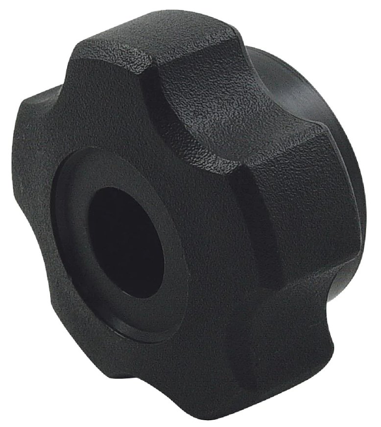

    I have a Hi Lift mounted in my Jeep. I keep the foot off and stored separately. Have a quick release pin so it’s quick to install. I have the handle keeper from hi Lift (somebody makes on me that has a little piece that compresses at the bottom of the handle). Mine is screwed down with knobs and usually doesn’t make a sound.

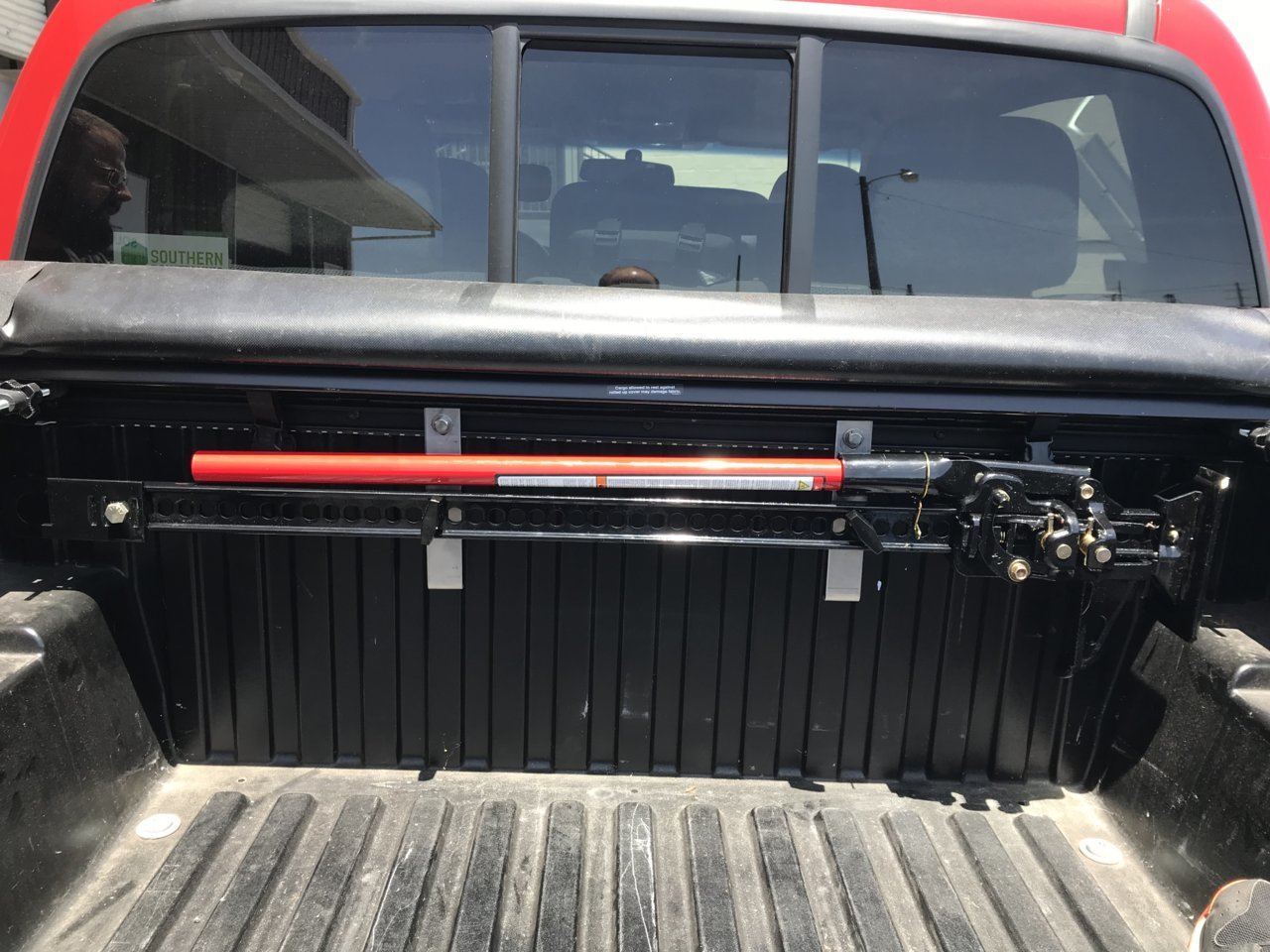

    The 60 fits perfect along the bed rails in the bed.
