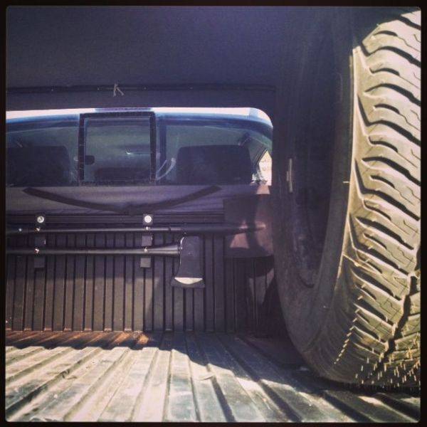

    They probably do. I don't use them daily and will probably not need them for 90% of the time I go camping. I do want to find a way to keep the sheath on the axe. I might just take some of my Wet Okole neoprene and make a boot for it.
    I don't live in the best of neighborhoods so I thought it would take a dipshit with no education longer to figure out how to unscrew a wing nut then to disconnect a quick fist. That is also why i mounted them in the front and not on the side. Its easy for 1 individual to just reach over and take it. At least this way if it's one person they would need to either walk around or get in the bed.

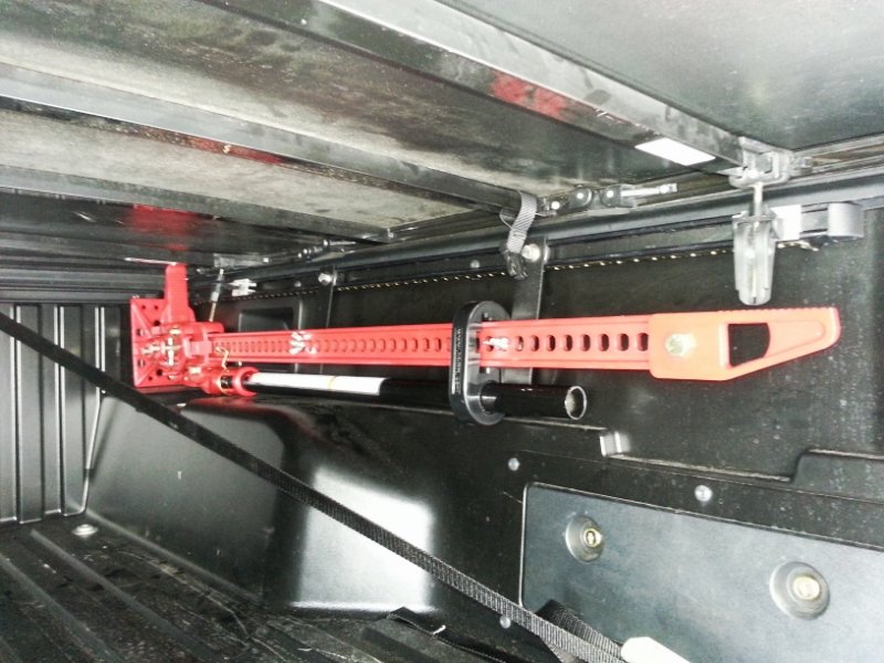

    I found out the hard way.....lol one extra trip back to the vice. Didnt want to sound like a bitch after overlooking t-nut link. Here's a finish pic. Drill dimensions worked out fine. Thanks again[​IMG]

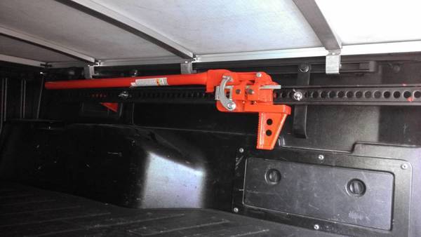

    I built and painted mine on friday, Plasti Dipped them on sunday, and installed them on Monday. Great write up if was fun and easy! My high lift-extreme was a bit too long so I chopped off 3.375 inches and now it fits perfectly in my short bed. All I used to cut it was a hacksaw and a truck load of elbow grease.

    Well I finished mine the other day and I had to modify the height of the bolt for the lift. My tri-fold cover was causing all sorts of issues but after lowering the bolt (making a whole new set of brackets) everything works great. I changed the bolt height by 1" and it sits just above the bed shelves.
