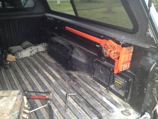

    Anybody know what size the base for the t-slot nut should be in order for it to slide into the rail? In other words, how wide are insides of the bed rails?

    lol, a quick trip to your truck with a tape measure or ruler should give you the measurements. :p
    Anyway, the BASE of the T-Slot Nut is 7/8" wide (tall when inserted vertically), and leaves a little wiggle room. up to 1" should be fine.
    And here is the dimensions from Grizzly (comparable T-Slot Nut):
    A: 0.55"
    B: 3/8"-16
    C: 0.83"
    D: 0.34"
    E: 0.25"

    Another option to the T nut are these..
    I've got my toolbox secured to my bedrails and two eyebolts that I use as tie downs using 3/4" extruded speed nuts. Found them for $1.30 each at my local True Value and they work really well.
