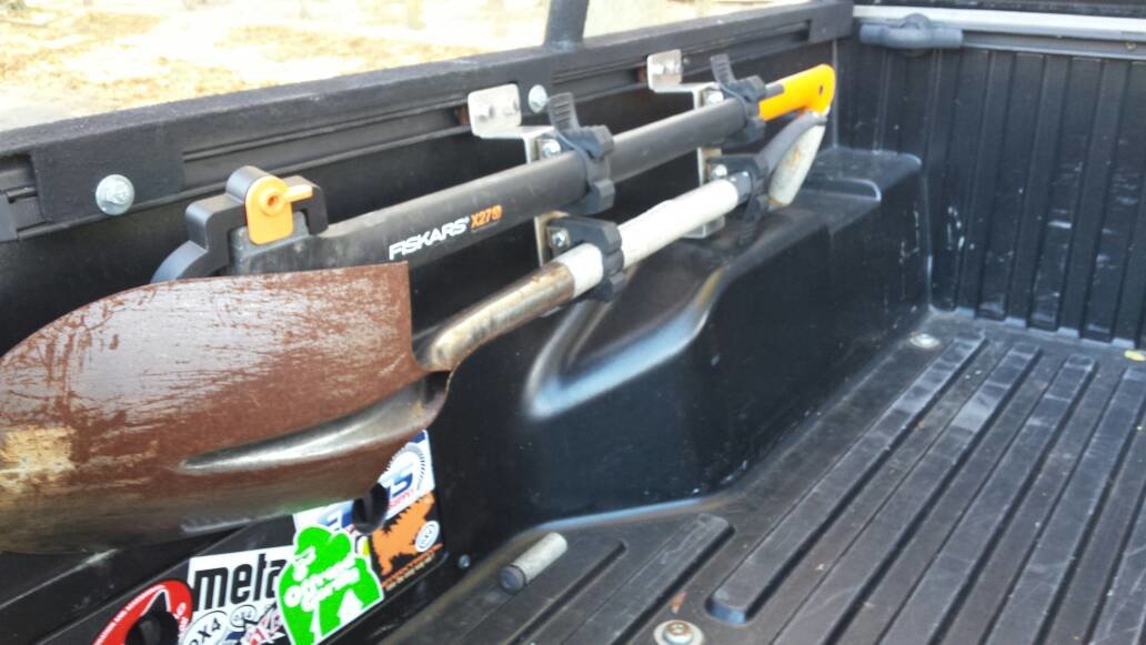

    Modified mine yesterday....now the axe and shovel are together :D

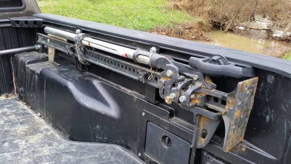

    I made a set of tool mounts and Hi-Lift mounts for my TWSS "Giftee" this year.
    When I was piecing everything together at Lowes, I found some great heavy-duty, through-threaded knobs to use instead of wing-nuts.
    I need to go back and grab a couple more for myself, but these are a great alternative to wing-nuts to tighten the Hi-Lift on the mounts - much easier on the fingers and makes it faster to install/remove.
    I will post a pic of the actual part # and update the OP when I get a couple more, but it is a 3/8-16 HD Knob.
    Here's a link to Lowes' site: http://www.lowes.com/ProductDisplay...gId=10051&cmRelshp=req&rel=nofollow&cId=PDIO1
    Stock Pic:
    jwinky's new Hi-Lft mount:
