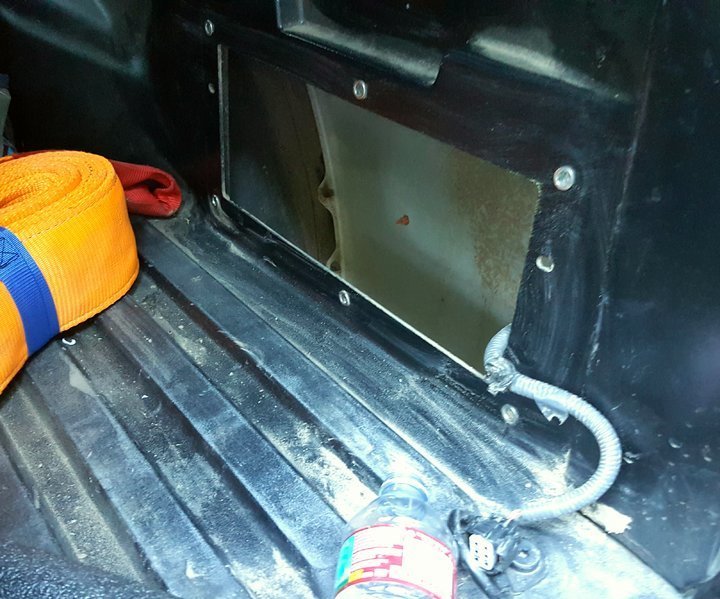

    I've gotten really tired of dust collecting inside my bed's cubbies, and subsequently getting inside my bed. It's impossible to keep anything in those cubbies as it all gets covered in a metric fuckton of dirt (for you 'muricans that's about the size of a Big Gulp) within five minutes of being off road.
    1. Pull the cubbies out. Each one is held on by six T30 torx screws, and the passenger's side has a wire running to the bed outlet - push on the clip in the right spot and it slides right out. The wire is also held on by another clip below - pull, wiggle, apply some force and it'll come out.
    This is what mine looked like:
    Ain't they purdy?

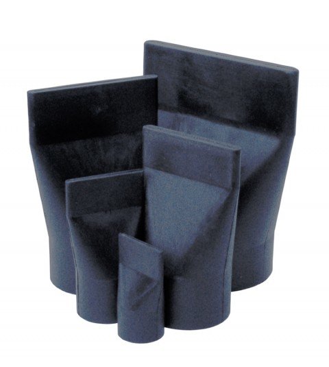

    I would suggest a duckbill drain valve in place of epoxy in the drain holes.

    I'm a DA...what's a duckbill drain valve?

    A rubber one way valve that looks like a duck bill. Usually found on ATV air boxes or small engine gas caps. LARFLEX_check_valves_73M.jpg

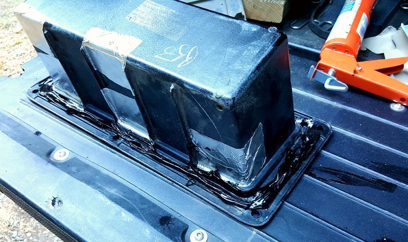

    I used metal tape and black silicon. yes that's my sweat and tears metal tape will cut you ,

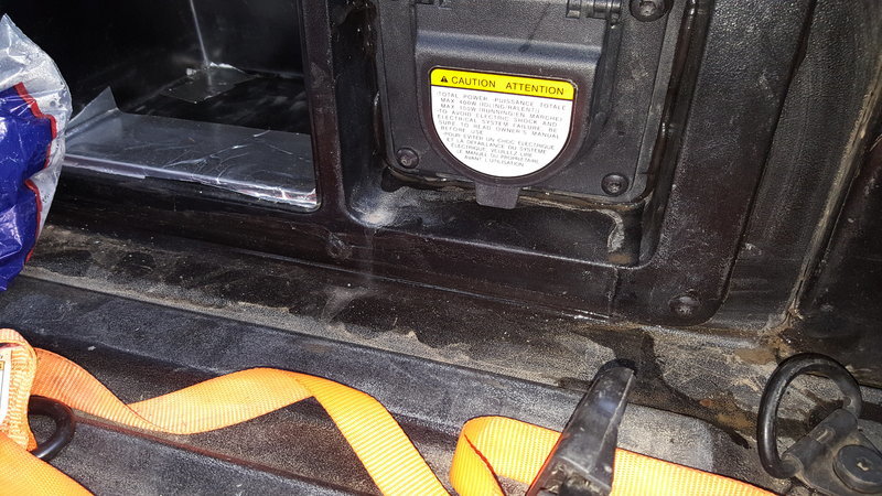

    Look like I have to reseal the 101v plug area

    I just popped off and resealed the 110v plug, it looks like I missed a few holes where water would pass by. a tube of black silicone liberally applied to the rear of the plug insert hopefully will do the trick
