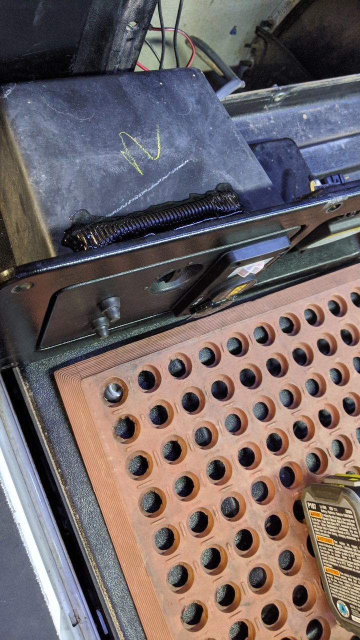

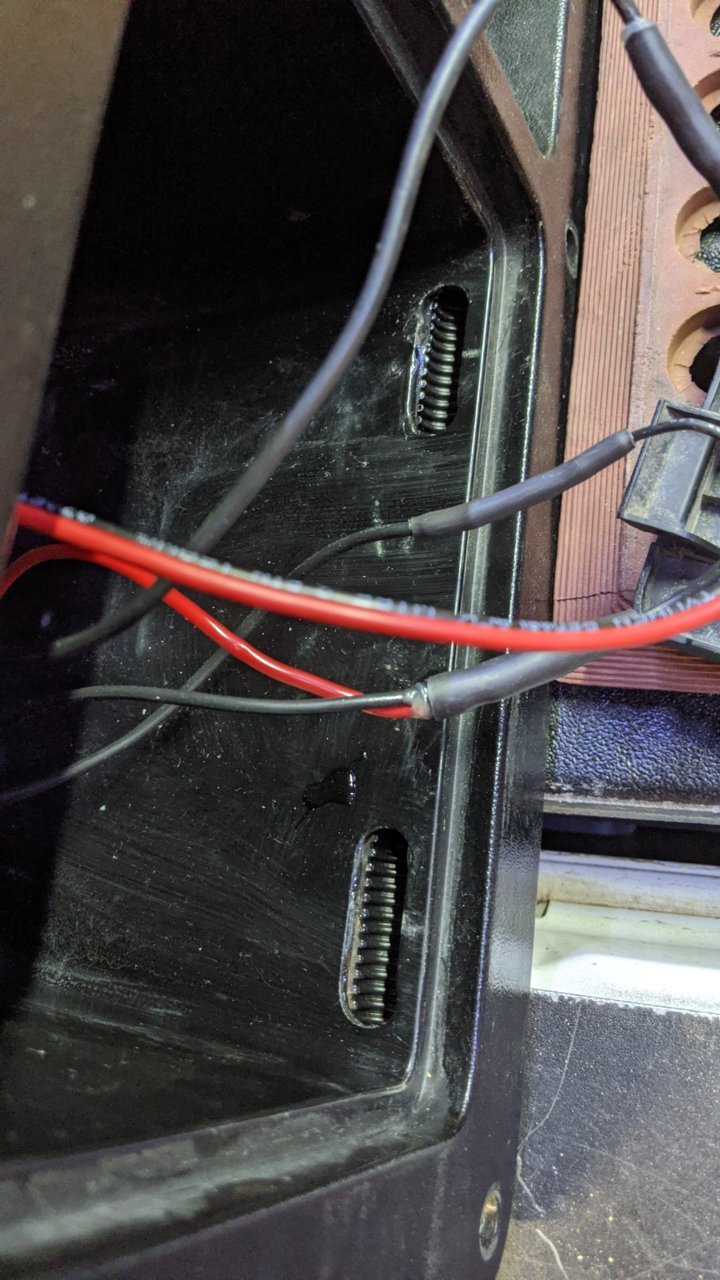

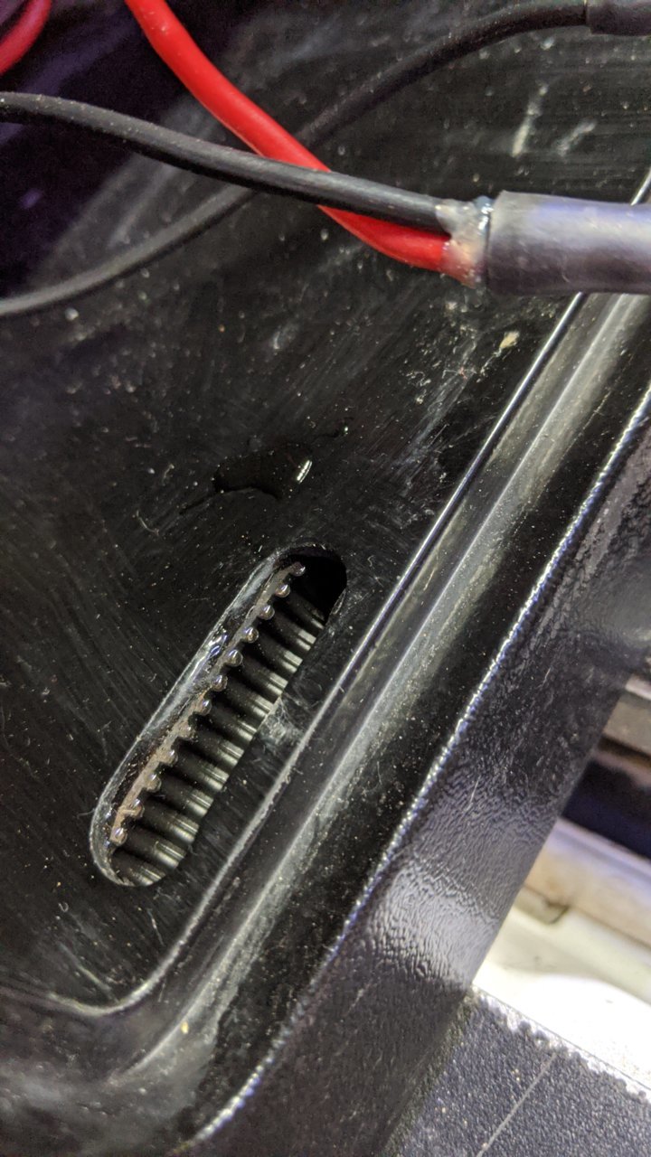

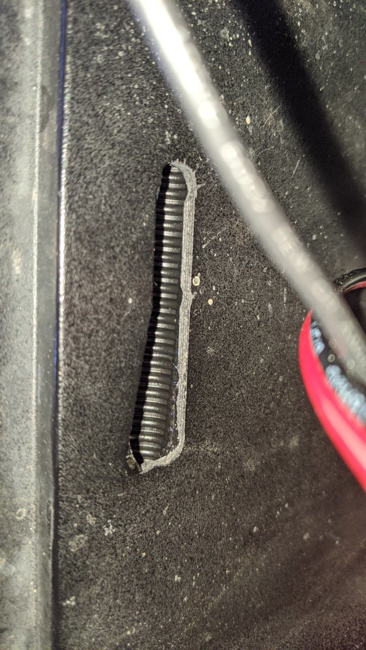

    Tape applied "flat" over the hole would get in the way of the tabs that go into those holes from the door piece - thus the need for something that "wraps around" those tabs. ie. the loom.
    In my (seemingly never-ending) attempts to fully weather-proof the bed, I plan to take out the cubbies again and apply weatherproofing on the edges where they meet the bed, to prevent any dirt from getting in through there.

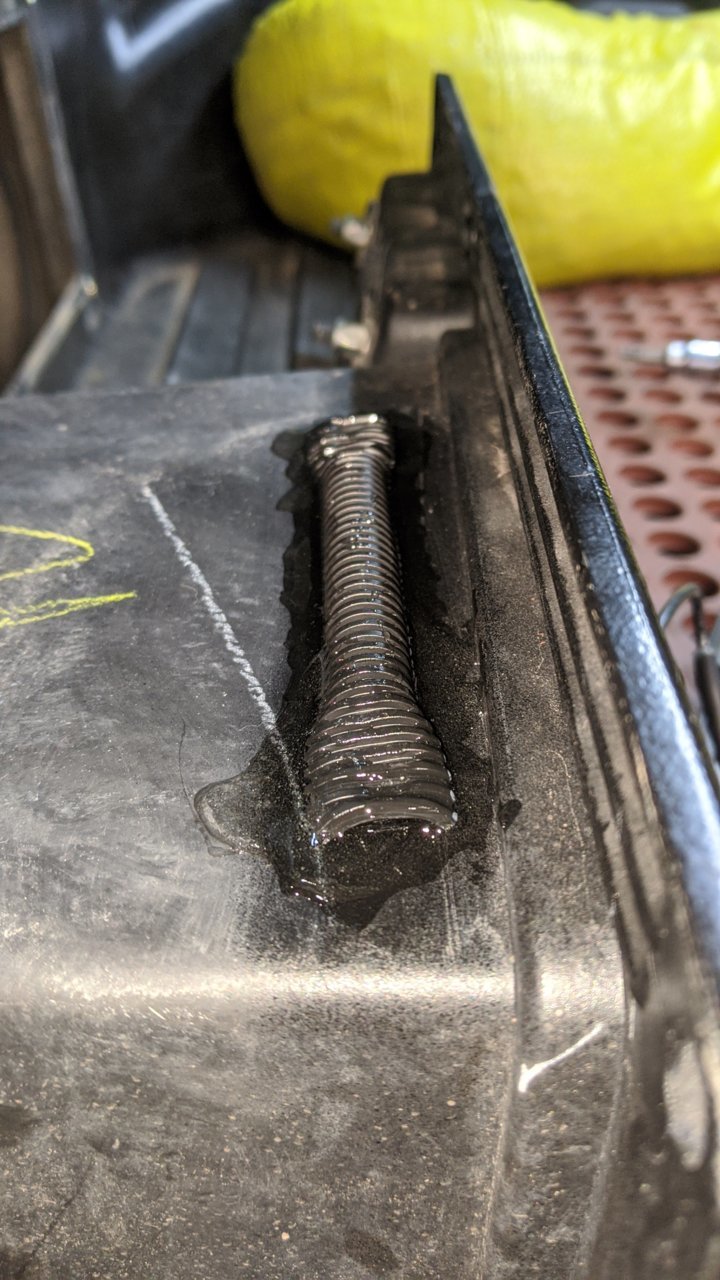

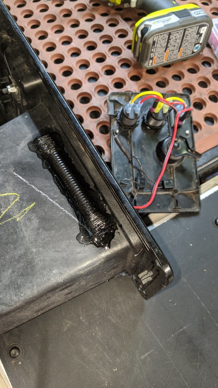

    Resurrecting an old thread, but wanted to say thanks to the OP for the idea. I recently installed a blue sea sub fuse panel into my small cubby to facilitate some new lights and needed a way to keep the elements out. I used some spare wire loom and plastic epoxy to seal up the tab holes.
    The only thing I did different was I cut the loom a good inch longer on each side compared to the hole I needed to cover up. Then I heated up that excess on either side and pressed it down to give me a nice, flat surface to adhere to with epoxy between the loom and cubby. Made for a clean seal all around but still gave the tabs room to fit.
    Appreciate the idea! Last step is some 1/8" weather stripping to enclose the cubby door...

    So I just went out to my garage and gave this a go, I was able to plug up the drain holes (because those are easy). But the loom was a pain in the butt! I added more hardener to my epoxy to make it cure faster and even that didn't do it. The loom kept curving upward, and even when i got that done, i couldn't build up enough to cap off the ends of the loom to really seal it off-the epoxy was too fluid. Any tips?

    More hardener will not accelerate the curing - too much will cause a mess as the mix will not cure... (the mix ratio should not be changed)
    Runny epoxy can be thickened with a thickening agent (Cabosil, etc.)...
    Good luck!
