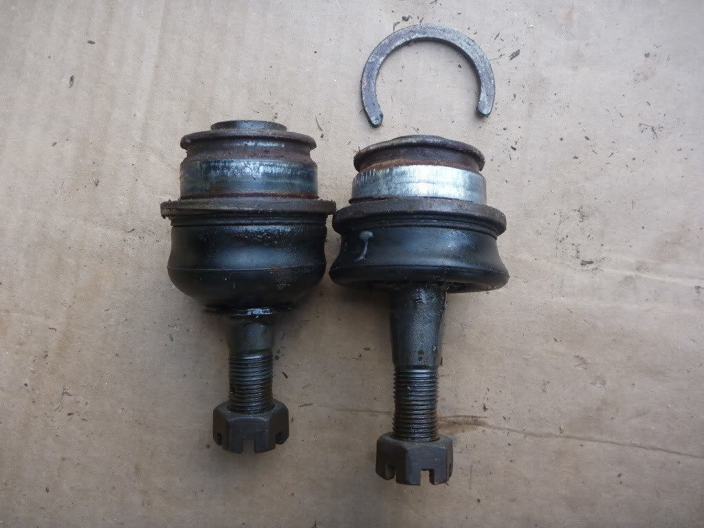

    Hey OP can you tell us how you know when to replace your ball joints?

    I had multiple knocks coming from the front end. Boot to the BJ's was in bad shape and the grease looked like chocolate milk and leaking. I think I have pics in my build :notsure:. I got by for a few months by shooting grease into the boot via a needle valve, but this is only a temp fix as the hole for the needle valve just made the leaks worse. If you are not having the same visible issues you can disconnect the spindle/steering stop from the BJ you can feel if it has any play in it. If it does have play they need to be replaced. If the boots are cracked and leaking they need to be replaced. I chose to also do my tie rods at the same time because they were also cracked and leaking with the same chocolate milk.
    You got my number so if you have any other questions hit me up.
    Shamal, lo2hi and Crom like this.

    I also still have the old ones so if you ever want to feel what they feel like when going bad hit me up
    Shamal and Crom like this.

    Thanks Boyd. I would say I'm a far way from being as bad as yours were, but I think I'd like to do them before driving to Moab.
    If you jack the truck up so the tire is off the ground and try to wiggle the tire, you should be able to feel play if the ball joints are bad right?

    welp it depends on what direction but if you feel slop doing a test like that it could be many things. LCA bushings, steering rack bushings, wheel bearings, UCA bushings, tie rods, etc.
    Best bet is to isolate the play by checking each part. Also helpful to have someone in the truck with it running and check the wheel play. I would assume A set of eyes on the parts checking for play with one person behind the wheel seems like it would be best...not sure as I inspected each part by itself.
