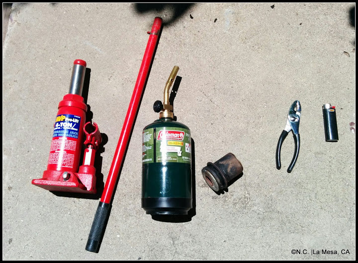

    I pressed four (4) Lower Control Arm Bushings in 40 minutes.
    If you plan to keep your Tacoma for a while, you will ultimately face the question about what to do with LCA maintenance.
    I have never installed or removed rubber suspension bushings before, until this weekend. I pressed four LCA bushings using a bottle jack, and propane torch. Using this method is about the closest thing to magic there is. Other methods involve burning them out, pressing them out, cutting them out, all of which are in the realm of "very-difficult-pain-in-the-ass task"
    The Tools.

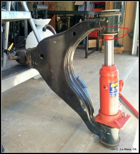

    The setup. I need to explain this a little bit.
    The bottle jack is placed between the arms and mild / medium pressure is exerted on the rubber bushing. The bushing is a soft rubber and it will "give" and stretch in the opposite direction of the bottle jack. I laughed and had fun doing this. I applied jack pressure until the silver end of the bushing was about 1/4" from the LCA. I wasn't scientific about it, and most of it was just intuition and feel.
    I then heated the LCA "eye" with propane torch, moving the flame around and heating as evenly as possible.
    The bushing begins to smolder right before it releases from the LCA.
    When it releases the pressure, it can make a thud noise. Only one of my four bushings did this, the others were more quiet.
    It took about 2.5 minutes of heat in my case to release each bushing.

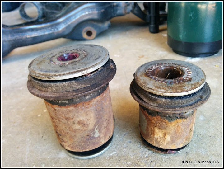

    Bushing has been released.
    Good bye.

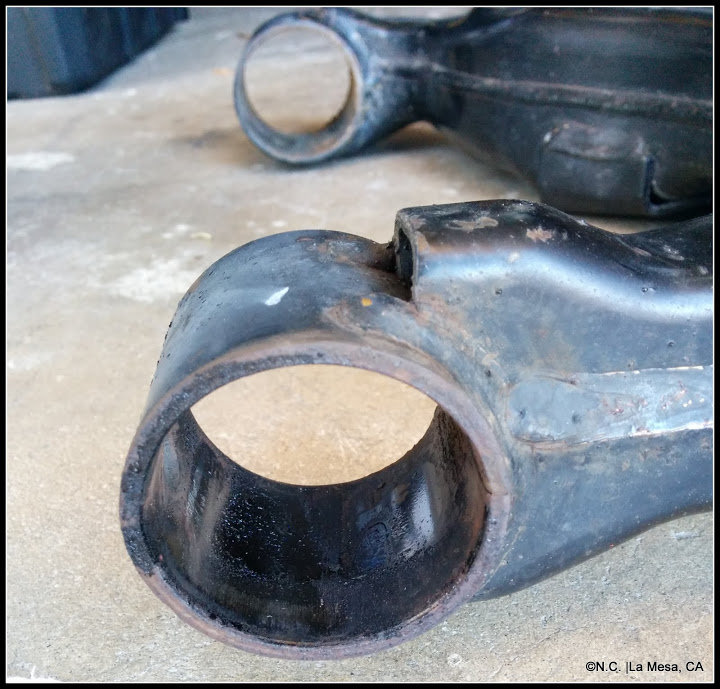

    All clear, ready for new bushings.
    Not my video. It's a great example of how to do this.
    https://www.youtube.com/watch?v=JZ5BMfkuHlM
    Use common sense and safety precautions. Wear eye pro., heavy gloves, have fire extinguisher ready, clear area of combustibles, etc. Have a phone ready to dial 9-1-1. :p :D

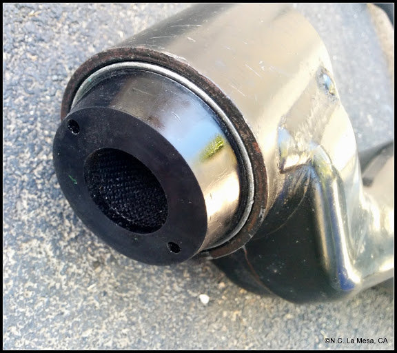

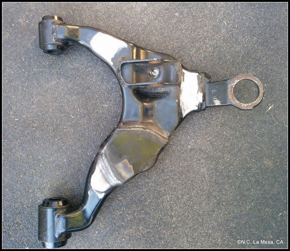

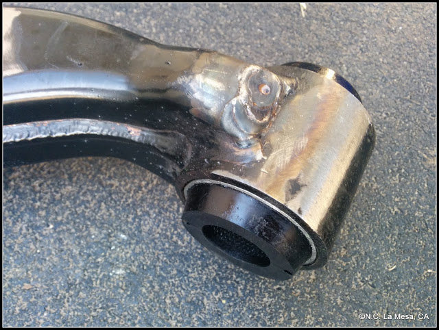

    I am super excited to report that Whiteline W53312 Front Control Arm Bushings fit in the Tacoma LCA!!!
    I had these pressed in about two weeks ago.
    I'm so stoked!
    I also had a welder weld shut all the drain holes, and weld shut the gaps where the arm connects to the bushing eye.

    for anyone who welds, after pushing the bushings out, is a great time to fix any cracks where the eye is welded to the arm, or even wrap the entire eye, without melting the new bushings going in.

    Yes! I'm going to have all the drain holes in the LCA welded shut too. :thumbsup:

    yep, plug weld the little bastard, and then buff it smooth on the inside with a flap wheel on a die grinder.
