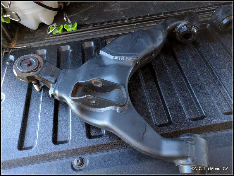

    There is no problem with fitment. The bushings fit perfect. They must be pressed in with a shop press. I paid $40 to someone for this service.
    I am in no rush to install, truck is not my daily driver anymore and when I swap LCA's I'm doing additional work in there, and need more parts.

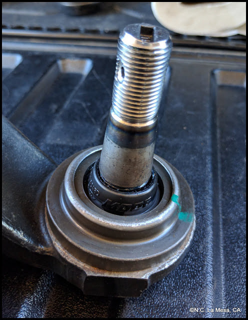

    Last week, I just had new Moog K80827 BJ's pressed in by an auto shop. $22.50 for both BJ's. Pressed perfectly. :)

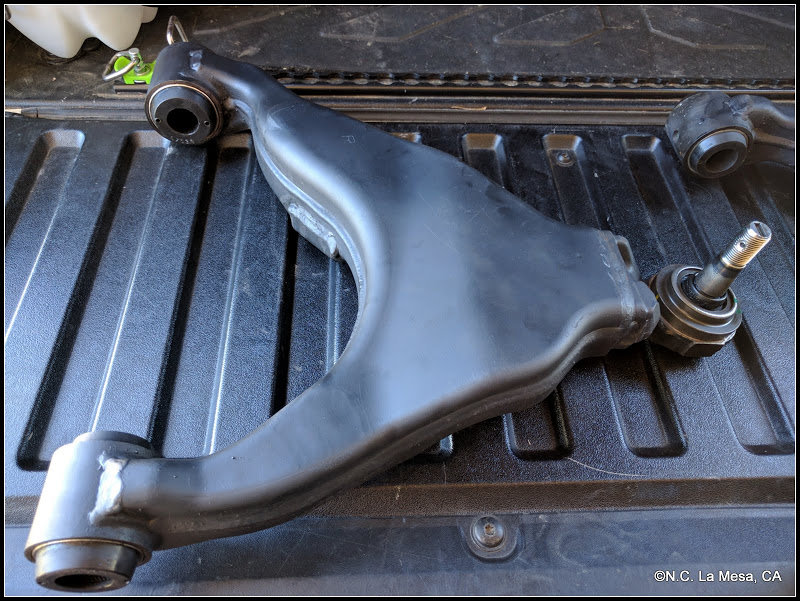

    Welder closed all the drain holes and reinforced a few things. and this was after first coat of paint.

    Welding it shut is primarily to guard against corrosion and to make stronger. I had the welder gusset the arms where they join to the bushing eye and fill in a large gap that the factory put there. Also had him run a bead around the bump pad to add strength there, and close up any air gaps.
    None of this is really necessary for most rigs. Mine is built for off-road endurance and I'm just trying to stack the deck in my favor. ;)

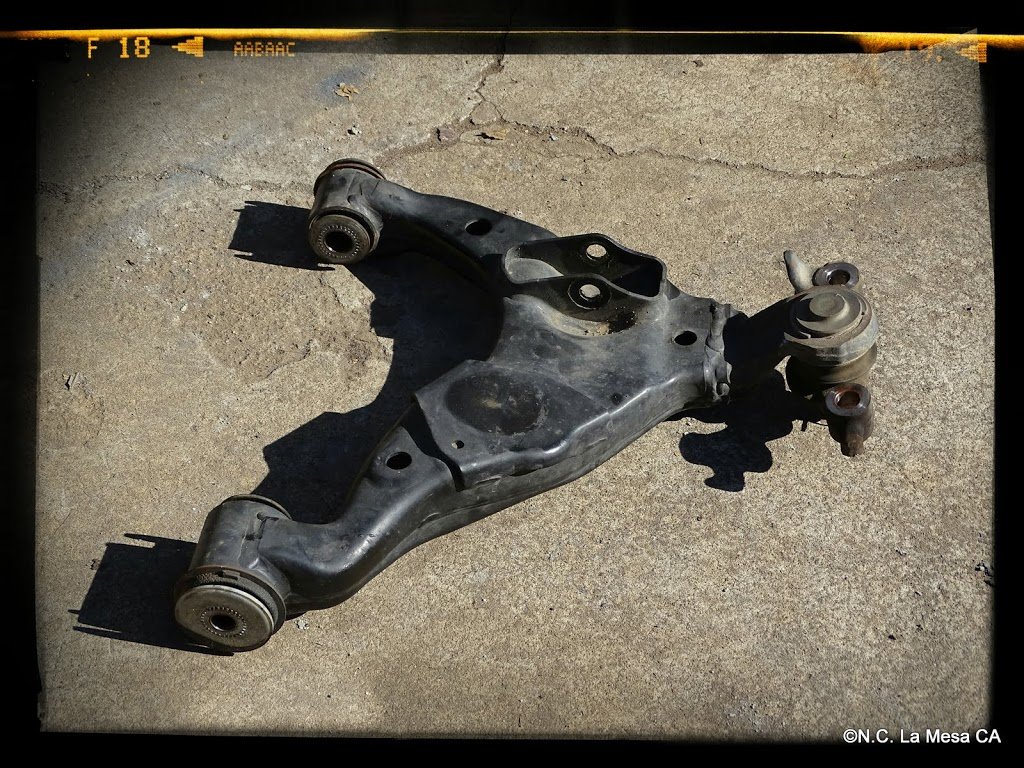

    That's because this kit fits more than one vehicle. You must use the right parts in the right configuration for Tacoma.
    As I stated before, if you take notes of your factory arms when disassembling, you can't go wrong when putting it all back together.
    Yes. I can illustrate with photos.
    Pictured below is a Toyota second gen passenger side arm as viewed from the back side.
    Notice the LCA bushing holes are of different size? Take note of that.
    Smaller bushing sleeves go in the rear new poly bushings, larger sleeves go in the front poly bushings.

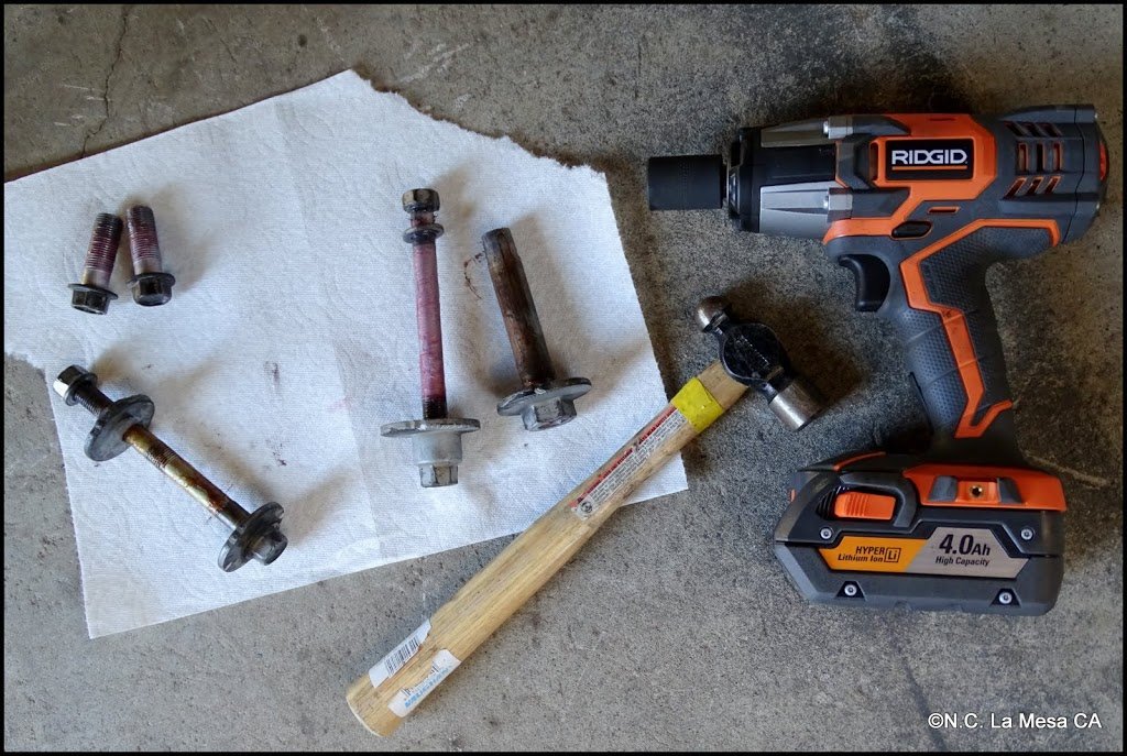

    This will all make sense when you see the bolts and cams that come off your truck (also pictured below).
    Associated hardware pictured.
    • Bolt on left goes in the rear bushing.
    • Bolt and cam sleeve, in the right of photo, go in the front bushing.

    Watch your boots on the Moog outers. Lots of complaints about the boots splitting in short order.
