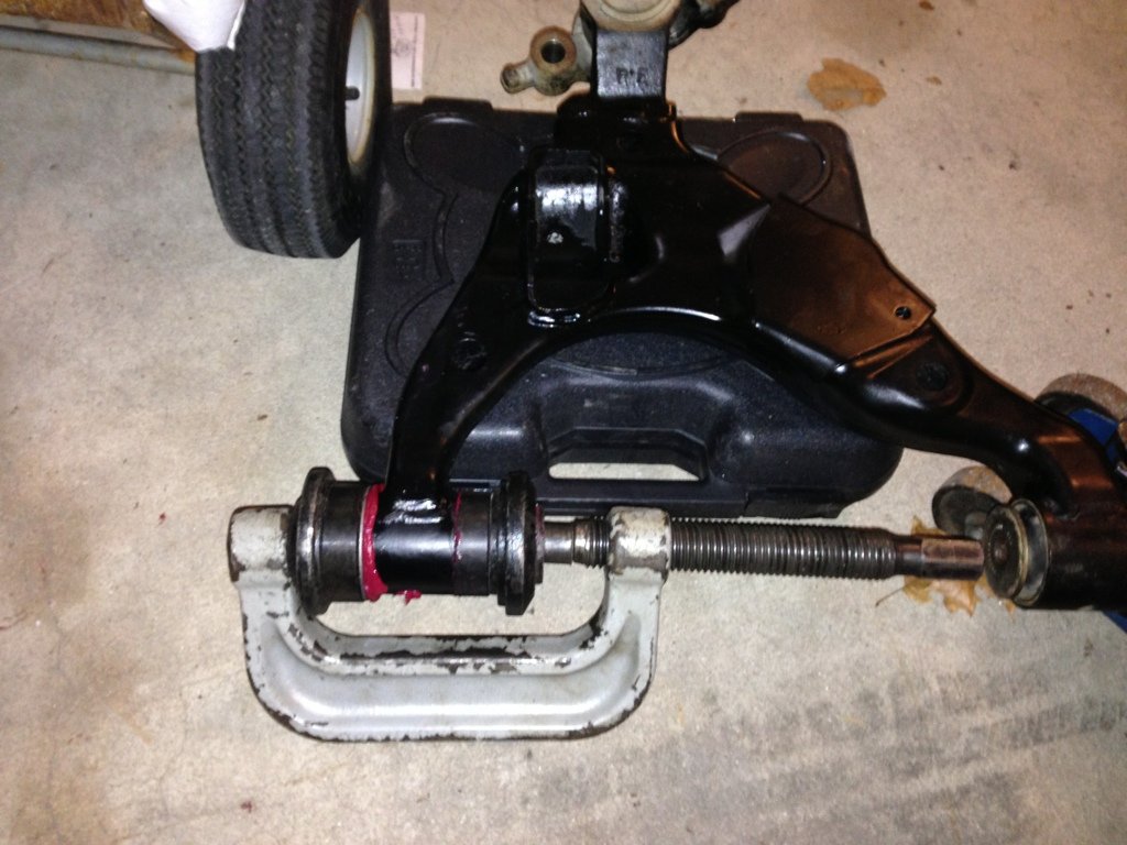

    Nice writeup!
    Here's what I used to press my new ones in. Most auto stores let you rent it for free

    I tried one of those, wasn't long/wide enough to get the larger bushing into the arm

    That's a nice kit from what I've heard. Unfortunately, my oriely / autozone don't have that one. I've asked for the powerbuilt one.. They used to carry it, but now I think they carry a brand called "OEM" lol
