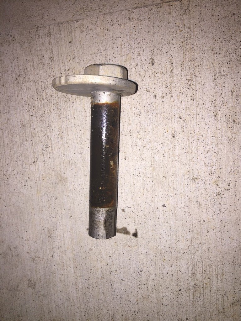

    I did not pull the bushings but I did service the cams/bolts today while installed my 5100's and coils. The front cams were pretty rusty but I sprayed with with PB blaster in summer 2015 and I found the cams had a nice coating of it that must have worked it's way in over time.
    I coated the cams in anti-seize so hopefully when I go to do the bushings in a few years they'll come out easy. For the record my truck only has 33k on it and has never seen salt other than being on the beach a couple times.

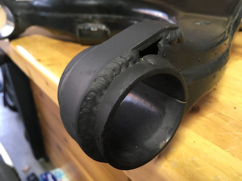

    The stock bushings came out just as described - thank you.
    Off to the welder now.

    Met up with a few of the NorCal usual suspects to program radios, wrench and bs. Asked them if they wanted to play with fire and we performed your magic. Easily entertained, this lot.

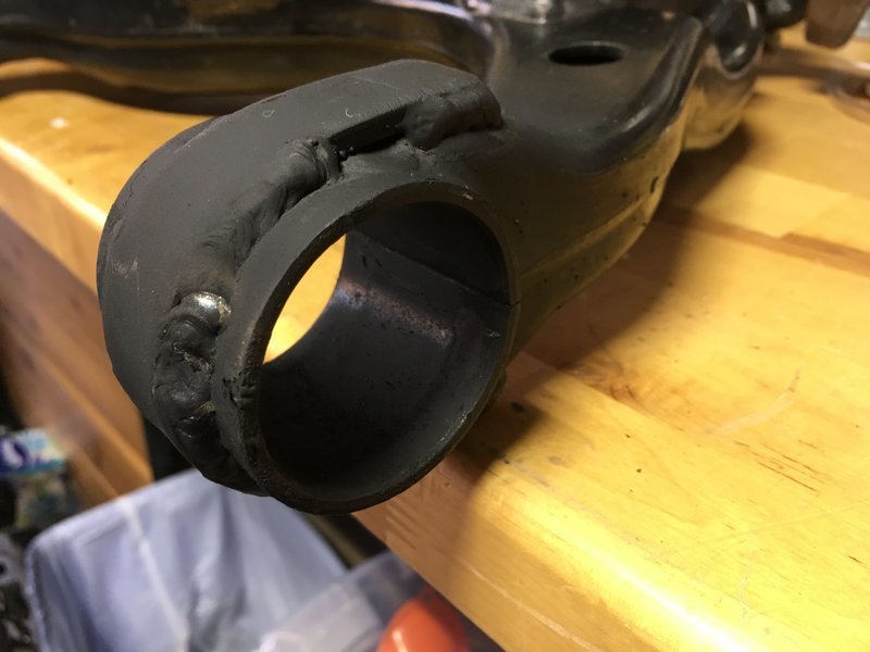

    A different take on beefing up the eyes.

    Maybe a bit overkill for most uses but that's definitely a nice solid solution.
