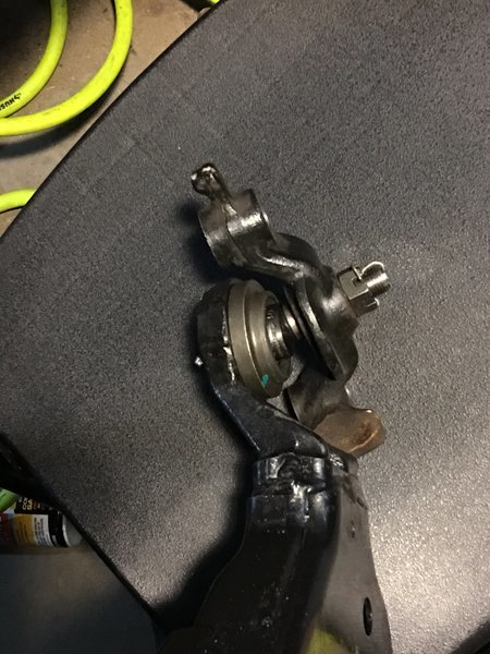

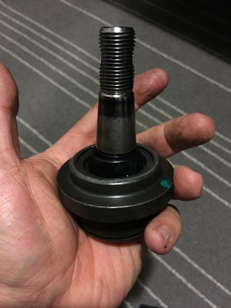

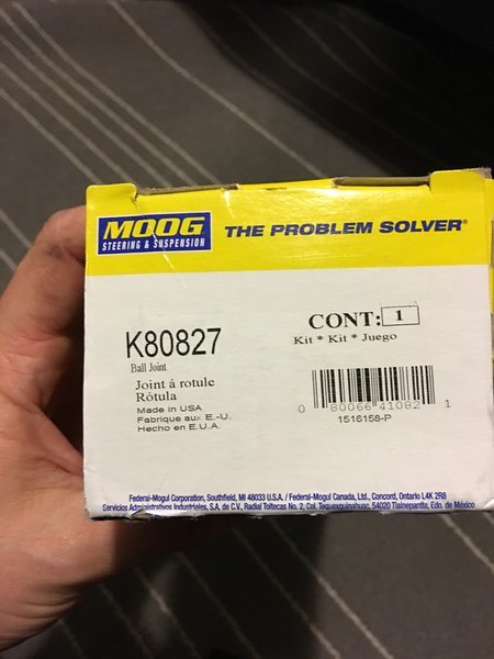

    IMG_4331.jpg IMG_4333.jpg IMG_4334.jpg Replaced mine with moog

    What's the consensus on the Moog? They seem to be holding up? I wanted OEM but if moog is good I'll just go with that.
  15. Apr 1, 2017 at 12:14 AM
    #95
    09BlueBeast
    09BlueBeast Well-Known Member
    Oct 28, 2014
    #141258
    989
    Cody
    Denver
    09 Speedway Blue TRD Sport 4x4
    Just finished the passenger side, but looks like a great product and I love their new boot design
