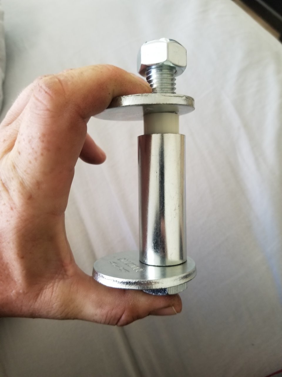

    has anyone used these for the alignment hardware?

    I used it for a while until Toyota replaced my frame and which came with new LCA's. That center sleeve is plastic and got a little crushed.. Idk if it was from a stupid alignment tech or just from the design.

    damn that was a quick reply! I should have specified that I am also using the Whiteline bushing kit that @Crom linked in the first post. picture below is the fatter bolt with a plastic sleeve and metal insert for the bushing. this is meant to go into the smaller front bushing. something doesnt look right to me. the plastic is sticking past the metal sleeve insert

    oh, you must have edited right as I quoted you!! now it makes sense. the plastic will get crushed..

    If it’s anything like the moog kit, then it won’t last. Some people had problems with the washer rounding out and losing the alignment. I would just go with OEM hardware. Buy everything from a dealer and return what you don’t need, some of your hardware should be useable even if you have to cut.

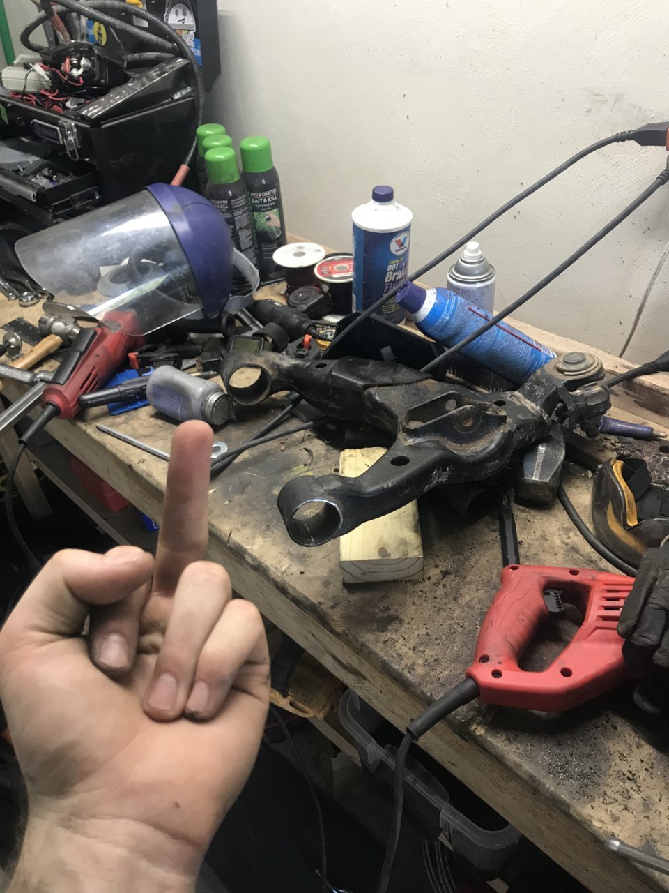

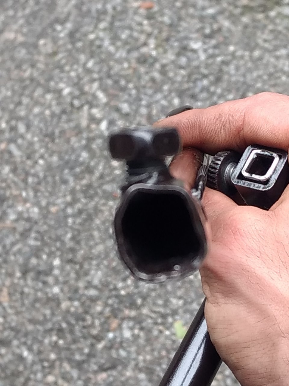

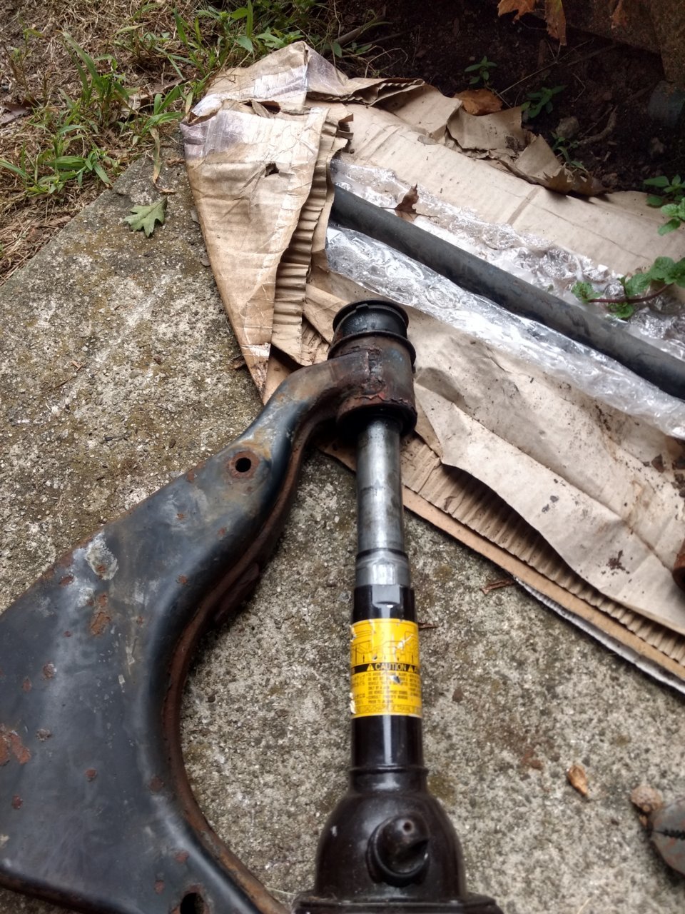

    :bananadead: now I just need to get the silly inner sleeves out. A little heat and the runner came right out. Sleeves are seized in there and will require some sawzall actionIMG_20180923_145912246_HDR.jpg IMG_20180923_150637905.jpg IMG_20180923_160247504.jpg IMG_20180923_150651862.jpg

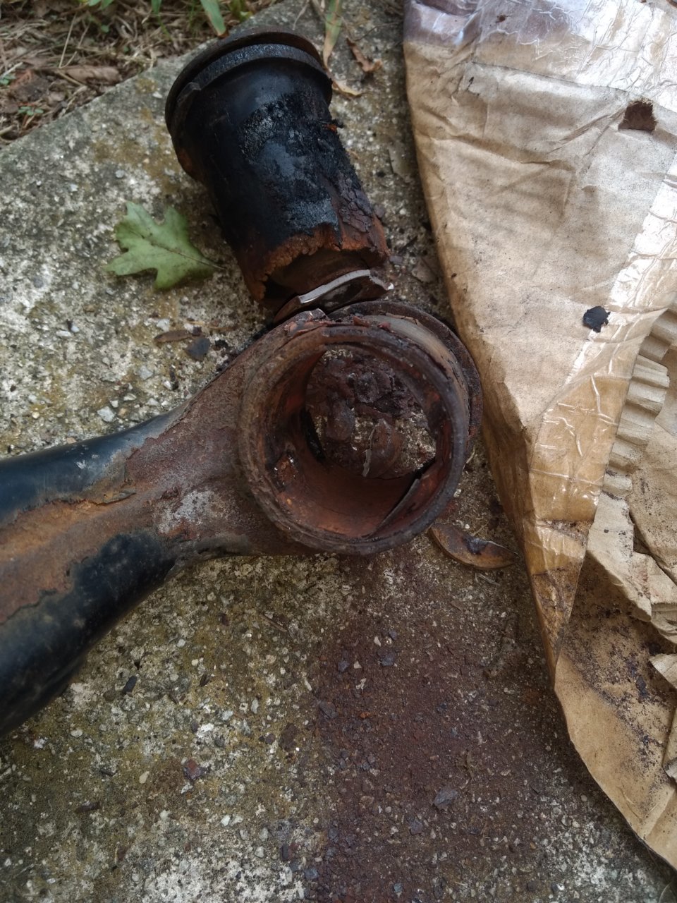

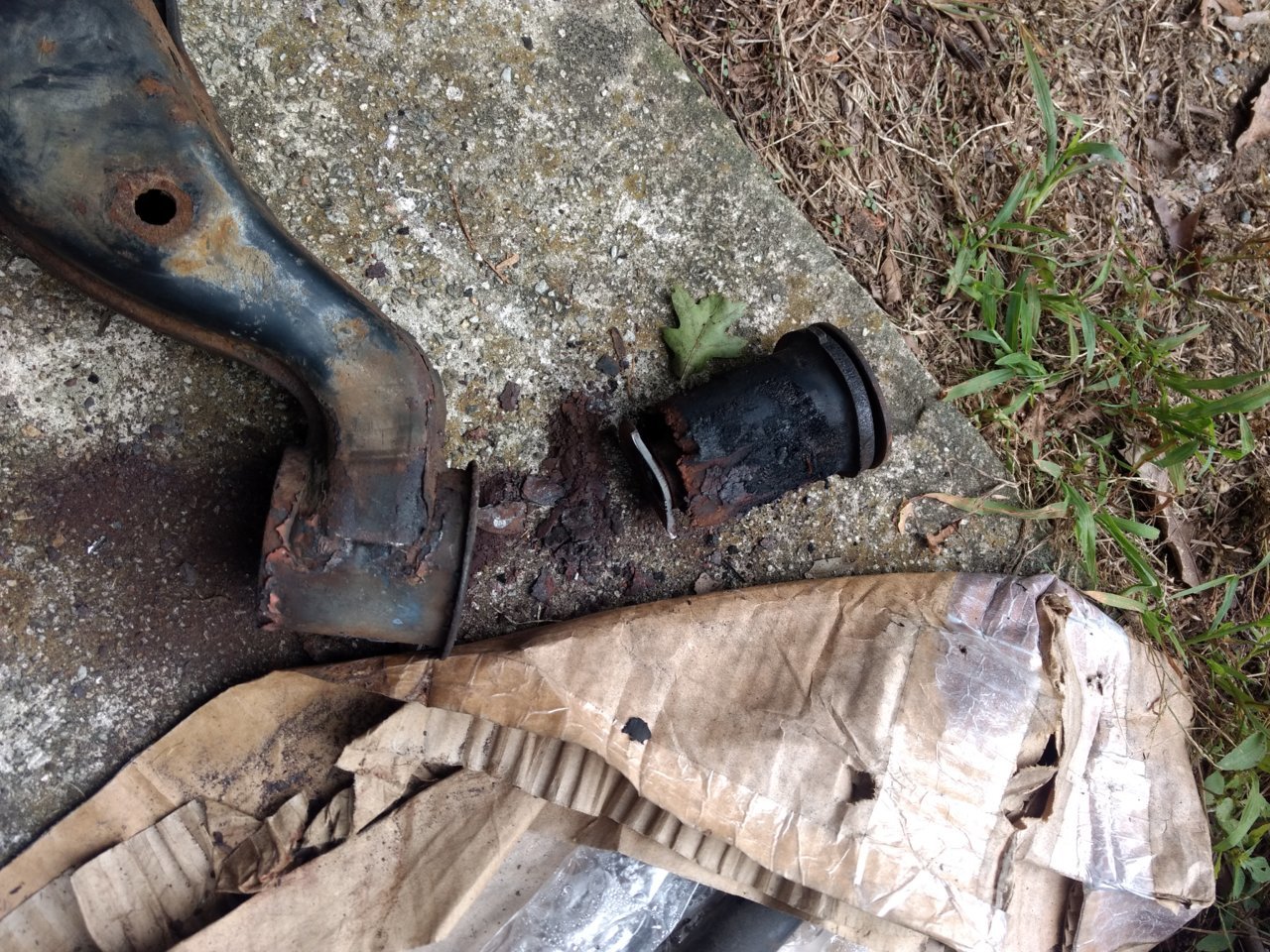

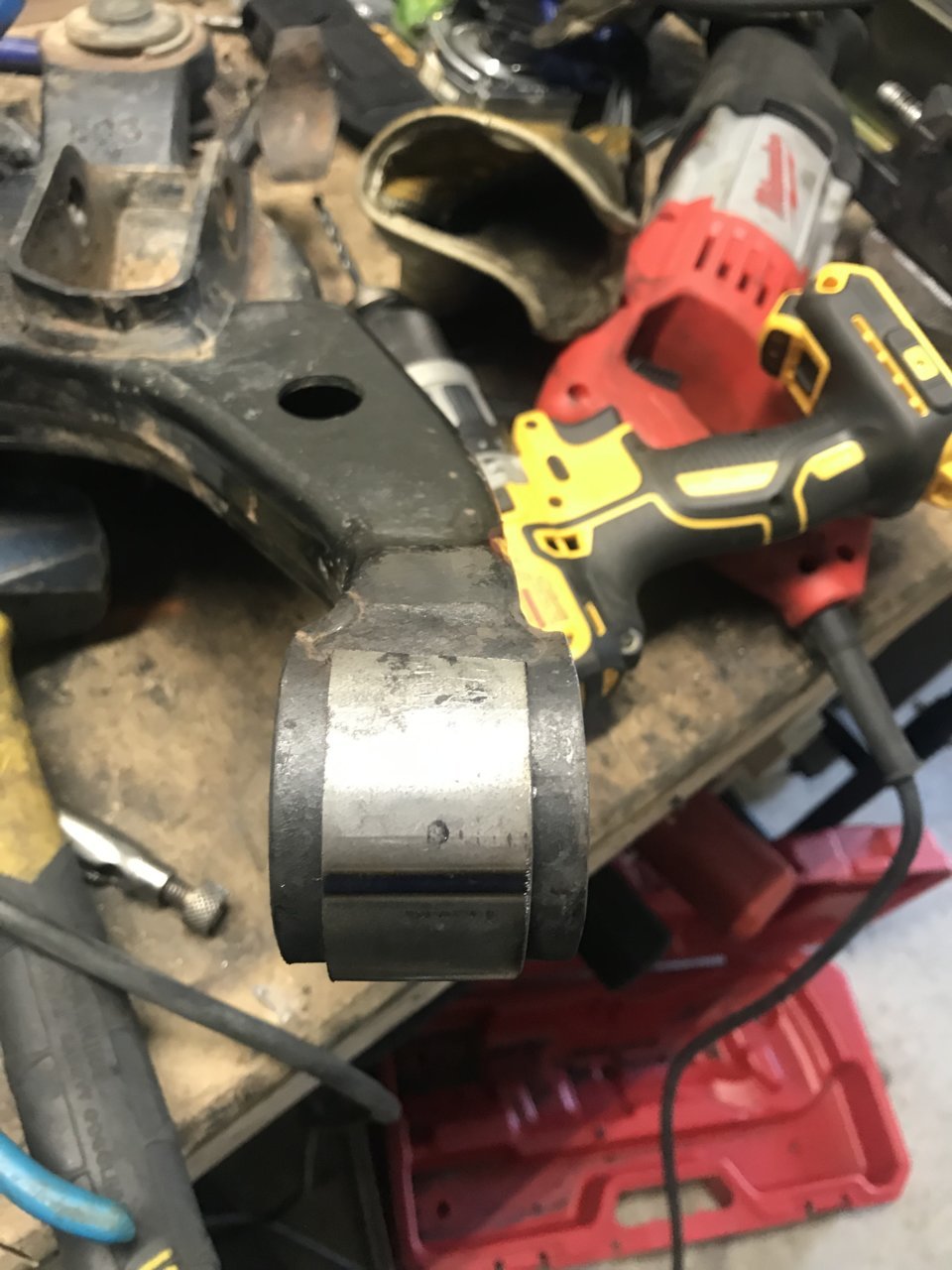

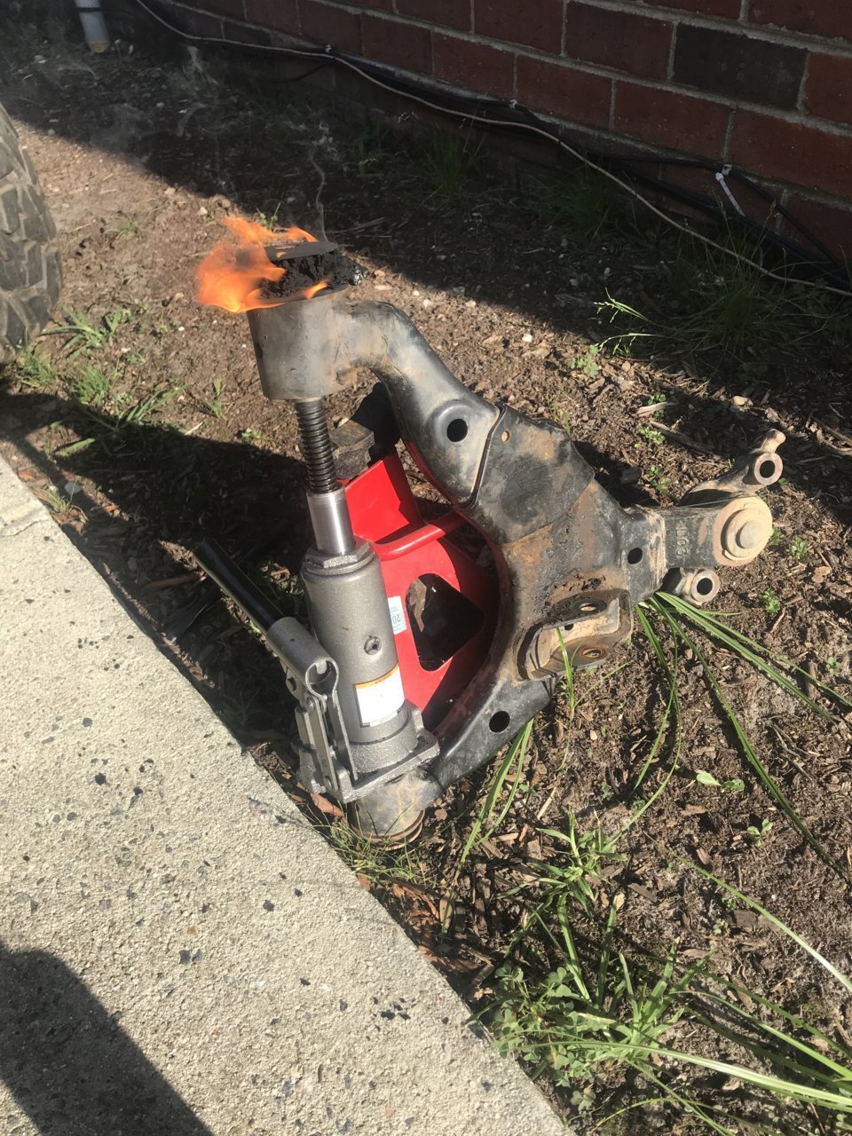

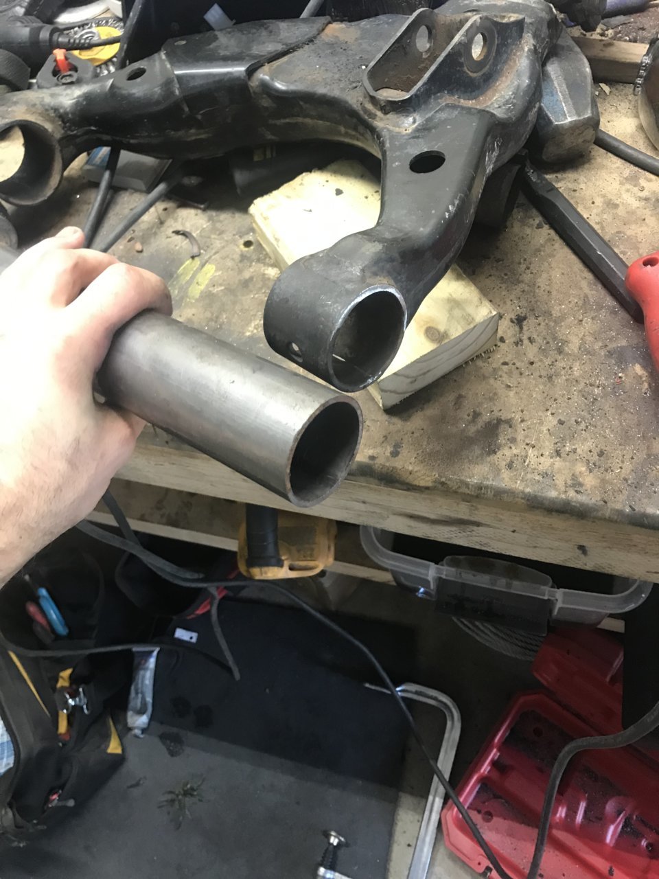

    I’d just like to add my lessons learned since I didn’t see this specifically mentioned in this thread yet.
    If the bushing separates from the sleeve, it’s not going to just press through easily. I was sitting there with fire on it for 10-15 min wondering wtf was taking so long. Put the fire out, and took a hammer and chisel and tapped the inner part out.
    Second one I had fire on it for 4-5 min and I could tell the rubber separated from the sleeve. On this one I had to take a sawzall and cut off one side, and then the bushing would fall out.
    This left the sleeve. What I found easiest was to take my angle grinder and a flap disc and shave off the outer lip. This allowed me to see my sawzall cut of the sleeve easier. Once cut, hammer and chisel and it popped out.
    Using this opportunity to reinforce the eye, plug holes, weld bump strike pad, and if I’m feeling frisky, build some lca skids or just weld steel to the bottom to make these beefier.
    I’ll show a finished product later, but probably won’t be done until this weekend.
