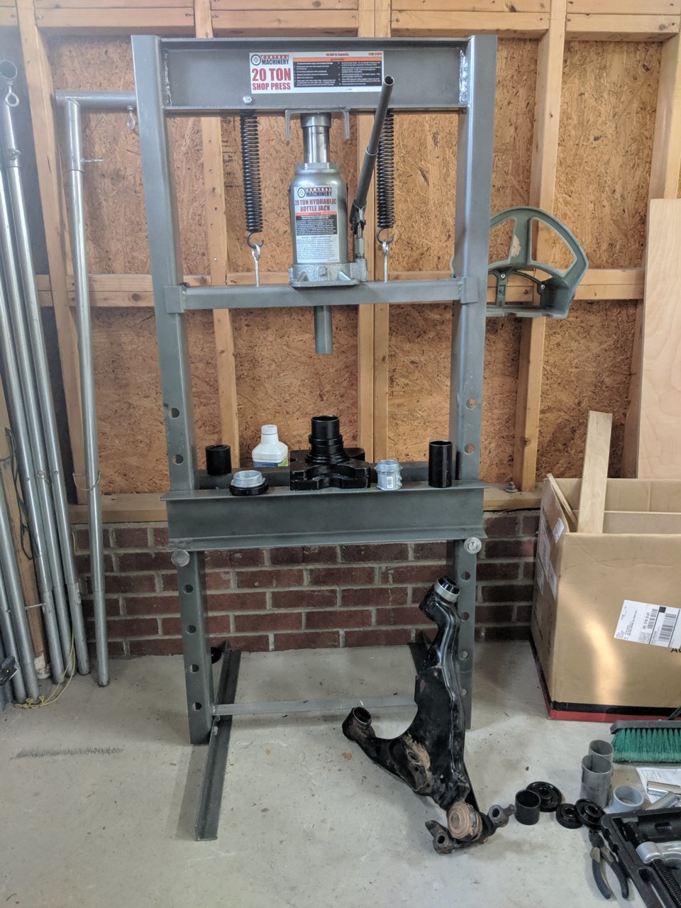

    So has anyone pressed the whiteline bushings in themselves? Everyone I’ve seen has said I had these pressed in

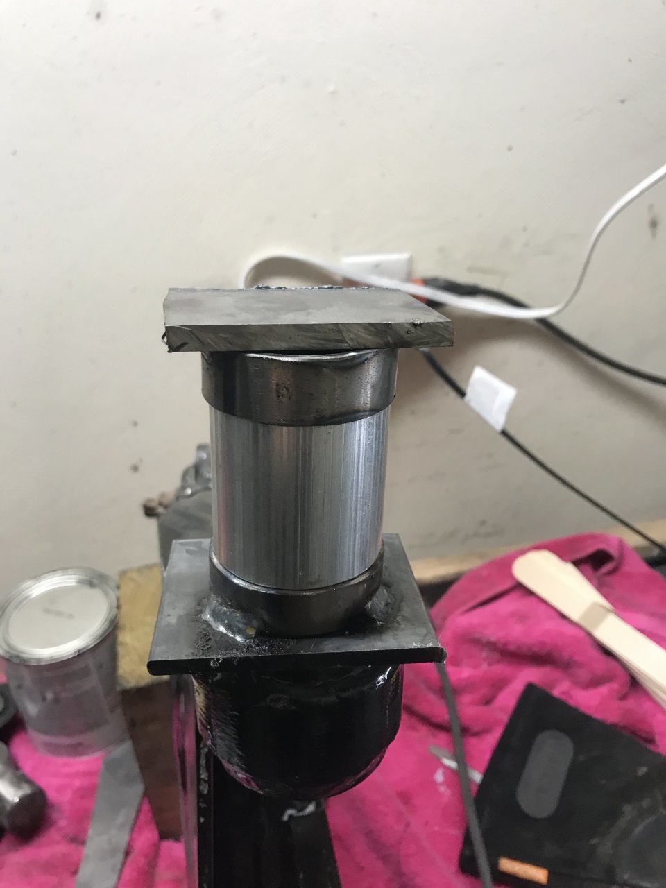

    I was able to press one in myself with a little homemade cup and using a rental ball joint kit. Other bushing didn’t work and I just paid someone to do it.

    That’s what I figured. Thanks for the quick response. Getting the old one out we’re cake. But no one has posted about pressing the new ones in

    It’s doable, I found a separate thread on it. Just need a press (doesn’t even require much force) and the right sleeves. I paid a mechanic machine shop to do it for me. I think it was $50.

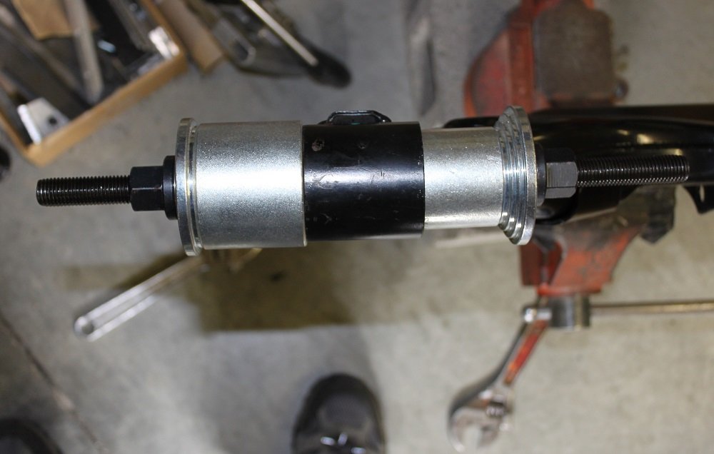

    Pressed them in myself with a random selection of parts from the hardware store and sleeves from a ball joint press kit. None of them fit exactly right but I managed. I really want to get the correct sleeves to do this if the occasion arises, I have the measurements.

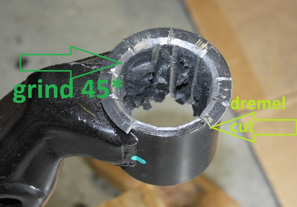

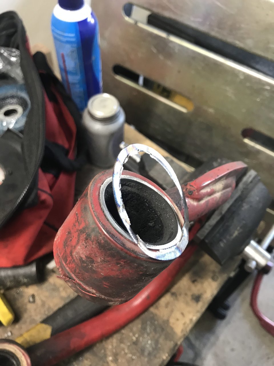

    This thread had me thinking... i can do this... so i jumped on it.
    Tried the bottle jack to remove the bushings, worked good on the small side but the large side was not moving.
    Tried sitting the LCAs outside in 10*f, then jack and heat... nope.
    Finally had a 'light bulb' moment, if that dang flange was not in the way it would be so much easier.
    So, remove the flange!
    Cut off one side of bushing washer, drill out the rubber, remove the inner guts/rubber.

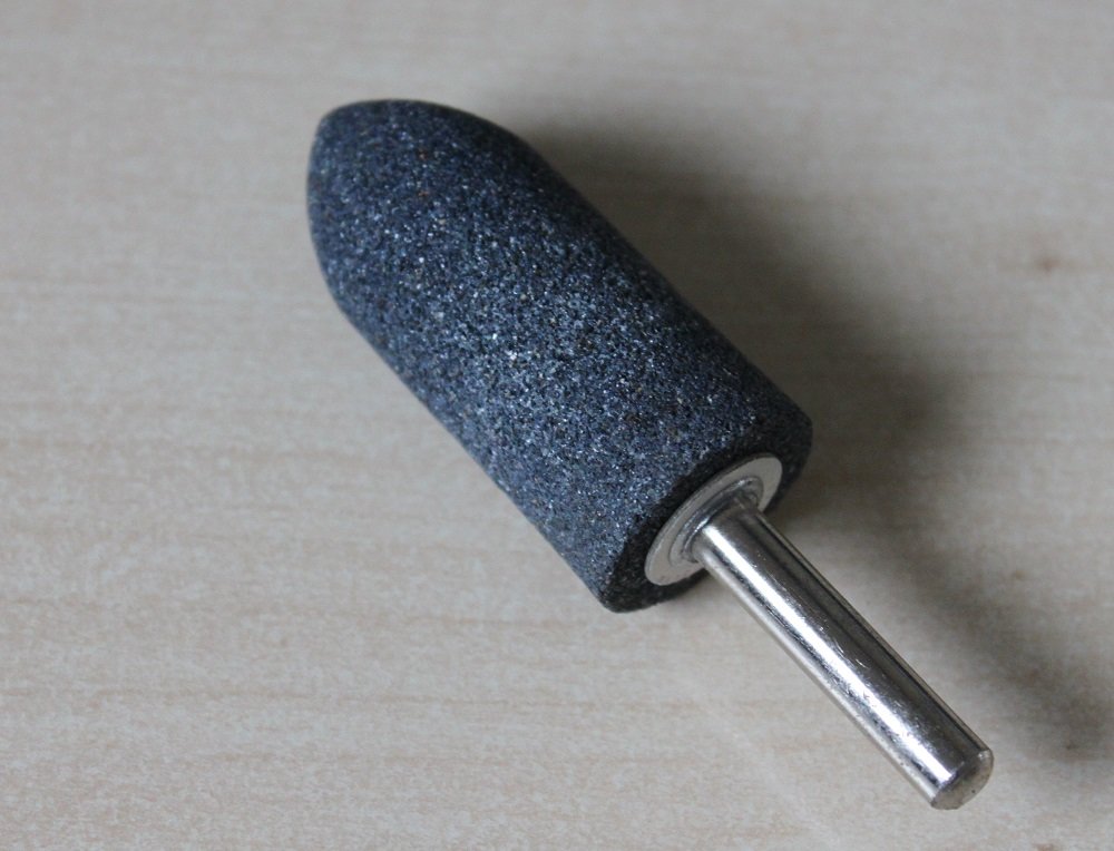

    Then grind a 45* into the inner flange edge (i used a air tool grinder bit in a drill), cut into pie sections with a Dremel tool then fold the flange up and in to break off.
    Now you can use a Press or bushing tool like normal!
    Maybe it will help some others with ornery bushings.

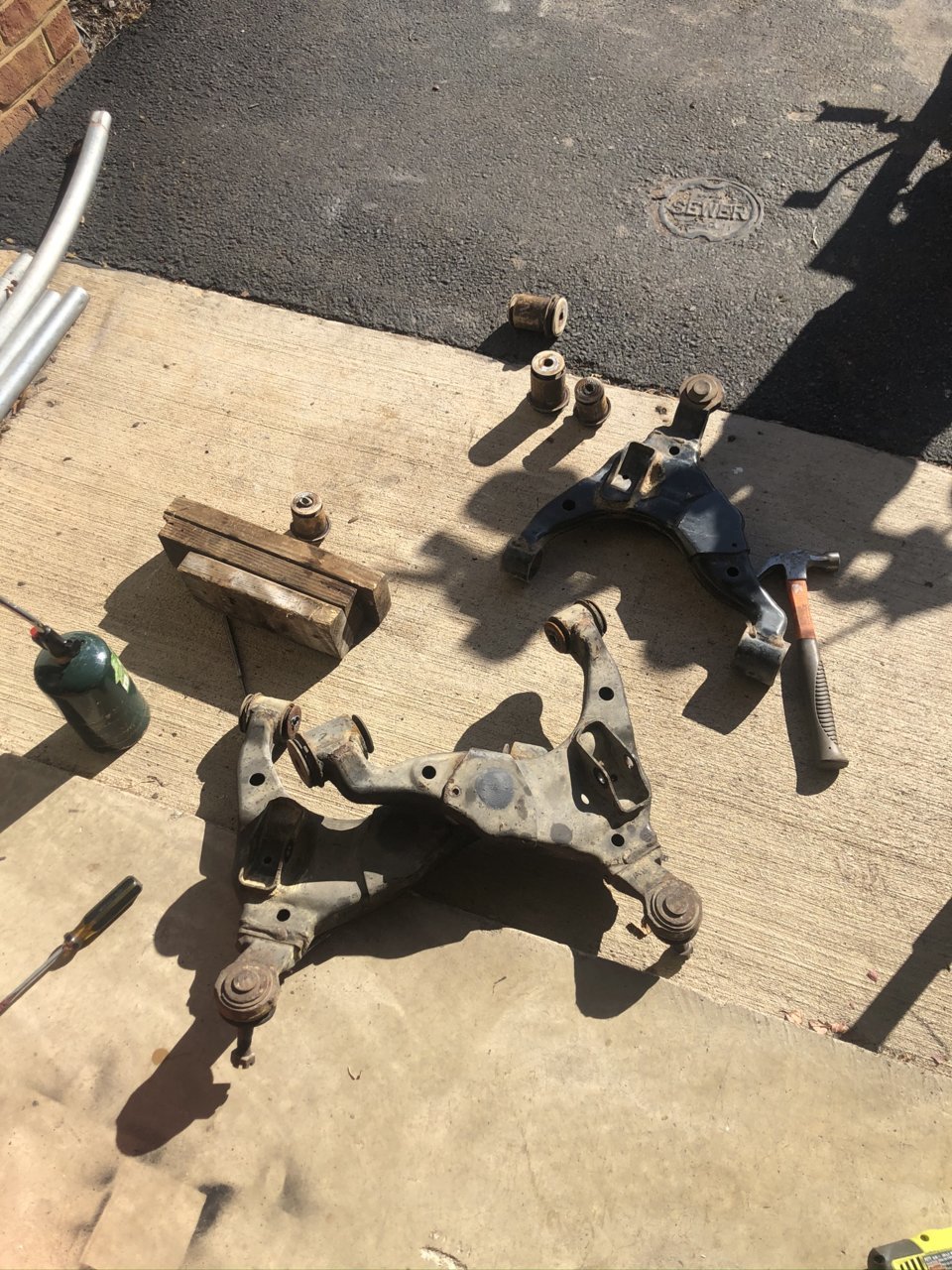

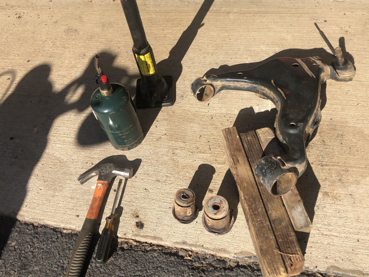

    I just used the factory bottle jack, didnt touch anything on the bushings. I applied some pressure to the washer on the big side, got my camping propane out, and slowly put more pressure on the bushing. All 3 of the pairs that I am rebuilding that sleeve came right out with heat and bottle jack pressure. I may have had some PB blaster in there too. The washer on the small side of the bushing is the same size as the opening, and that helped to push the whole sleeve out.
    Crom[OP] and EDDO like this.
  19. Feb 6, 2020 at 2:11 PM
    #159
    BackOff
    BackOff Well-Known Member
