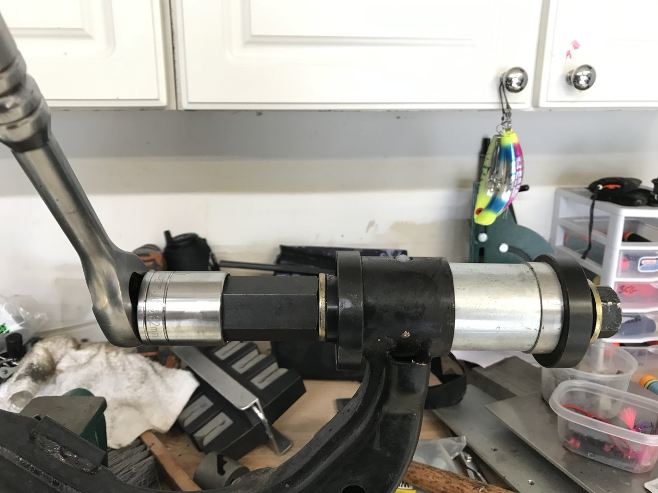

    I was able to get this done today. I used my wheel bearing tool and some turned cups I made just for this job. Worked REALLY well, so well that when I pressed in the first one backwards and in the wrong orientation before I realized there were instructions in the bottom of the bag I was able to get it out using the old sleeve.
    The whitelines tend to want to go in crooked so I would back it off, tap it straight with a hammer then continue driving.
    I also believe that parts stores rent wheel bearing presses now and between that and a master ball joint set you should be able to get the job done yourself without a hydraulic press.

    I used a $100 bushing tool...ebay.
    It had different sized sleeves. The perfect ones for the job.
    Anyone local that need the tool... willing to rent for a week end/6pack. Or i could help with install if need be. I have a press too...for ball joints.

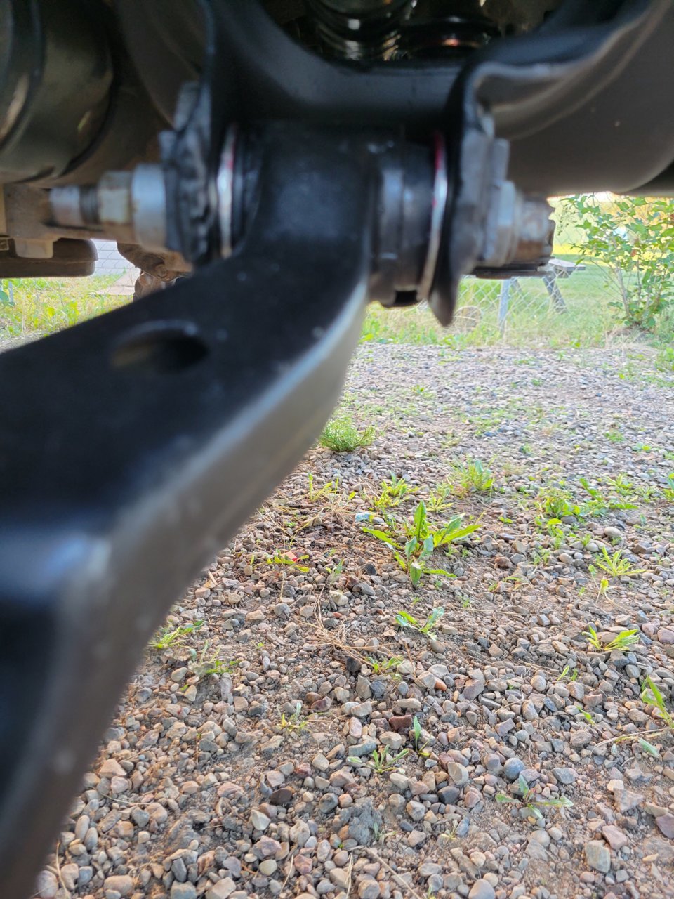

    I just rebuilt my LCA's with the Whiteline bushings.. I was excited to lay everything out to put the truck back together tomorrow until I grabbed the washers out of the bushing bag and found the instructions.
    I did not line up the little voids horizontally. They're at various angles or even vertical. They were a pain to get in, and I'm not too sure I could get them out without wrecking them.
    How important is that orientation?
  13. Aug 18, 2021 at 6:56 AM
    #173
    Sandman614
    Oct 26, 2010
    #45273
    36,013
    Tim
    Garner, NC/Boone, NC
    '06 SR5 Off Road
    I'm sure many people are running them "not installed properly" whether they didn't pay attention or they sent them to a shop for install. I can only imagine the bushing might deteriorate faster, if there is anything negative to come of it. Not catastrophic, just means you get to do again sooner than later and will probably "do it right" next time.
    A learning experience.

    TheNatural Well-Known Member
    Feb 3, 2014
    #122175
    2,168
    Fort Nelson, BC
    '12 DCLB
    Lots of bolt on chrome stuff
    Thanks for the response. I emailed Whiteline also and they said I might have some vibration issues with them installed as is. I think I'm going to fix it. Even if there's no noticeable difference, it'll bug me knowing that they aren't quite right

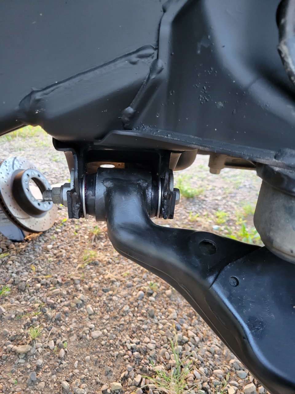

    Well, I fixed the bushings then went away for a few days. Threw it all back together today. My whiteline bushings look a little squished to me. Torqued to 100ft-lbs with a good torque wrench and the sleeves are in the middle of the bushings. Is this how they're supposed to look?

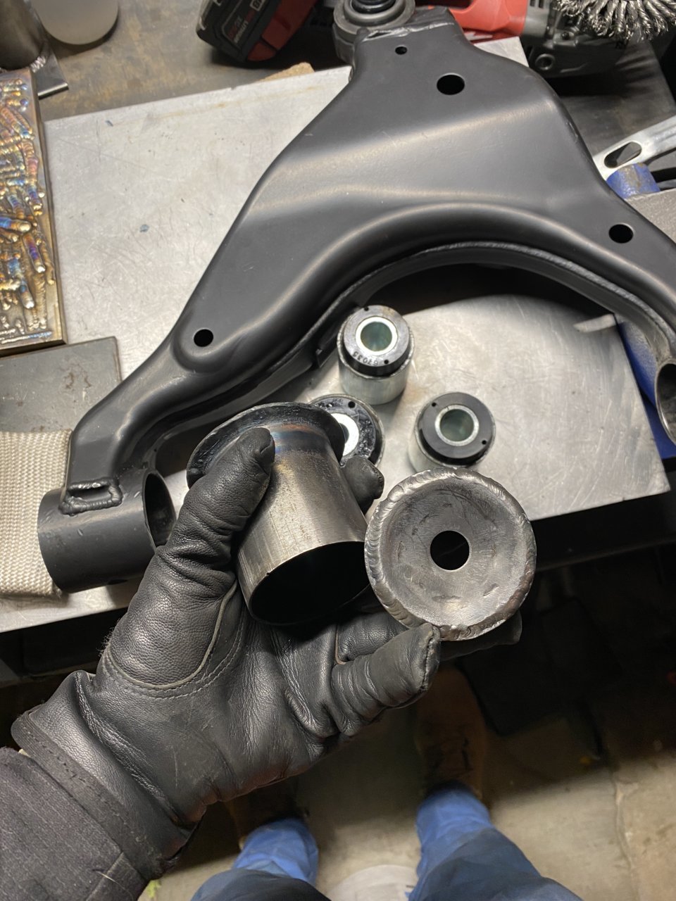

    Still burning these up, I’m still in the process of learning to weld so bare with me lol
    using the heat from welding to pop the bushings out.

    Definitely need the right tools and ingenuity. Removing the bushings was the easy part, pressing them back in was what sucked.
    needed to come back and edit this for anyone who might get themselves in my shitty situation.
    So remember, the fat side of the bushing points outward! My dumb self forgot to remember that while pressing the new bushings in.
    I decided to use the old bushing casing and some washers to make a bushing press. Not the prettiest but they got the job done.
