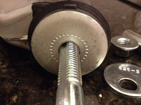

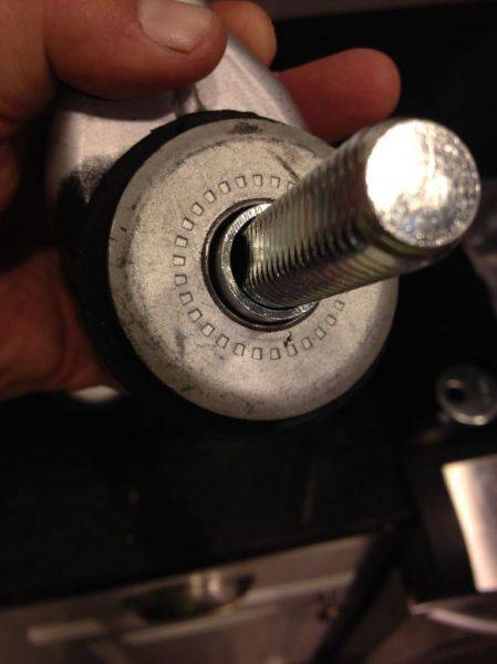

    Mine came from Moog exactly the same. But I had already ordered factory rear setup; it's stupid to have to order 2 of these kits to only use the fronts.
    Did you order new bushings? The Moog bolts don't even fit through the rear bushings, completely wrong! The factory bolt/cam setup fits fine in new rear bushings. Frustrated!
    Can anyone confirm ID of front and rear bushings are supposed to be different?

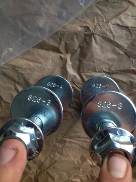

    2 & 4 are different diameters as well. Not sure what the F'k to use atthis point. Might end up putting new factory (seizing) crap back in if I can'tget this solved soon.

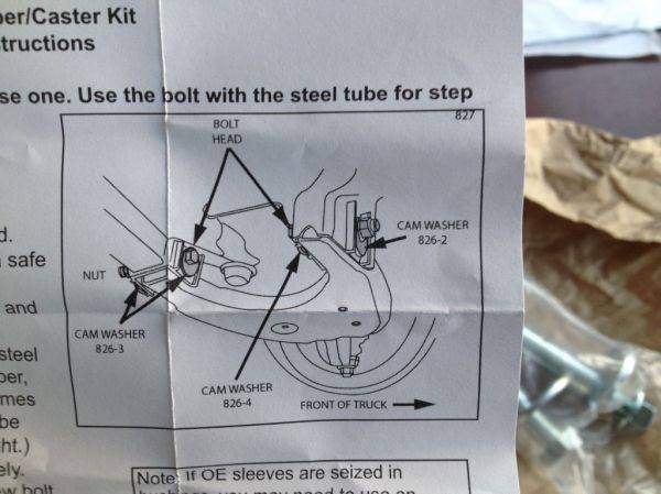

    Still haven't received a call back from Federal-Mogul. Looks like according to the diagram a set SHOULD fit one side, front and rear. Obviously there is a problem. Perhaps Moog didn't realize that the rear bolts on the LCA are a different diameter?

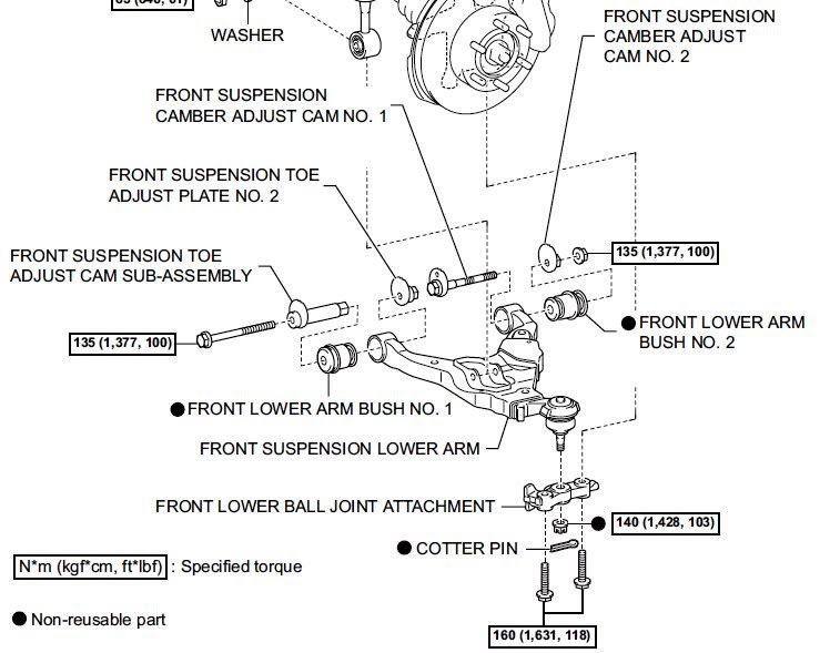

    Here is my contribution to this thread a nice clear factory diagram:
    I think your right based on the diagram I've included. So I have questions! I want to grease the front and rear bolts provided they are not frozen in place.

    That still leaves the question of which Cams to use (IE: 826-2 826-3,826-4)in what location? Assuming one was to order 2 kits just to get grease ablefronts out of the deal. As thepreassembled and the diagram provided are different...

    I replaced mine a week ago. They are very different.

    And you used the greaseable Moogs up front? If so, which cams(by number) did you use in which location?

    Nope, sorry I meant I switched out all of my hardware because the sleeves on the front seized and I figured I'd just change everything while I had the LCA off. I went with OEM because I got my parts before I realized that there were greasable parts. I can measure the OEM cams if you guys want and maybe whoever already has them can measure what size the cams are for the MOOG parts
