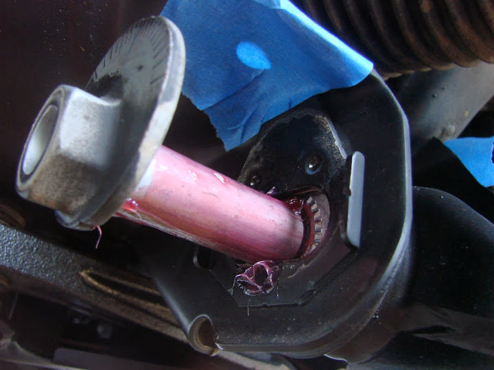

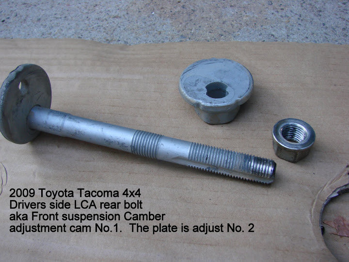

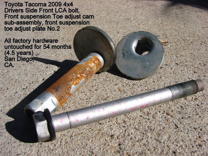

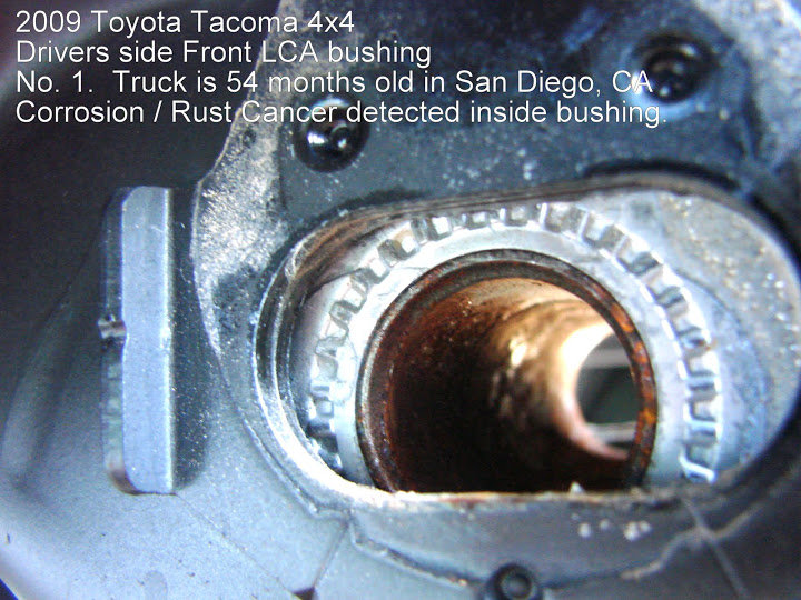

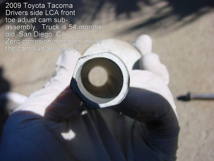

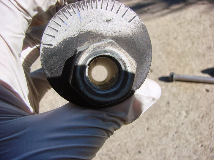

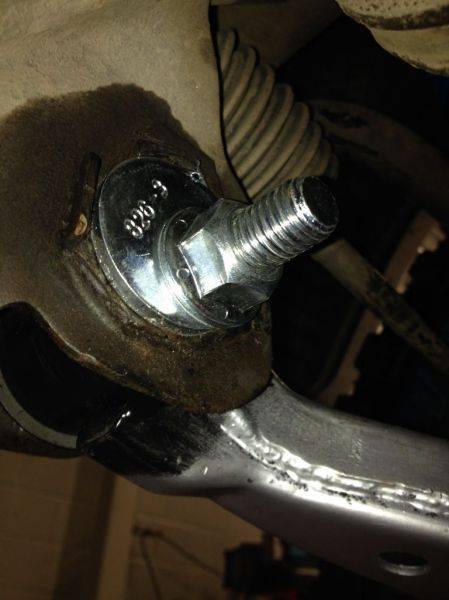

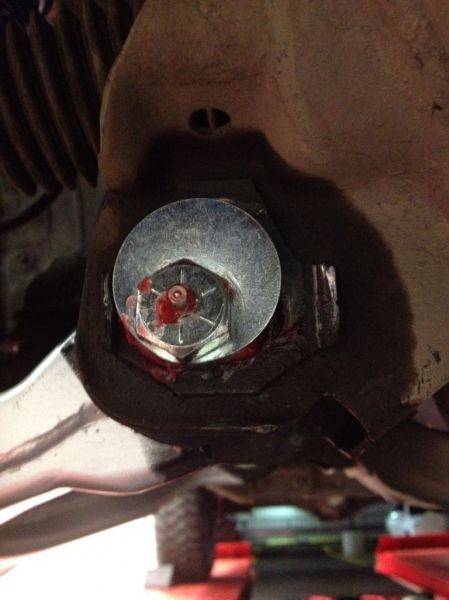

    Thanks again. Okay I did one side, the drivers side, I'll to the other side tomorrow. Pics are below. In a nutshell my bolts were in great shape, but the front bushing has the beginning signs of the rust cancer.
    I think I'll try the passenger side like you suggested and post back.
    Here are some pics of my work on the drivers side.
    There were a few things to take away from this experience for me.
    1. I was in a hurry rushed by my wife to do the job and I forgot to make some match marks on the rear cam. :mad: But I did the best I can and will get an alignment once I grease the other side.
    2. The threads on the rear bolt were dirty and when unbolting the nut it f'ed up the threads a little bit, next time I'll hit it with a wire brush before unbolting.
    3. I unbolted the steering stop and inspected the LBJ and it looked really good. The threads on the attachment were perfectly clean. No corrosion detected. The same goes for the lower shock mount bolt. Really clean threads.
    4. Thankfully I had just repainted the front end of the frame two weeks prior so it was a really clean space to work in. :)

    So I reread through this a bit and correct me if I'm wrong, It appears no one has actually installed the moog cam kit up front yet?...
    If I'm wrong, I still have the question of which cams where used in which location as the preassemblied and diagram are different.
    I fully intend to use these up front and will post once installed. Still waiting on $ for a couple last parts(Uniball Upper control arms) to only take it apart once.
  3. Nov 5, 2013 at 6:18 AM
    #263
    Sandman614
    Oct 26, 2010
    #45273
    35,946
    Tim
    Garner, NC/Boone, NC
    '06 SR5 Off Road
    Incorrect, the front has 2 cams each side. The forward cams are correct, the rear bolts are incorrect.
  4. Nov 5, 2013 at 8:48 AM
    #264
    ST3VE
    ST3VE IG: @fishsohard
    Jun 20, 2011
    #58595
    2,471
    Steve
    MD --> SC
    Tint, car seat, baby wipes
    This^^
    I installed the fronts from Moog and the rears from the dealer. The cam bolts that have the 3's on them are the ones that work. The other 2 bolts are paper weights.
    Rear dealer bolts.

    Last night I braved the cold San Diego weather (54° F) :rolleyes: and in the dark of night, I serviced the passenger side bolts. No pictures, but both bushings (front and back) had the rust cancer.
    BONUS! If you have a 12 gauge shotgun cleaning kit handy, a brass brush is perfect for cleaning the rust out of the bushing! I did that and it worked great! Cleaned the rust off the bolts and cam-sub-assbly with 220-grit and greased and put back together. :D :cool:

    I just remembered something... It should be noted that if someone lubricates the threads or the bolt/nut face with grease or anti-seize when reassembling the LCA, then the required torque should be reduced. The factory calls for 100 lbf.ft. (dry threads). I used 90 lbf.ft on greased threads, but it probably should be lower like 80 lbf.ft. in my case.

    Right on. Thanks! The "3" Is what I was looking for.
