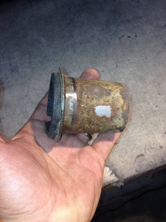

    Getting these out is a royal pain in the ass. :mad:

    There were only two left on the spare LCA's I bought - I got them both out now. :D
