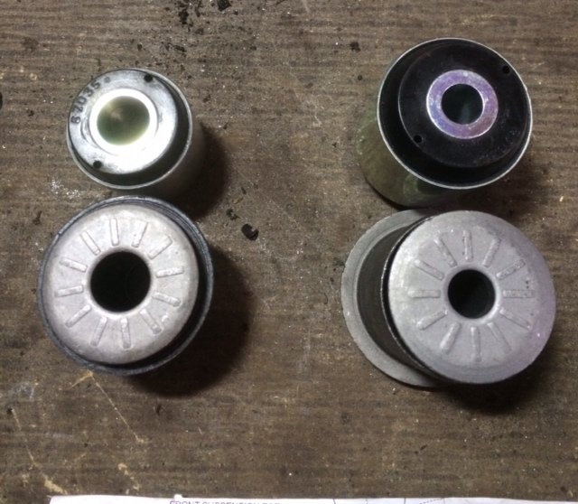

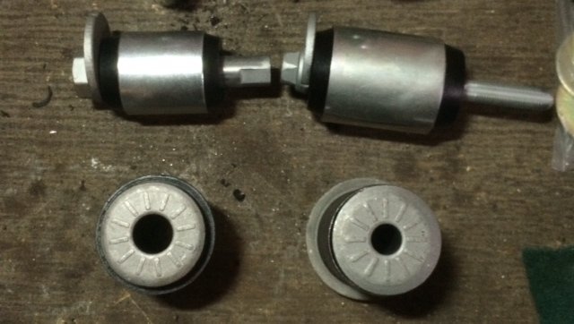

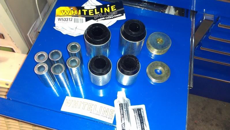

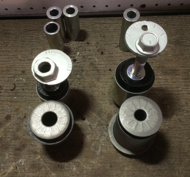

    Being a victim of the seized LCA bolts/cams, I took on the job of cutting the LCA's out of my truck and replacing the bushings. A while back Boyd had mentioned the Whiteline bushings (P/N: W53312) as a possible alternative to the Toyota or Moog parts, but with no history of anyone installing them it was not confirmed they would work.
    I found that Energy Suspension sells the bushings. They do not list the 05 up Tacoma but according to their site, the bushings fit the 03-12 4Runner & 07+ FJ Cruiser http://www.energysuspensionparts.com/alsofoundin.asp?partid=W53312
    A little research shows that the Toyota & Moog part numbers are the same for the 4Runner, FJ & Tacoma bushings, all interchangeable. I decided to give the Whitelines a try.
    Visually the bushings look great & appear to be a match to the Moog’s
    Hardware fits
    So far it looks as if they are going to work :woot:
    Until I went to install the bushings :( The Toyota & Moog’s go in ¾ of the way by hand & need to be pressed in the rest of the way. The Whitelines wouldn’t go in by hand at all. Figuring they are just a tight fit, I tried using a ball joint press, still no good. I compared the O.D. of the Whitelines & Moog’s.
    Moog large bushing
    2.173
    Whiteline large bushing
    2.224 - .051 larger than the Moog’s :(
    Moog small bushing
    1.861
    Whiteline small bushing
    1.905 - .044 larger :(
    They also have P/N: W53393 which is listed for the Toyota Hilux. When I called for the return, a rep confirmed they had notes in their system that these would not work on the Tacoma.
    I was hoping this would be a viable alternative to the OEM's or Moog's but it's safe to say Whiteline is out :eek:

  18. Jan 6, 2014 at 3:18 PM
    #338
    Drunknsloth
    Drunknsloth Indffrnce will be the fall of manknd but who cares
    Jun 17, 2010
    #39105
    3,126
    Retribution

  19. Jan 6, 2014 at 3:59 PM
    #339
    XXXX
    XXXX [OP] Well-Known Member
    Sep 1, 2011
    #62715
    20,889
    sKiP
    05 Prius
    :spy: the first pic
    he posted it - same part number Kevin had issues with
  20. Jan 6, 2014 at 5:16 PM
    #340
    HomerTaco
    Mar 28, 2010
    #34129
    45,874
    HomerTaco
    HomerTaco
    HomerTaco
    Maybe Kev just got a bad set??? :confused:
