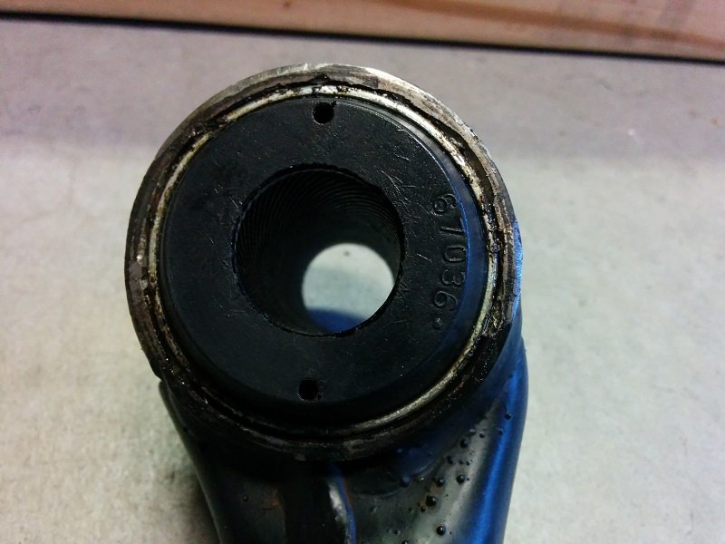

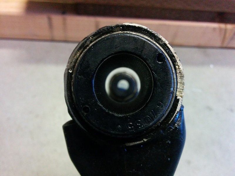

    Are the part numbers on your bushings 67035 and 67036? I actually got sent 2 packages because my first one only had 3 bushings. So I guess now I have 3 spare bushings.
