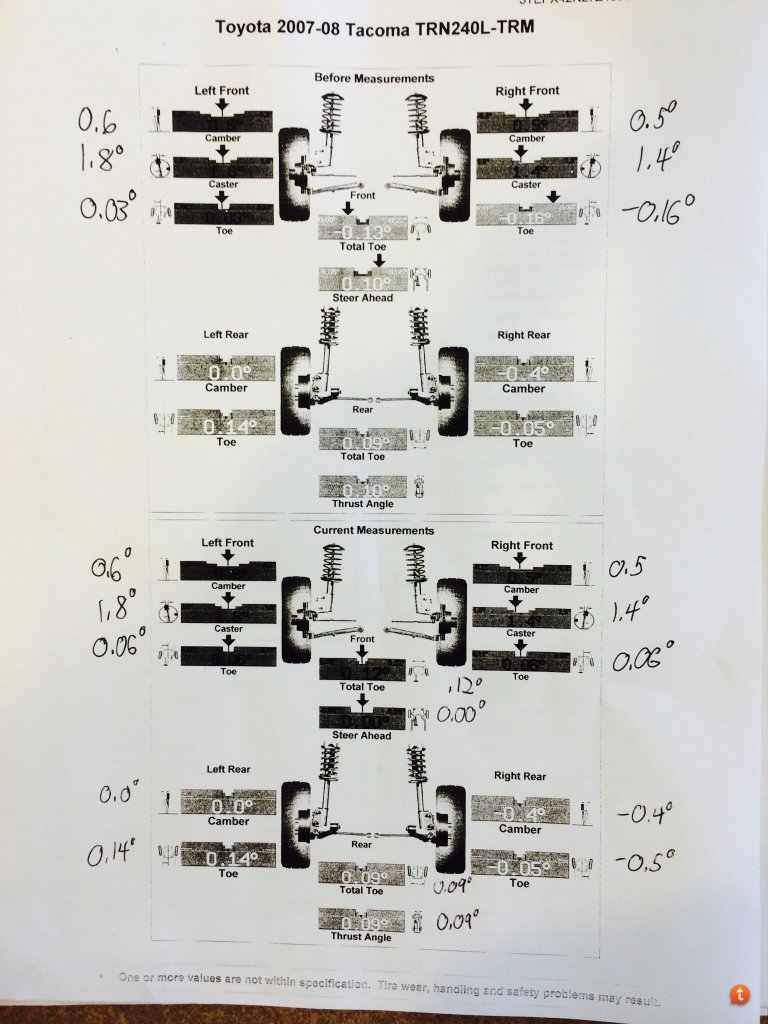

    Note the fine print at shops when asking for alignment. Many say "adjust toe. measure caster and camber." They don't usually mess with more than tierod adjustment. Have to find a good shop.

    Yep. I ended up spending $50 at a local shop that I told myself I would never go to (looked run-down and unkept). They fixed all my alignment issues and the truck now pulls straight. Can't judge a book by its cover I suppose. My Moog parts are holding up just fine (even the Camburg UCAs with Moog ball joints- heard the ball joints will only last to 25k miles though). Toyota was just too lazy (or didn't know how) to mess with caster/camber. Still pissed about it. Imagine all of the vehicles that got a "toe and go" and wonder why their tires aren't lasting.
