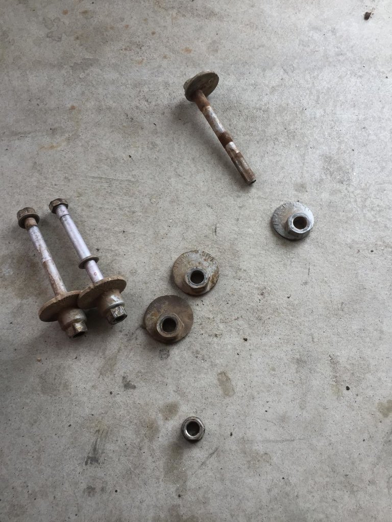

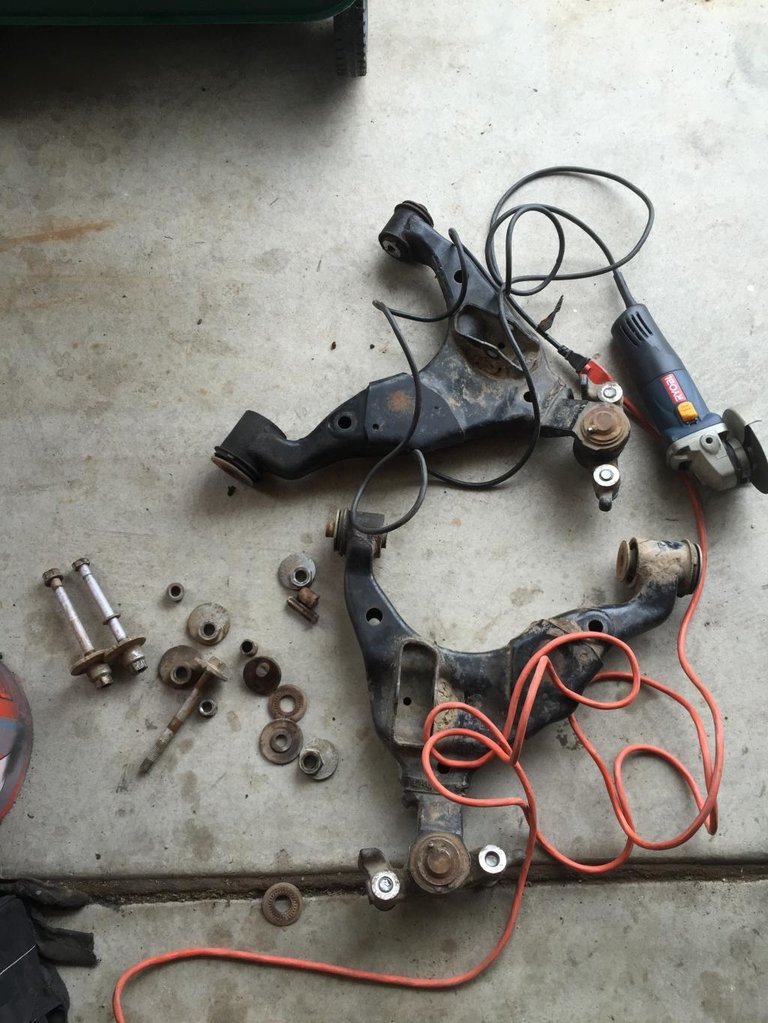

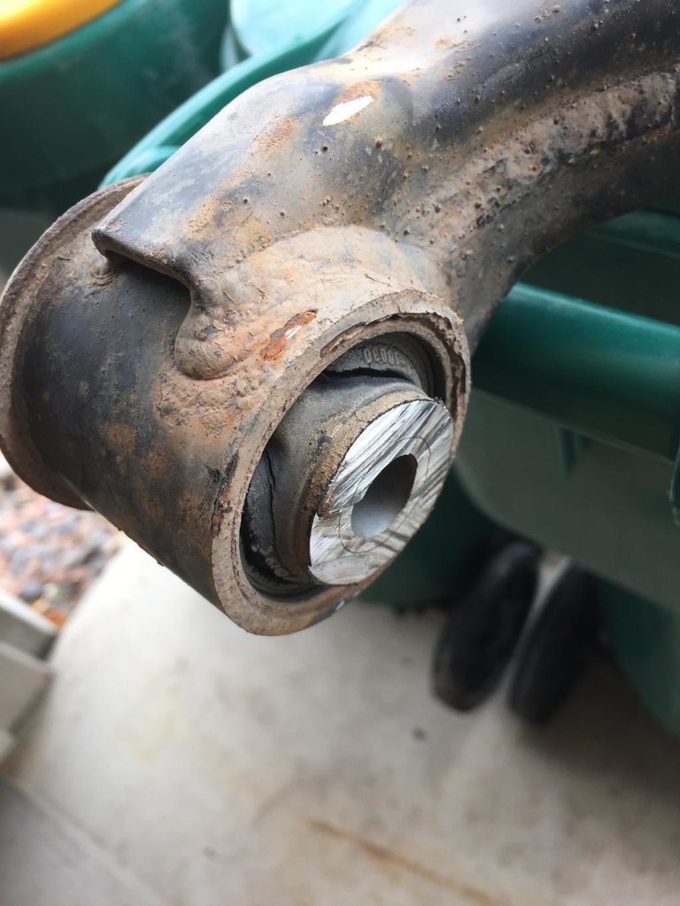

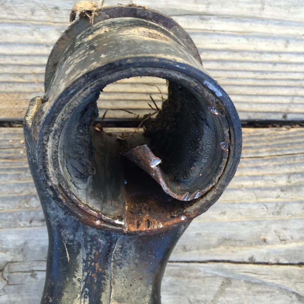

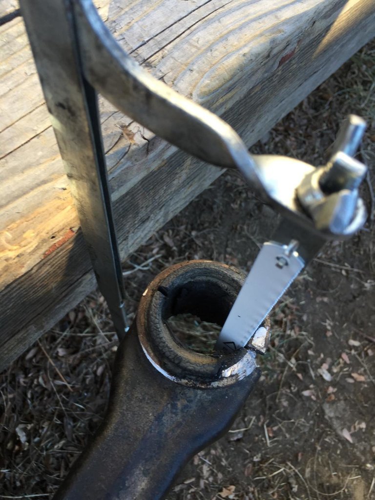

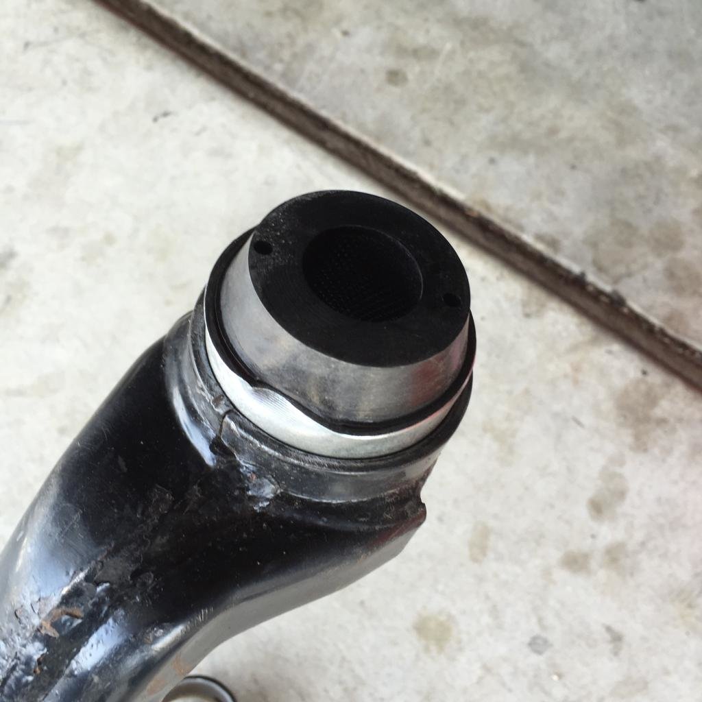

    Here are a few of the pics I took, and some notes:
    - Remove as much of the front suspension, steering and axles as you can, it will make everything a lot easier to access.
    - With CVs, spindle and tie rods out of the way, I got to the bolts with a 4.5" cutoff wheel, had them cut out within minutes. Rotate the LCA fully one way, cut, rotate the other way, cut. Off.

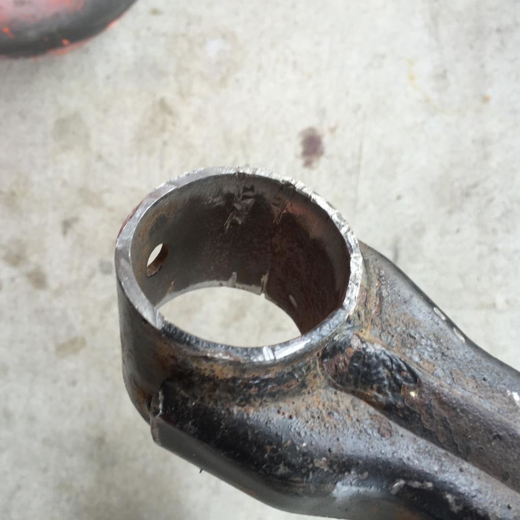

    - Drill out the bushings, then saw them, burning seems to an option as well.
    - Get a NEW high quality hack saw blade, 18 tpi. I used this one from ACE.
    - Cut the bushings sleeves out, go slow and make sure you cut parallel as to not cut into the LCA. If you place the blade to cut towards where the arm is welded to the shell, rather than just into the shell, if you cut too deep it will not be catastrophic, first pic of the cut below is not the recommended place, the second is.
    - Cut a slit in the sleeve, bend inwards and then beat those bastards out. This was still a major PITA even with the sleeve fully cut, mine were rusted all to hell.
    - Wire wheel and sandpaper to clean up the inside of the shell.

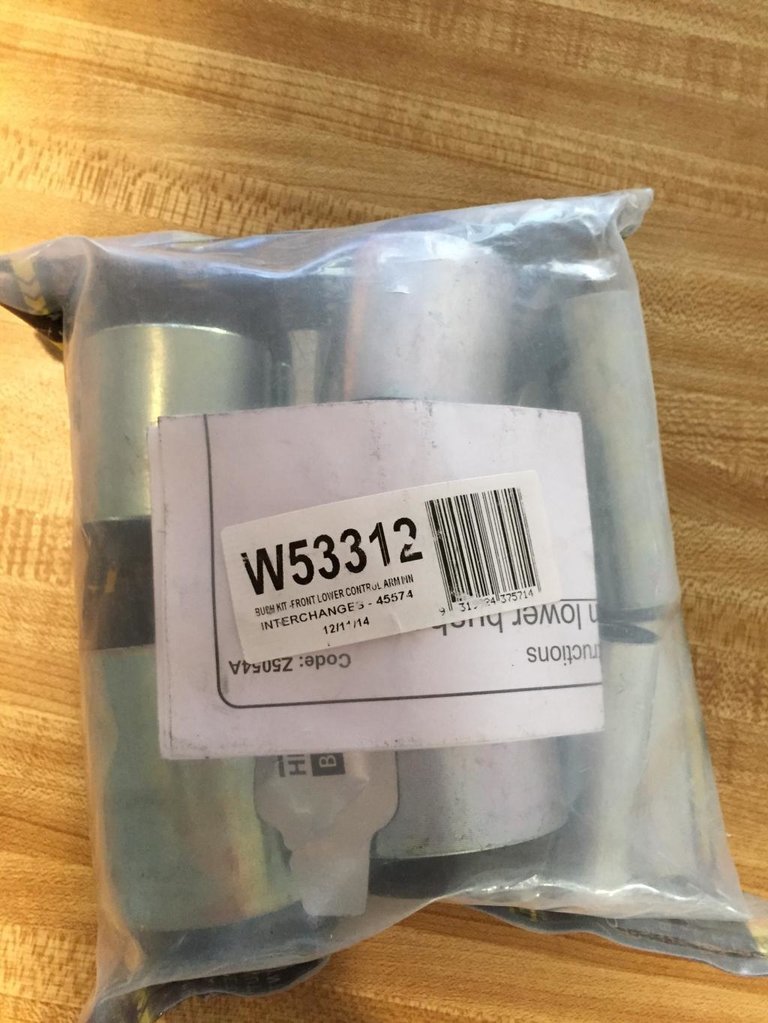

    - Press in new bushings. As mentioned, the Whitelines are no good, got one 90% in and then it started to crush. I had a bushing press from Autozone, and the adapter kit from Harbor Freight with the correct sizes, but the adapters were too long to fit everything in the press, so I had to BFH them in. If you cut the adapter, I think you could fit everything in the press, but I planned to return the kit if it didn't work out, which it didn't.

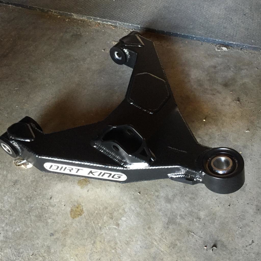

    - Hello Dirt King

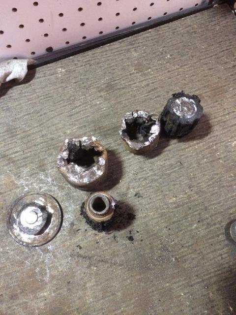

    I should add that I got 3/4 bolts out, but not the sleeves. So all four corners needed at least one cut. First is what came out without a fight, second is the pile of scrap.

    Very cool. How much did those run you? And what advantages over stock? Uniball or ball joint?
  18. Feb 12, 2015 at 2:05 PM
    #538
    Wishbone Runner
    Wishbone Runner Because 4R
    Sep 9, 2012
    #86546
    6,353
    James
    CO
    04 SR5 4Runner
    King/Dirt King
    I would consider it only sort of well done, didn't finish the job the way I wanted . . .
    $1485 shipped, they use a SS uni-ball and hardware and Delrin bushings. They allow greater droop and stuff from the uniball, and are quite a bit stronger.
