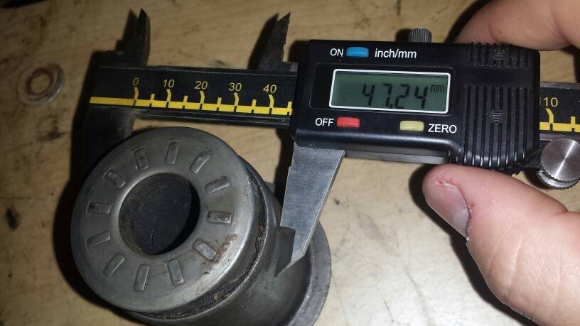

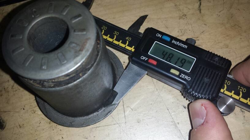

    BTW, I put the old factory bushing back in and all the knocking and movement is gone.

    Wow that's really shitty quality. I have the Moogs on my passenger side and so far so good. No clunks or anything but I've heard the Moogs are crap so I'm sure I'll eventually have issues. :(

    How was price on the Napa bushings vs Moog? I'm going to change out my Moog front bushings because they're too small and come out by hand..

    I have developed a clunk, pop, ect in my drivers side front. I have the MOOG bushings as well. My first assumption is the bushing.

    Yes, same problem here. They were fine for a few months, but recently I'd noticed a clunk from the front passenger side. Checked all fasteners and all tight. Came across this thread and got under and took a better look. Yup, front moog bushing is out almost a 1/4". I had a shop press them in so I know they were flush at install time (last fall). Just got home from picking up a pair of brand new Toyota lcas off CL for get this - $150 for the set. The Lord was looking out for me for sure as I am currently out of work. Guy had a nice clean '07 with a 6" pro-comp db lift. Hoping to swap both tomorrow.

    I wouldn't change how the bushing is installed. Moog just needs to make a product that fits correctly. The rear bushings actually had to be pressed in except for the first 1/8" or so where the front bushings went in by hand until the last 1/4" (being very generous).

    Couple hours work this morning and new oem lcas installed. Easy job and no more crappy moog bushings. When I got the passenger side of, the front moog bushing dropped out with the lightest tap. I don't know how long the lbjs are supposed to last (truck has 59k), but since they come already in the lca it's something that I shouldn't have to worry about for years now as a bonus. Thanks for the heads up Sandman. Happy.

    Changed out mine yesterday too and the clunk is gone!
