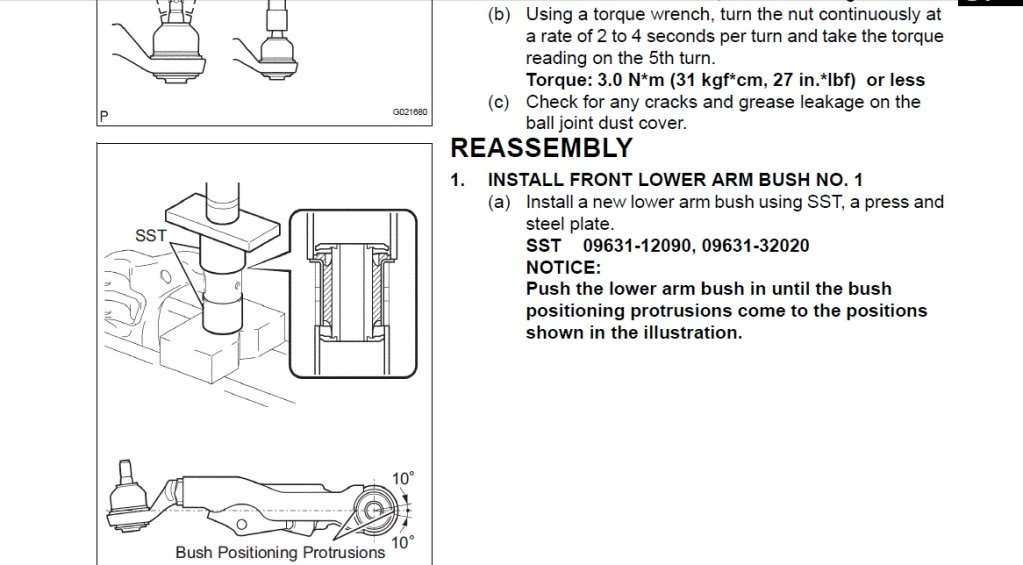

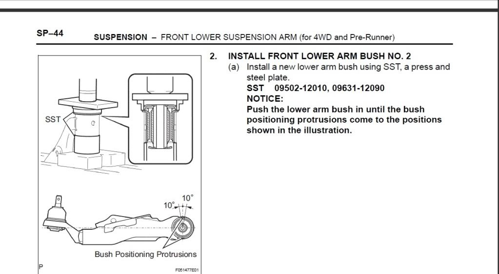

    I'm looking to probably do this soon and was reading up on the service manual.
    I'm trying to understand this; do these things need to be "clocked"? If so, how and why?

    I don't get it. Round bushing goes into round hole and your done. I don't see where it says it must be clocked. There is nothing to clock. Silly Toyota and there service bulletins. Sounds like bullshit to me

    I think the diagram improperly shows degrees when they really mean to imply depth.

    Upon closer examination, they do in fact have two nubs that require timing per the diagram.
    I don't appear to have bushing separation; but when I pick at the rubber with a fingernail it crumbles. Plus I have the "clack". :(

    I saw those nubs too late, they were already pressed in. I don't think it matters though. Mine aren't clocked like the diagram but I'm not worried about it.

    Doing some research; seems if it has timing marks, the construction and/or durometer of the material will be slightly different in the direction of said marks, to accommodate the direction of stress.

    Now I remember those cut outs. When I did mine Toyota was replacing the entire LCA. There was no service write up for the bushings or ball joints at least none I could find. Pretty sure I remember looking up LCA bushings and ball joints and the write up said "replace with new LCA" for both.
    X2... mine may be clocked right :D
    but only by chance if they are :laugh:
    I got an album worth of them monstrosities of poor engineering
    My LCA mount holes are
    every last one of them. :D
    Nope. Same material, but displaced. Screw the "index" tabs. Look at the rubber itself.
    Rear: The lateral play portion is solid and the vertical is hollow.
    Front: opposite of rear
