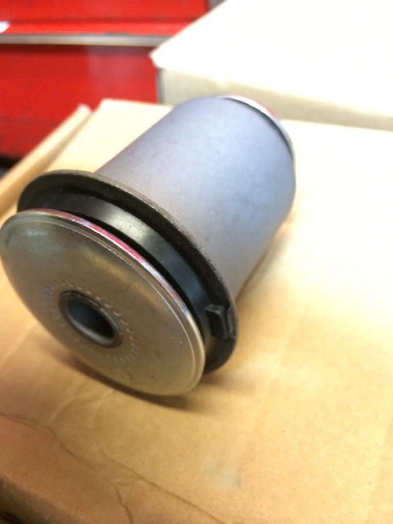

    new poly bushings arrived -- measurements:
    1.873
    1.897
    I will install & report back

    I believe Sandman has the OEM measurements. These poly bushings are already in the shell :)

    Here's what I measured

    I deduce they will fit better than Moog(fail) based on measurements and looks to be smooth transition rather than a "sharp" transition from forward to rear edge.
    Although that 0.007" is a little unnerving!
